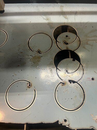

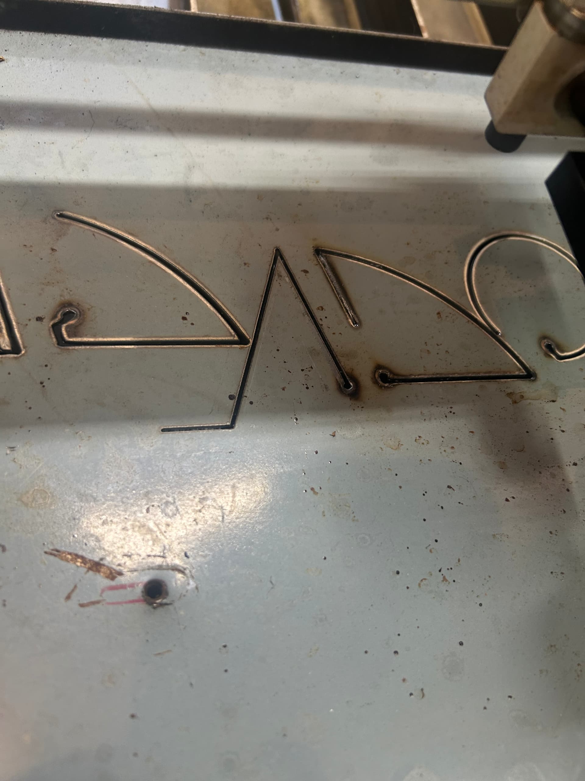

I am coming here asking for help to pick crossfire users brains. I have a crossfire pro since I’ve gotten it. I have only been able to run two full programs after that I get partial cuts. I’ve changed my pierce height my cutting height my pierced delay. I’ve contacted Langmuir about this. They have sent me out a new motion control board a new torch firing relay and now they’re talking about sending out a torch height, controller, and barrels Block electronic interference in cables. if anyone does have any ideas or possible solutions to try and troubleshoot it so I’m not just throwing apart after part please let me know.
We have fired the torch manually in fire control, and with a wire . Trying to to fire it without the THC . I am just trying to find answers to get up and running so I can get parts out to my customers. By the way, I’ve also used multiple types of steel and move my grounding clamp all over the place.

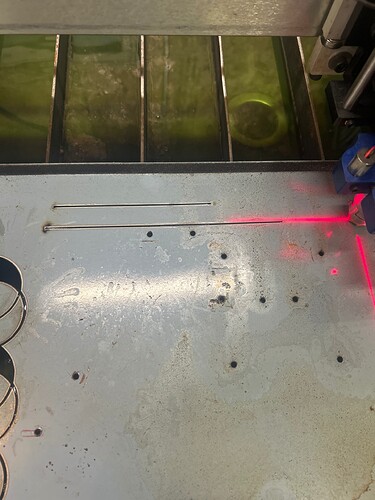

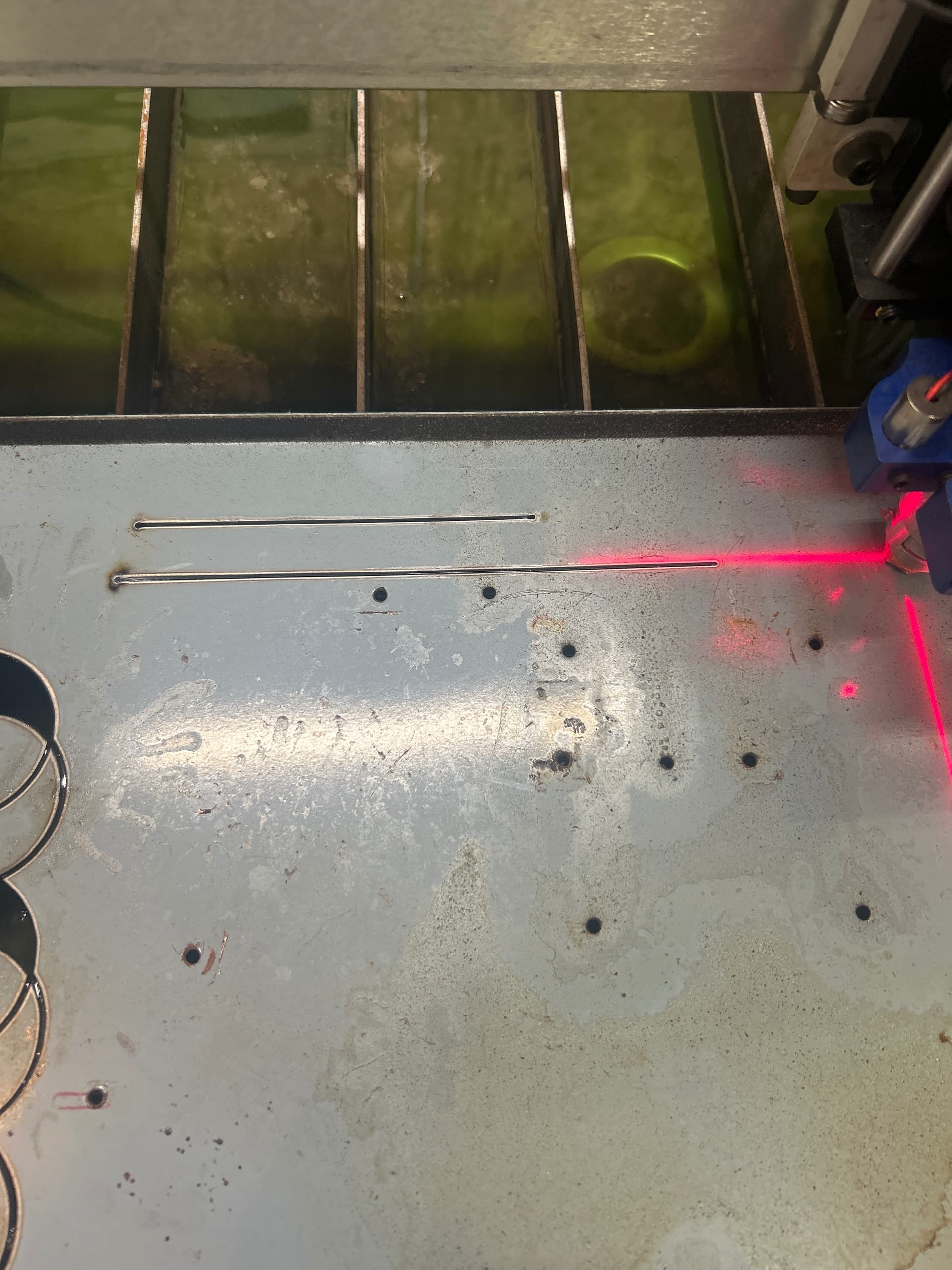

I did two straight line cuts one at 5 inches and one at 10. 5 inches was able to cut the whole program for the 10 inch I got 7 5/8

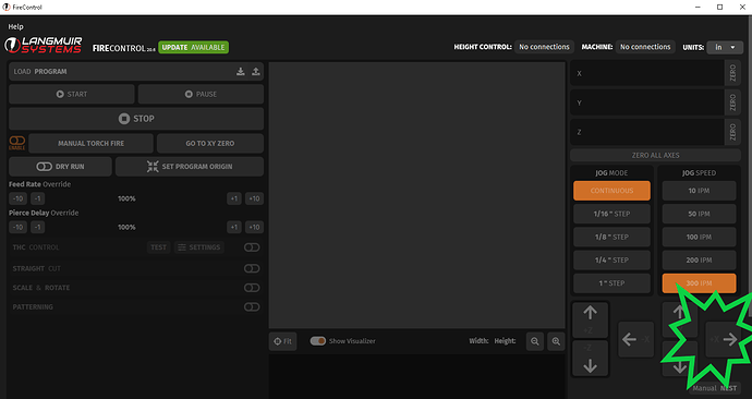

If you had somebody help you where you could manually travel the torch in fire control and have somebody short out the trigger for the torch. will the cut stay engaged as long as it’s being shorted out while manually traveling across the sheet? I think this might ultimately tell you whether it’s the plasma cutter or fire control ( table electronics).
Is fire control stopping the trigger or is the hypertherm stopping the trigger?
Here’s an example of jumping out the trigger circuit.

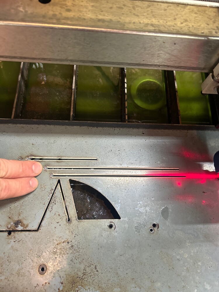

I did the test and it stopped firing 7” in

Have you tried yet to manually set the height and manually move the torch in fire control with the arrow keys while somebody else shorts out the trigger circuit? Just make sure you set the ipm with the jog speed to roughly the IPM you would use on whatever material thickness you’re testing on. Can you use a piece of 10 gauge to set your height before you start.
depending on the results of this test I’m sure it will let you know whether it’s the fire control electronics or the plasma cutter causing the issue.

I tried it twice and got about 7 “ (177.8mm) on each cut

Well the test kind of proves it has nothing to do with the Langmuir side of it.
If you’re shorting the cable to fire the plasma out nothing should turn it off besides the Hyperthem unit itself or removing the jumper shorting it.
