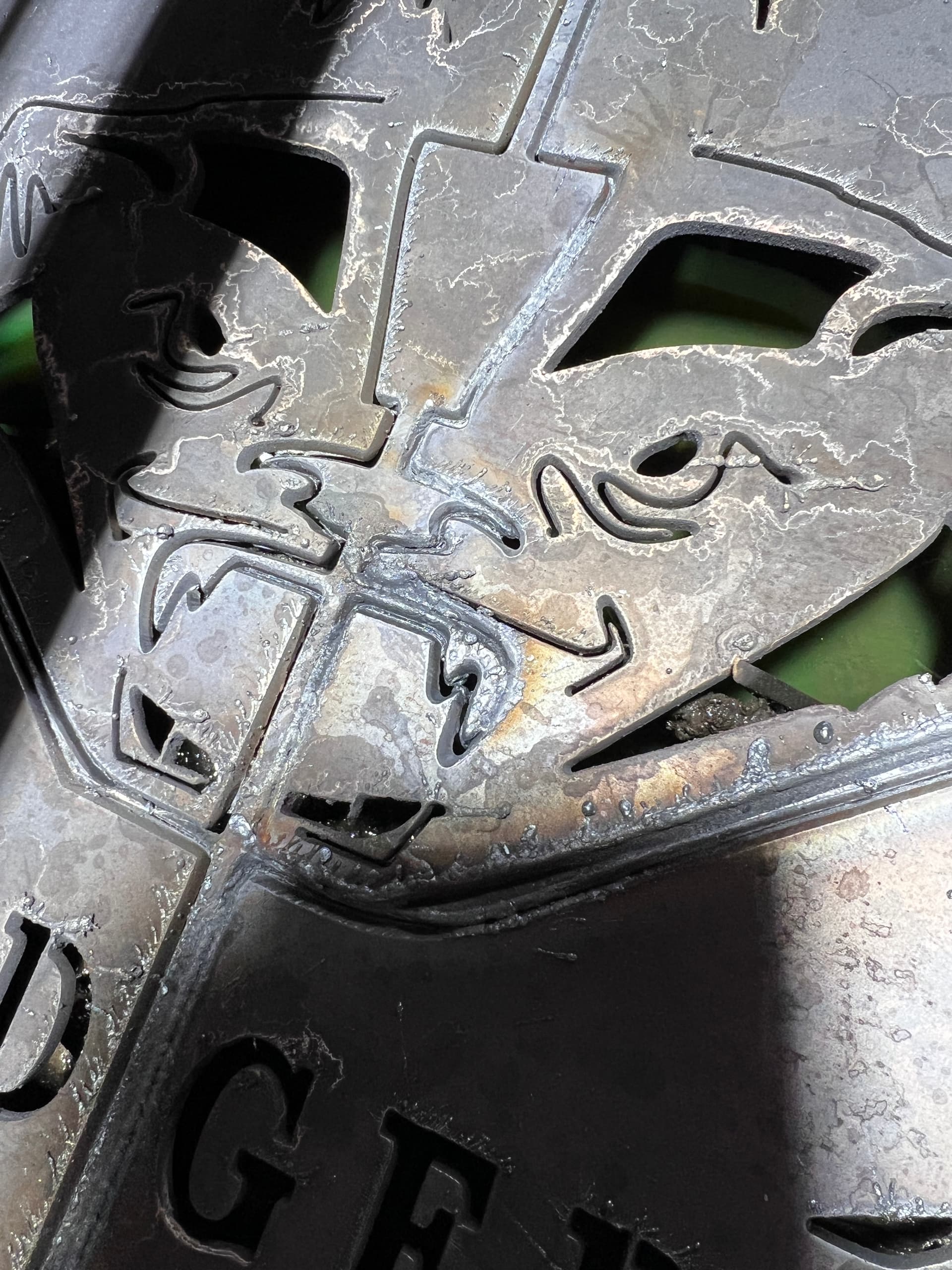

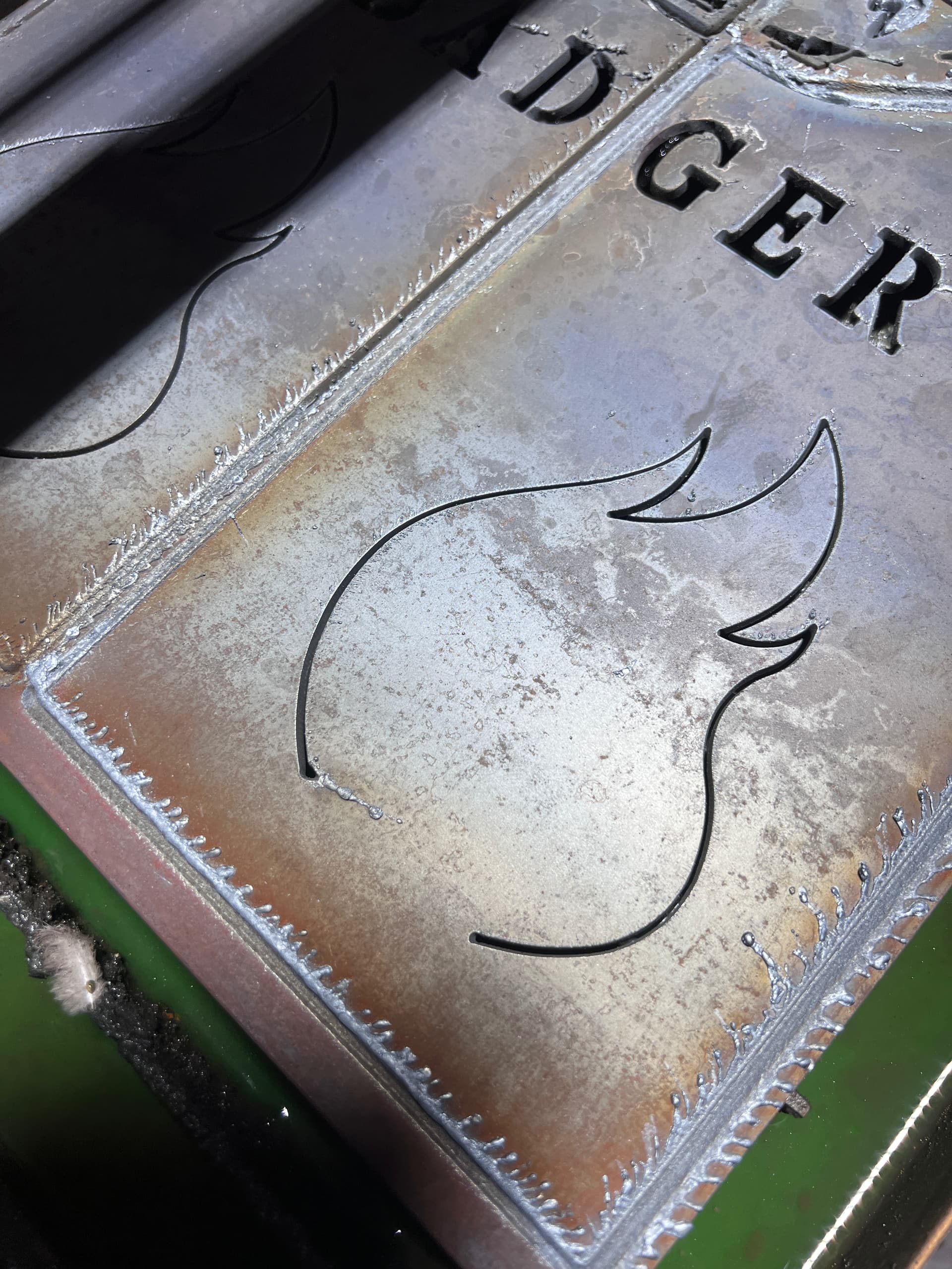

Lately i have been having more and more issues with torch height. Torch goes up when cutting but does not come down ooor it just goes up by itself loosing the cut. It tends to loose the cut towards the end.Ive cleaned the bronze contact the z axis has and nothing. I noticed it does not do this with 3/16 maybe cuase its flatter.

Hey @Phillipw Phillip! Sorry for the late response. Looks like my sheet metal are too warped giving me issues. The torch goes up when it needs to but does not come back down as the sheet starts to loose the warped piece.

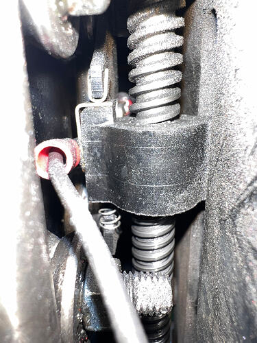

Have you cleaned and lubed the Z-axis? If I neglect that, the z will hang up on the way down.
Contact cleaner on the rails and bearing wheels, maybe some fine scotch-brite on the rails if they have build up. Light machine oil on the screw.
Yes i have contact cleaner and lube afterwards and still only goes up. @TC777

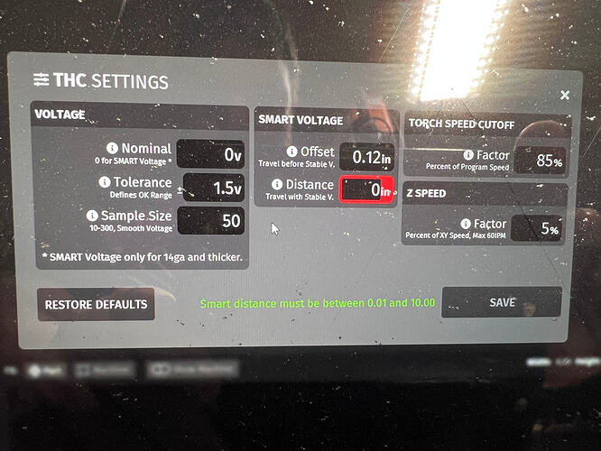

What would be a good voltage to enter since 0 for smart is not working?
Remind me in case I didn’t see what plasma are you using? What is the material thickness? If it’s a hypertherm the voltage is listed in the cut chart.
It’s possible that you are getting unexpected voltage out of the VIM module if SmartV isn’t working on some thicker materials. I should be able to help diagnose what may be happening if you send us in an email to support@langmuirsystems.com.
Voltage changes based on material thickness.
Why not resolve your THC before trying to band-aid things with nominal voltage - I expect nominal voltage would also not work since smartvoltage doesn’t.
