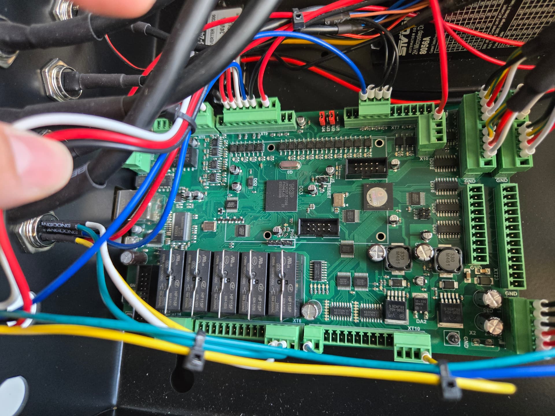

Went to go cut a PART FOR A CUSTOMER just like i would any other day. Turn the table on, plug in the usb cord to the laptop, open fireshare, open cut file and got no movement.
Already performed a dipshit check. Everything is plugged in and on…
Restart laptop. Nothing
Update laptop and drivers. Nothing
Shows movement in fire control. No physical movement from the table.
I get feedback from the led lights in the electronics box. But no movement.
Dont even hear a noise from the motors wanting to move.
Is it the power supply or what?

Pop the cove and check the voltage at the power supply. IIRC 36VDC

Does your FireControl screen show connection with green lights?
USB port of computer might have died or is faulty. Try a different port.
That is possible. This is how you would check (article explains checking and adjusting power supply):
If Firecontrol shows movement and the table doesn’t respond, 99% of the time it is a dead power supply. The stepper motors need 36v DC to work.
tested the power supply and shows only .34-.36 volts.
Measured voltage according to the Adjusting power supply voltage.pdf and it shows + or - 8 volts.
Yeah the software shows it is connected. Tested the voltage and it was only around 8 volts
You need a power supply, and not just any old one thst will go 36 volts. It’s a small enclosure.

This one will fit inside the enclosure. Make sure you pick 110v on the side. Unless you have it wired 240v from the wall. If you buy a larger one it won’t fit inside.. 36 vdc 10a 360 watts

I keep a spare one on the shelf. They may work for years or just days. They are cheap Chinese junk. You have no options. They are all made by the same Chinese company and rebranded under 100 names.
