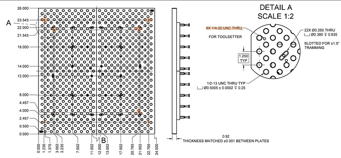

Full size Saunders fixture plate
I see 4 pairs of 1/4-20 holes on the drawing, no idea if the spacing is suitable for the LS toolsetter
They are in the upper left, close to 0,0. There is a circle showing where the toolsetter would go.
They are. I gave them the dimensions for the tool setter when I had this designed.

The new plate, Is it a single plate or 2? All i use is the SMW and working out really good.
oops. i see there are 2 plates on the full size
