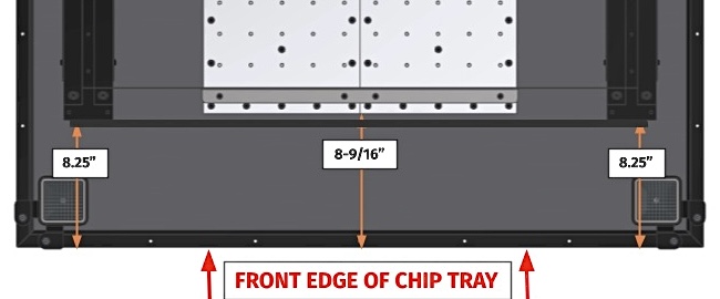

Full size Saunders fixture plate

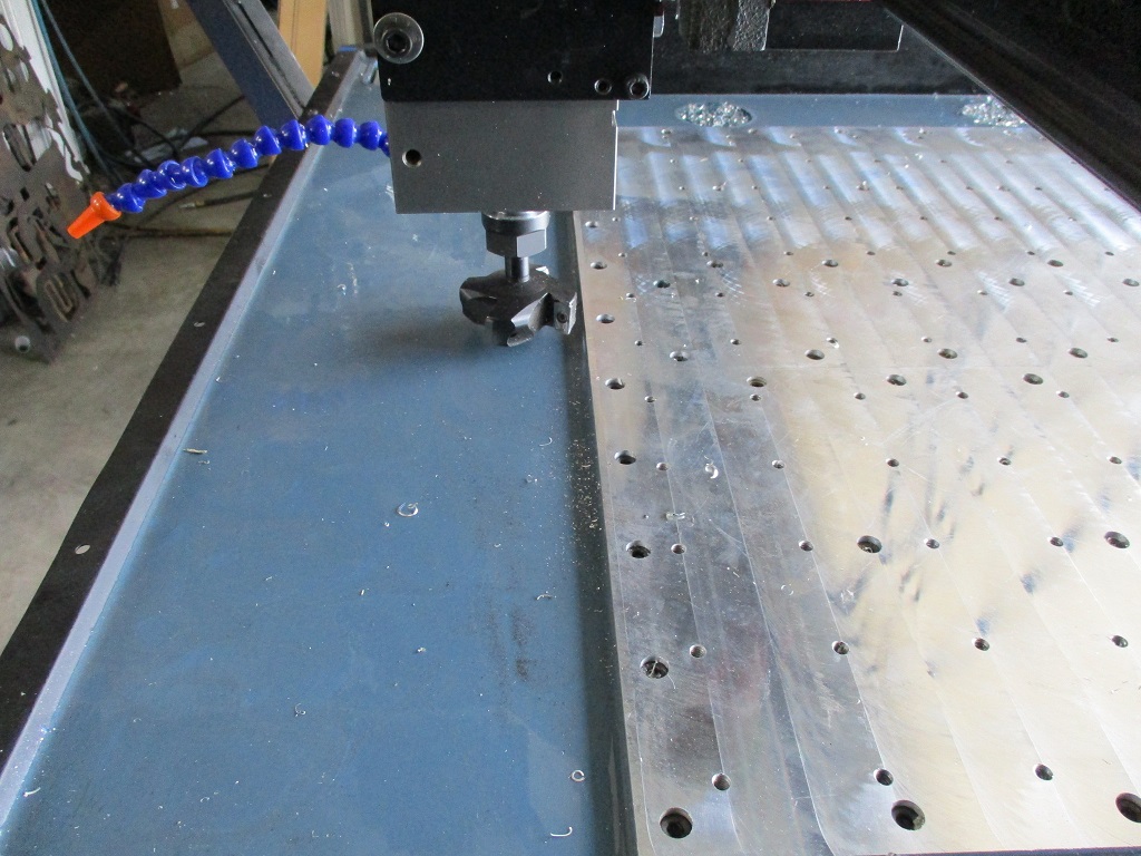

I have a 24 x 30 plate using the two Langmuir plates with a 4" spacer in the center and a 10" plate across the rear and I kept it centered between the Y-rails. I used the stock front of pan to baseplate dimension and with the 2" flycutter was able to surface about 1 1/4" of the rear plate.
What I noticed while flycutting was that using the stock front dimension for the baseplate left quite a bit of unused travel on the Y-axis. My plate could have been 2" inches further forward and I would have been able to surface it. When I flip my X-axis back around, I can take a picture of this available room at the front.

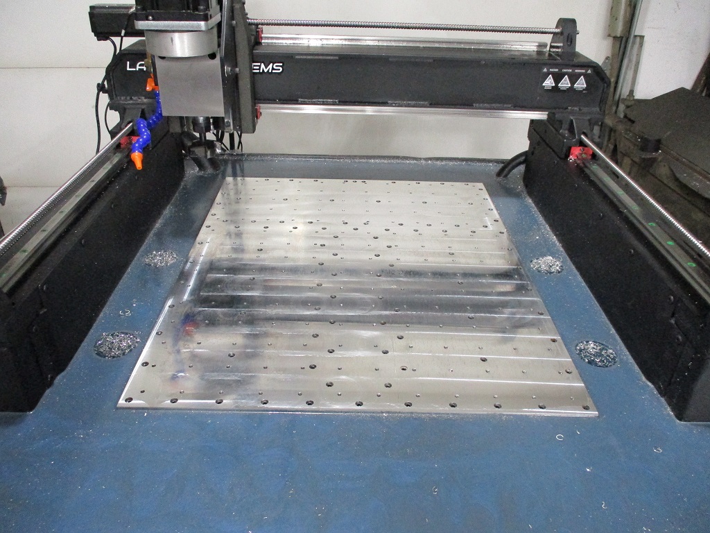

I also found that the baseplate could be a lot farther forward (or longer). I can’t really use the forward couple of inches of travel. I’m probably going to make a tool setter post that lives up there so that I’m losing functional workspace to the tool setter.

Here is my finished 24x30 baseplate. The 2.5" 4 insert flycutter hangs over the edge of the plate about 3/4" or so.
Here is a picture of the wasted space up front with a 2.5" facing tool for reference. The plate could have easily been 2" further forward. It would be a great spot for a cool changer base, but would require drilling the epoxy and concrete for more anchors.

I saw this post while working with my machine, so I measured my offsets. When Y is jogged all the way forward the spindle comes out 1-3/8" past the front of the bed. When Y is jogged all the way back my spindle is right on the tail end of the bed.
If I had shifted it about 5/8" forward of their instructions I would have had the bed roughly centered.
On the other hand, of all of my possible complaints about this machine this is near the bottom of the list. It’s overall a good machine and it has a huge X/Y size for it’s capabilities.
Gotta love these forums. Super helpful. Thanks to all.
Sbdon

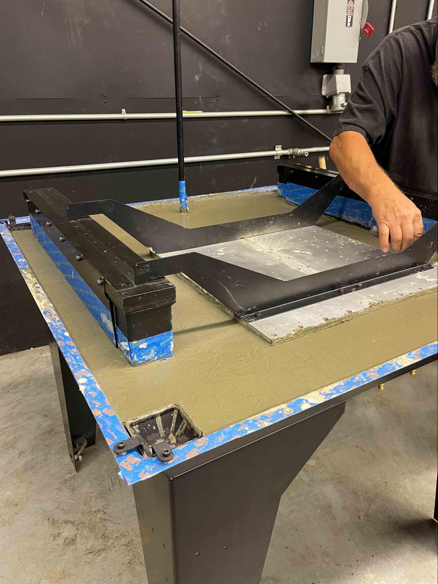

Heads up that the baseplate is purposefully not centered. It has to do with where the baseplate anchors are in relation to the front tie plate that’s embedded in the concrete. Centering the baseplate could compromise the strength of the concrete around the anchors.
Like what Daniel is saying. Moving only 5/8” forward, the anchor bolts will likely touch or push against the tie bar I’ve drawn in place.
But based on Fieroguru’s pic it could move 1-1/4” forward with the spindle center reaching the edge of the plate.
