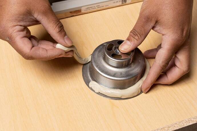

Plumbers putty, now that’s original Tin…
Seem like the appropriate choice in this situation.
And for any folks out there that don’t know about plumbers putty here is a great link explaining it.
How to Properly Use Plumber’s Putty | Oatey.
yes that would be awesome, thank you
I’d like to know why it isn’t sold in smaller containers. I never use more than one or two drain’s worth and then I have 80% of the container left. So I seal it up & save it for the next project. By the time that happens, the stuff is dried out because it never reseals as well as new and I need to buy a new container anyway.
I know this will happen but I can’t find it in me to just throw out the container after just one use. I have to let it age on the shelf until it’s no good and then throw it out. :man_shrugging:

The 14 oz can is the smallest they sell it in. They can almost get away with a 6 oz can or a 4 oz can though.

I buy the putty, use it right then and then just toss the rest. It never lasts here in Phoenix for very long in the heat and dry air. I get mine at Ace Hardware, they have smaller containers then the big box stores.
