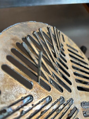

I had initially cut a simple cat outline to test the system in some aluminum tread plate I had in garage about a month ago.
Today I cut 14 GA steel using a file I created from scratch within Fusion 360. Most all of entry/ end points of cuts caused some problems with incomplete cuts. I was able to remove them and easily grind off the dross. I had the Razorweld X45 set at 42A and 140ipm.
Those incomplete cuts are obvious:
And a macro shot:
Most of the cutting was clean:
The slots were a problem, but this also happened on the large circle cut at the entry/ endpoint:
Here is a Fusion screenshot. Those entry cuts look odd. I think I selected a wrong setting.

The finished product is here and should work ok. This is placed on the end of a telescope to focus the stars - called a Bahtinov Mask. It’s used for just a couple minutes to focus then set aside. For reference, it is ~ 11 inches in diameter:
Finally, I noticed each time the torch shuts down between piercings, there is a lot of air that continues to exhaust. It seems something is wrong. Should air completely stop when the torch shutdown?

For the incomplete cuts, do you have any overlap distance set in Fusion Toolpath? If not, you might try adding a tiny amount. It’s on the “Passes” tab (4th tab) when setting up Toolpath parameters.
I will check Fusion. Thanks for the pointer. This will help me find the setting.
This could help clean up “nubs” left on a lead-in and lead-out but would be a band-aid to fixing an incomplete cut.
A pattern should always fall out if it’s a closed loop without the use a finishing overlap.
