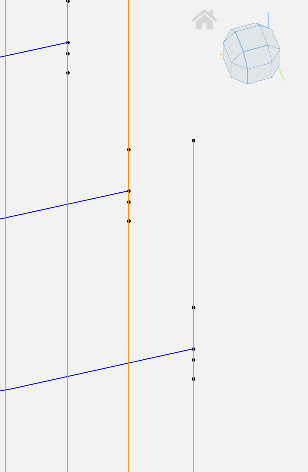

Good morning Tim, Running into an issue I’m stuck on. In the photos, there are irregulars as the torch starts off. Ive changed in my cuts the Pierse to 0 but I still get this. Any help?
jrmyers
February 24, 2022, 7:35pm
63
It looks like you might have some coupler slip or maybe some kind of binding happening.
Mark those couplers with a marker with a line from the shaft to the coupler and then run the break in program a few times see if they’re still aligned by the time you’re done.

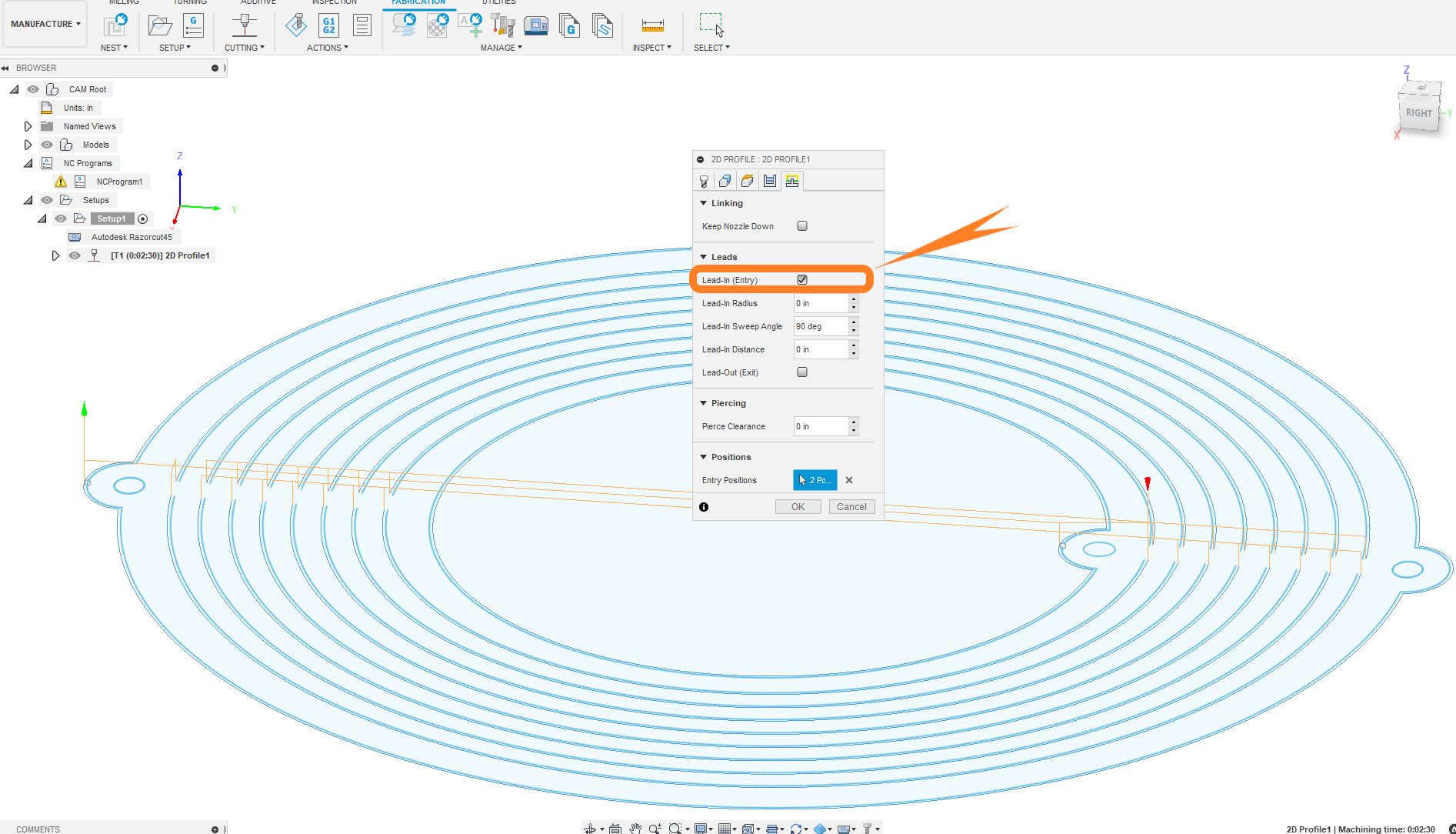

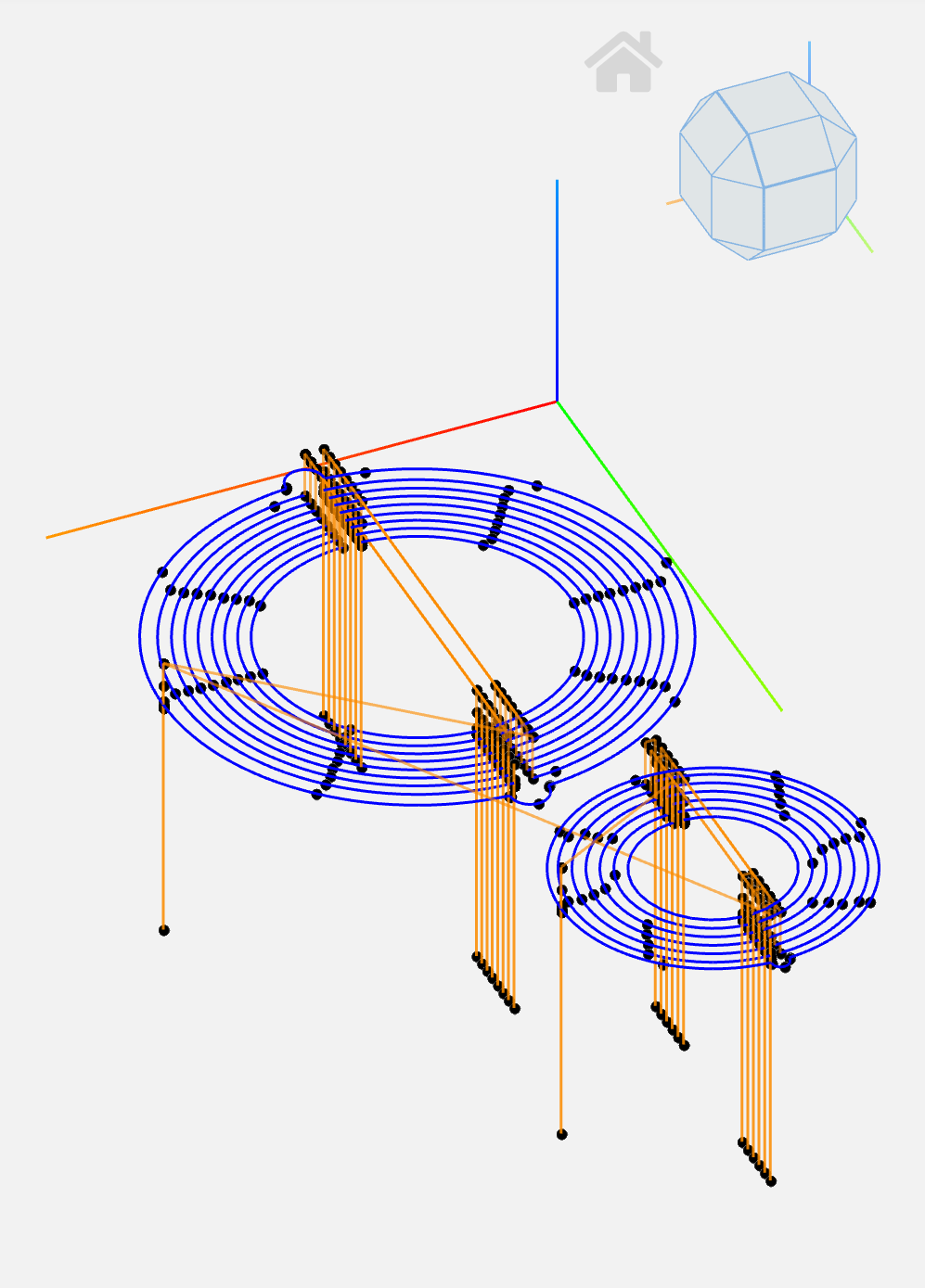

So at the end when the design is cut out, I get a little notch on the out side edge from the pierce. Is there away to alleviate that? I have my pierce set for 0 in the setup so the rings are all the same.
Pierce clearance to zero as well.
It’s the bottom of the last tab on the 2D profile menu.

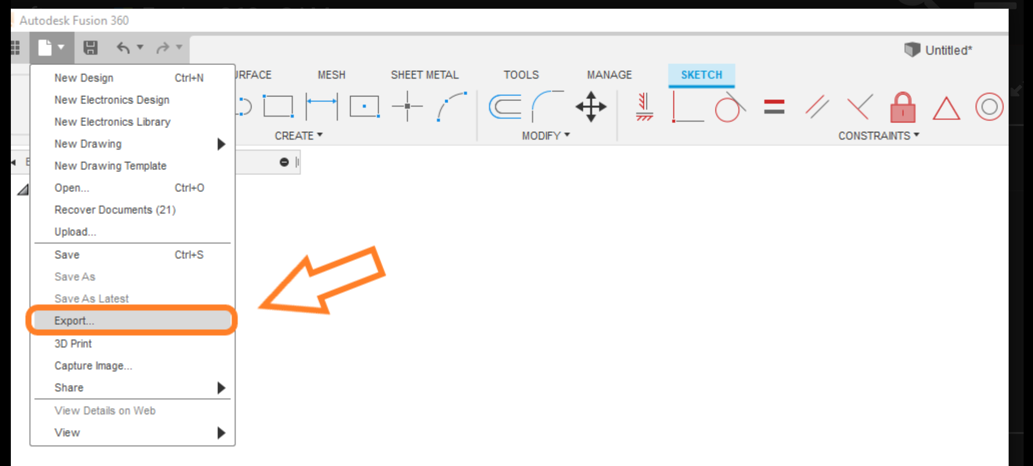

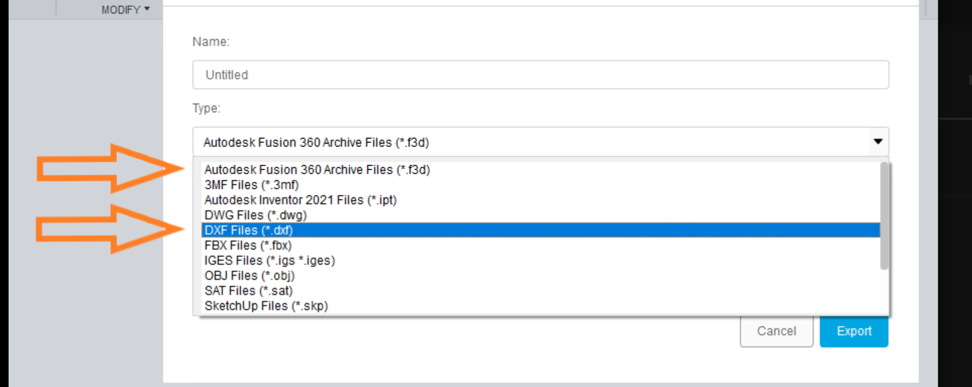

If you want to post your f3d file I can look through your fusion flow.
jrmyers
February 27, 2022, 8:50pm
70
See if you could post your f3d file it’ll have all the information included in your fusion 360 design

Im going to move the pierce on the outside cut out to the tip of one of the outer loops. that will allow for an easier grind down to get ride of it.
that file is not cutting out the holes?
you could uncheck lead-in entry but I see you did set it all to zero so it wont really make a difference.
since the first pierce delay is a little bit longer on fine piece I like to draw a line or circle to cut first then more to the finished work pierce
