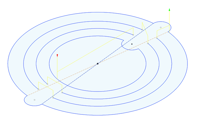

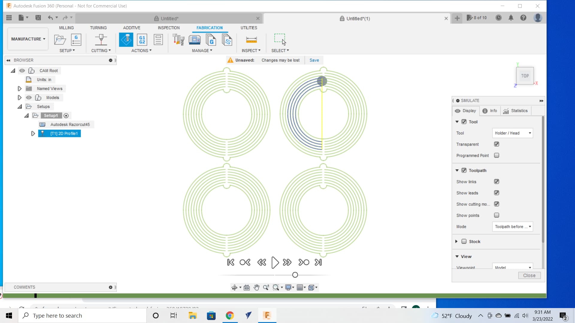

Good Morning. I have a question about Fusion 360 in the manufacture cutting section. Im wanting to cut wind spinners and in doing so the thin metal im using warps during the cuts. The gcode likes to cut the lines in half moons. I would like them to cut as full circle. I did click the Preserve Order, but always the same result. Is there a different way to control this?
spiner test v1.f3d (116.0 KB)

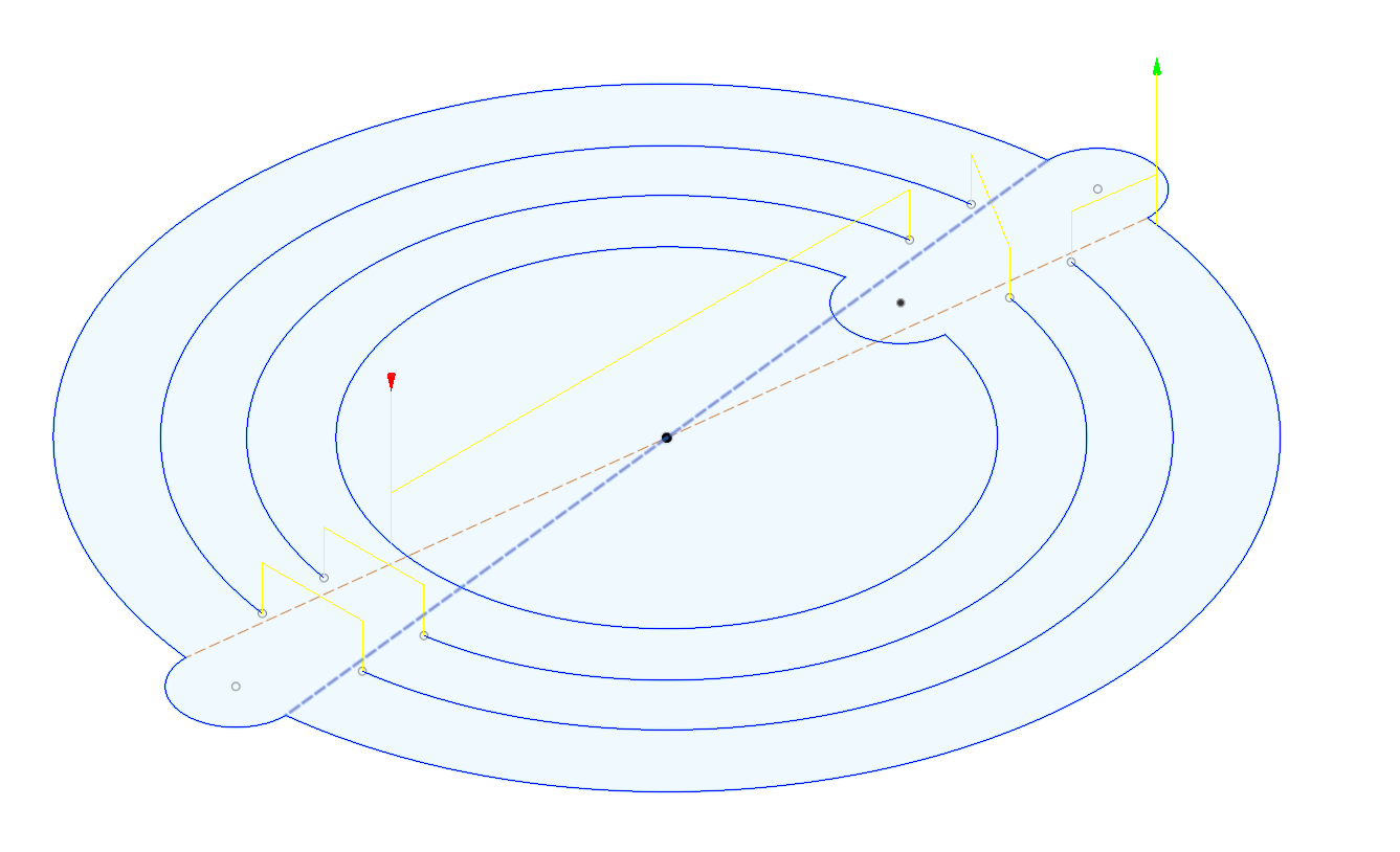

using “preserve order” works prefect on this quick test I made. Can you post your *.F3D and maybe I can pin point the error.
Are working off a unlocked SVG imported into the sketch environment?
