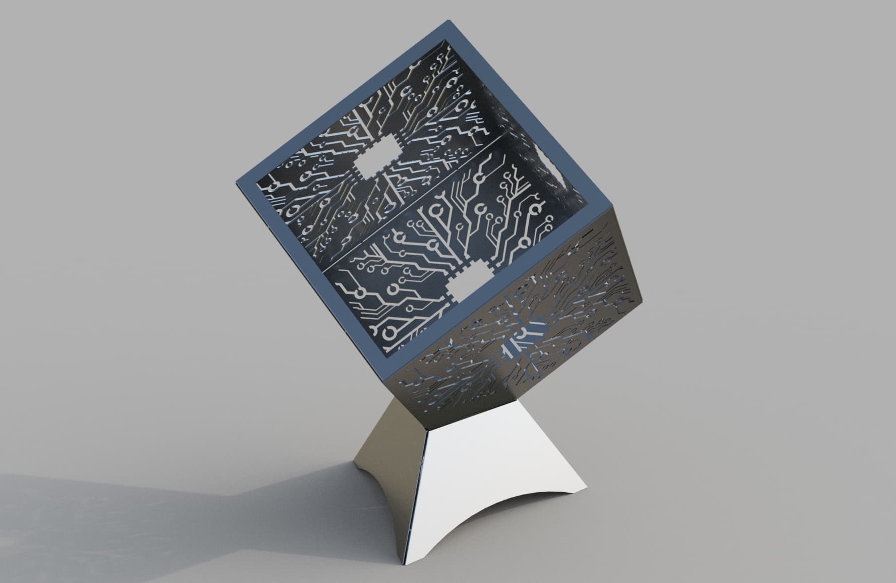

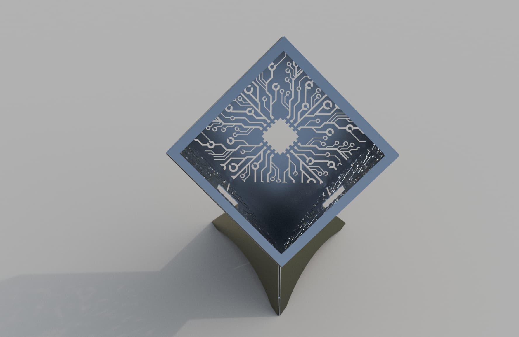

Here is the bigger version 23.25 x 23.25. very close to the original design size. 4 pcs (instead of 12 in the og) to be bend and formed into the cube and 3-sided pyramid (tetrahedron)
To be made of 1/8"
4 pcs each one takes most of a 32 x 48 sheet

3d circut board firepit larger v6 (1)

I am guessing you don’t bend that by beating it with a hammer over the edge of the workbench?!
No , you could likely bend it by hand. Each fold has two very small 3/16 tabs on the bend line.
At least then it’s accessible to fabricate for those who don’t have a brake.

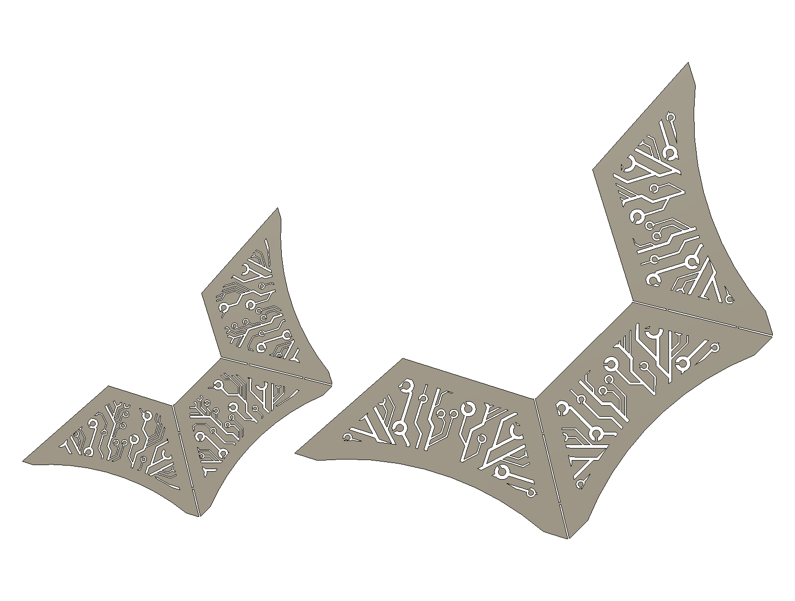

Well I cant leave well enough alone, I could not stop thinking about this modification the circuit board cube fireplace.
Now here it is. Added patterns to both the small and large cube stands.
Enjoy.
firepit size comparsion v3
![3d circut board firepit larger v11|584x460]
15 5 BASE CIRCUT CUBE FIREPIT.dxf (101.8 KB)
32 25 BASE CIRCUT CUBE FIREPIT.dxf (114.4 KB)
This has never been cut or tested for real so downloader beware.

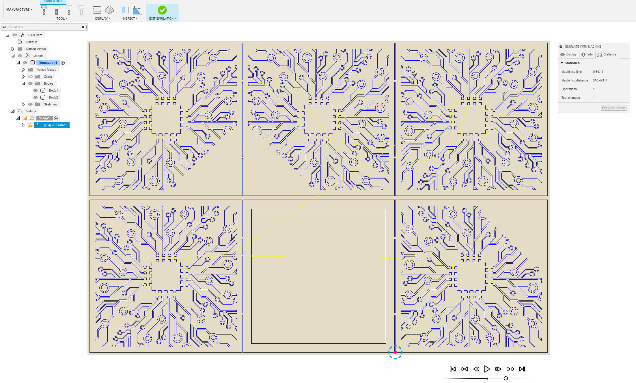

I did make tool paths for the 16 inch cube with Fusion 360 and it seem to work out all right
What should the scaling be when you import it
It was exported as an imperial file. (Inches)
But I think dxfs are unitless by nature.
This file has HUGE pucker factor, I estimate this sheet of the 16" cube would take 50 minutes to cut @ 72 IPM 316’ of cutting.
You better be ready for a long go.
Not in Sheetcam. You have to select metric, inches or custom for scaling. He needs to select inches when he imports the DXF file.
