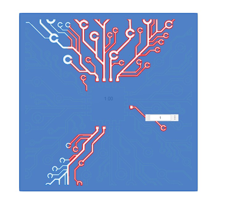

Did you download the zip file I uploaded? That has 5 different SVG files in it. One file for each unique part.
the one from 9hrs ago? i see there is an update about 4hrs ago.

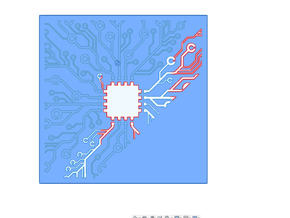

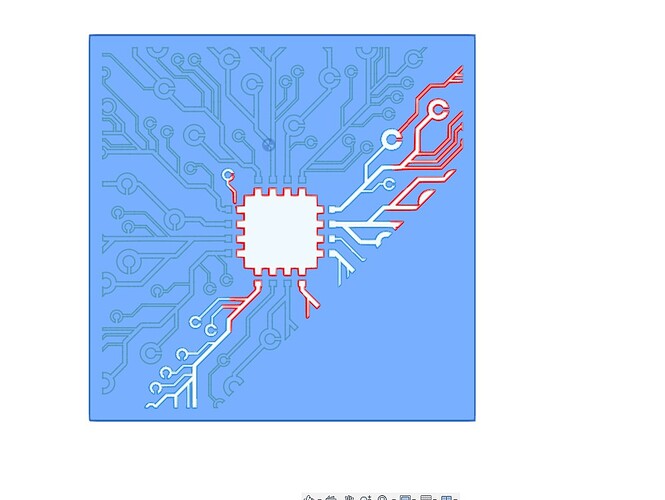

this is what they look like in fusion from 9hr ago SVG file. only some of it will extrude.
Yeah. The ones from 9h ago. There must be something odd about that original file that has the contours on different planes.
Inkscape shows it as a single layer and Sheetcam doesn’t have any issues with it.
can you create dxf to try from sheetcam?
I can’t export DXF from Sheetcam. I saved one of the files as r14 DXF in Inkscape. I tried r12 DXF, but the scaling was way off. Try this file.

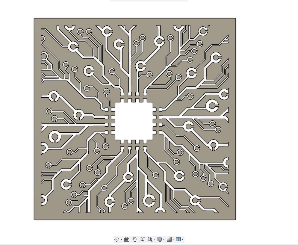

Well I couldn’t handle Fusion coming up short.
I recreated this Firepit to be a 16" cube (15.5)
It is 3 pcs (down from 12 pcs ) the can to easily folded before welding.
16 inch circut board firepit cube stand.dxf (11.0 KB)
16 inch circut board firepit cube.dxf (697.6 KB)
Click this Link for a Viewable 3d model :arrow_up:
Made for 1/8" materials.
The cube fits on 1 32x48 sheet
The stand fit on part of 32x48 sheet
Warning I have not cut one out yet so there maybe errors.
I could do a larger size closer to the original the would be 4 pcs and still cutable on the cross fire pro if anyone is interested.
3d circut board firepit v4
This has never been cut or tested for real so downloader beware.
