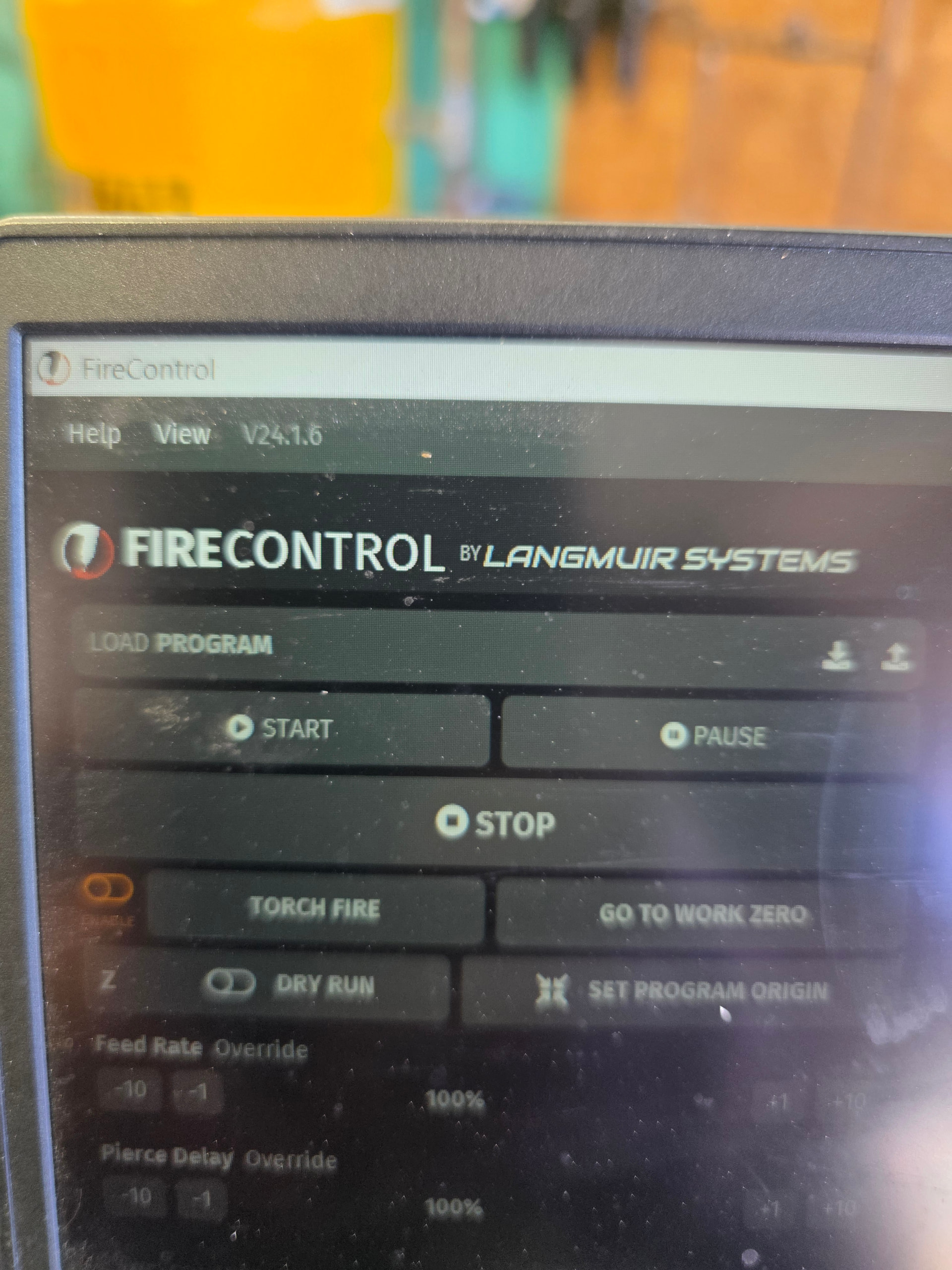

I am having a similar issue with my 4 year old went to cut everything was normal. Plasma cutter moved to its mark and I got the message your machine disconnected. I have the new message your crossfire device is recognized but fire control can not connect. Did some trouble shooting flashed the software. I installed fire control on another laptop same error message. Googled the problem which brought me here, changed the USB to printer cord and still have the same issue. Is there a video of removing and isolating the MCB to test out to see if it’s bad or not. If so I’d like to see about getting a MCB also. Thanks

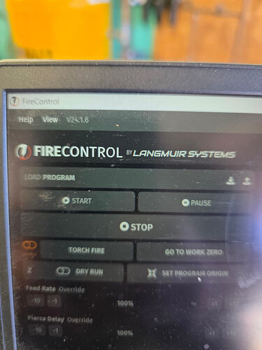

Ok I recorded it but need to edit a video together. Unfortunately for me, pulling the board out and connecting it did not remedy the situation. I tried my wife’s laptop and also a new printer cable that’s known good. My board was still lighting the led and showed on fire control that the connection drop down went from “no connection” to connected and allowed the drop down to show “crossfire”. But when you click on that nothing more happens. The screen doesn’t stop being greyed out as normal. Also I looked over the board as good as I could and can’t find any obvious damage or burnt components/broken solder joints etc

This is my MCB is lite up with no external power the USB turns green and and there is blinking lights on the thc.
No external power? Plugged into the wall or USB only? Turn the flash off your phone. Hard to make sense of the picture.
There is no flash the sun was reflecting it’s only plugged into the laptop.

The thc is showing in the Com section and the table can not be connected it’s saying that it recognizes but can connect.
Have you tried a different USB port? So the control board is recognized, but won’t let you control anything?
