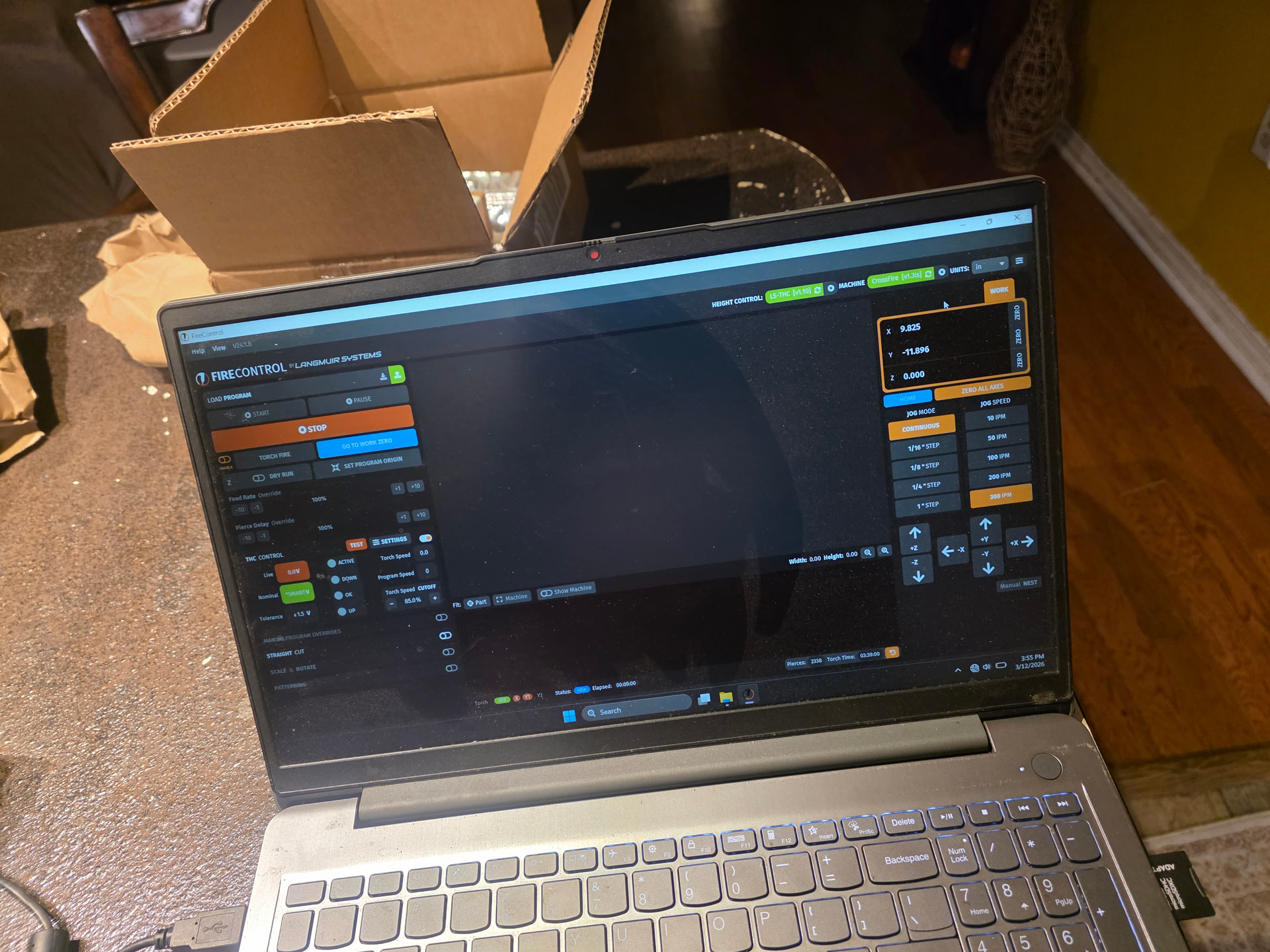

Just to close out this thread, the new board arrived today. I plugged it directly into my laptop and it connected and lit up fire control as expected. Boom done.
