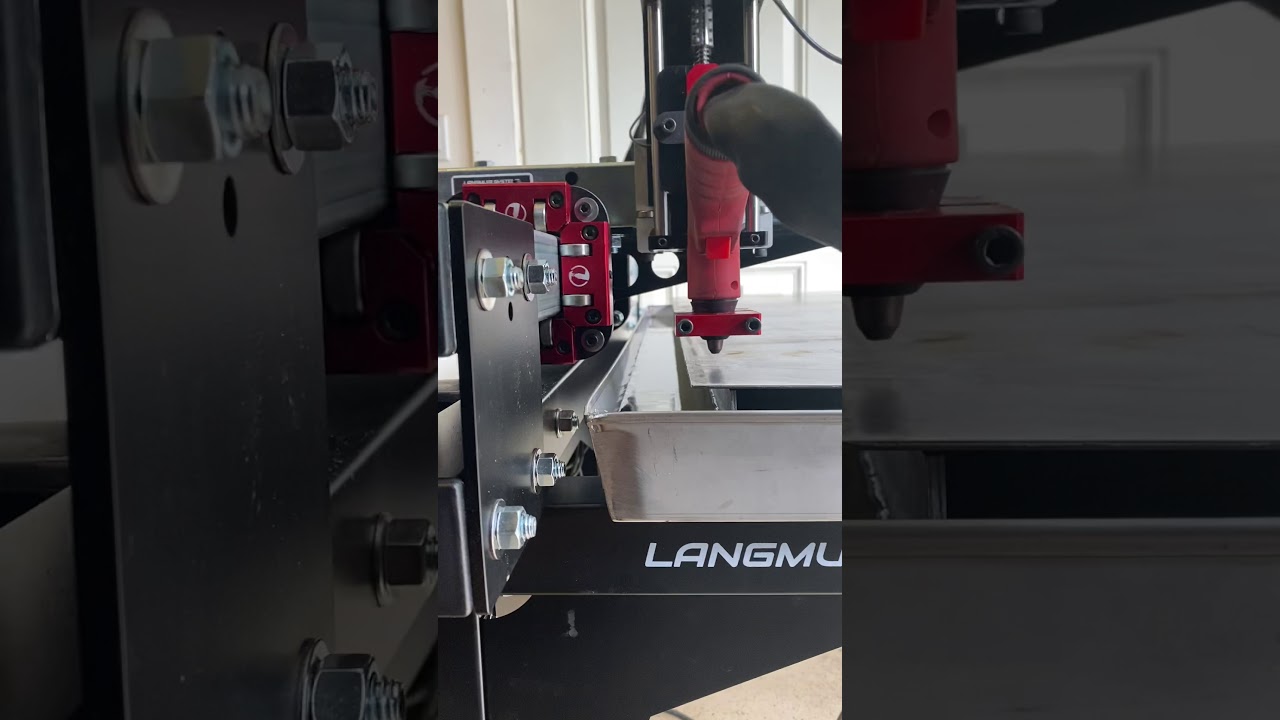

Looking for some feedback. I have been having some issues with not making full cuts. I am cutting 16 gauge metal at 35 amps 210 IPM. Should I slow down my rate of travel? Increase my amperage? Not sure the IHS is working correctly or of the THC is functioning as it should either. My THC is giving me a small reading when I am not executing a program. It didn’t do this yesterday.
See video of machine actually cutting here

1st issue:
When making first cut the torch does not always touch the metal first and the torch height is not right at all. Stop and restart and it works.

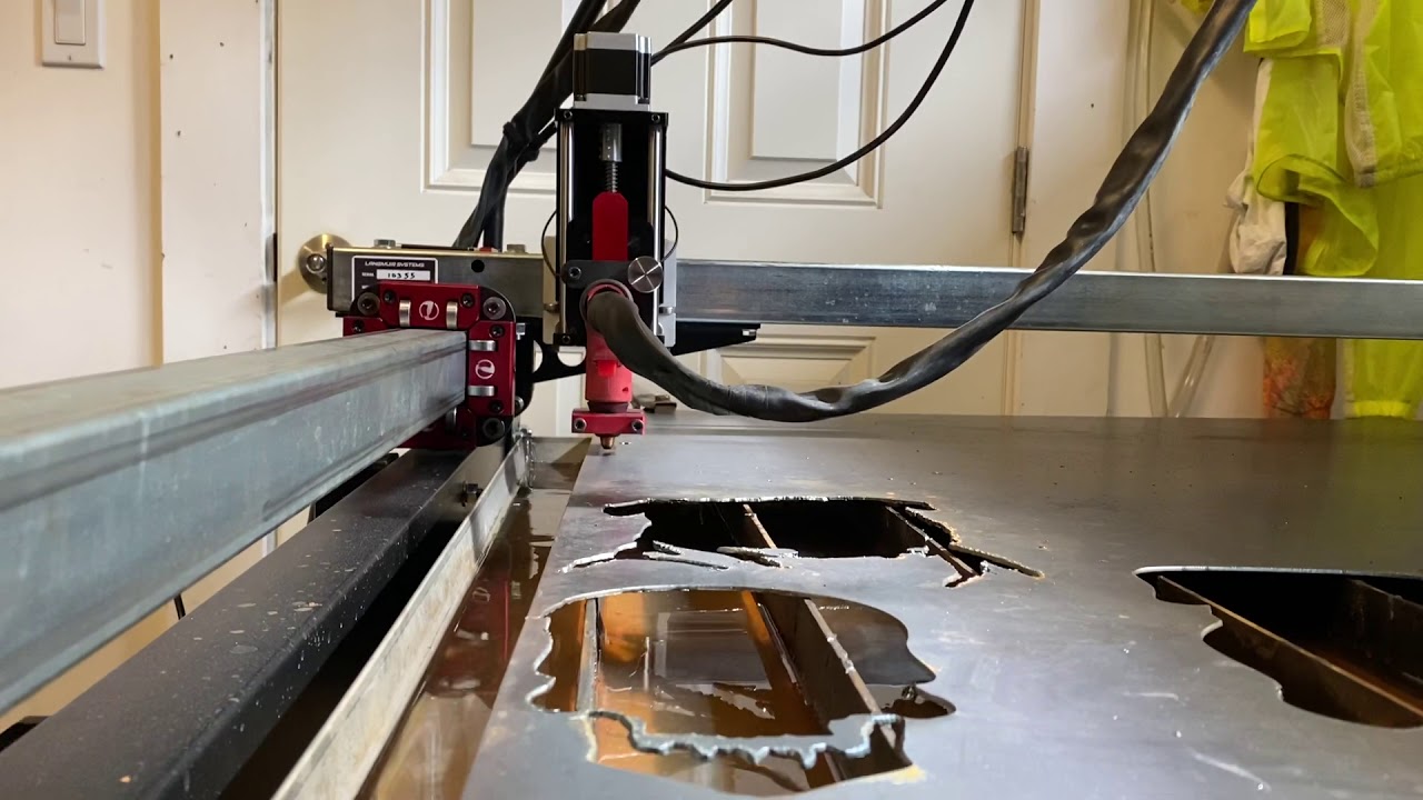

2nd issue:
Torch started rising and just kept slowly rising during the cut. Due to this I have a spot that didn’t get cut all the way. Picture of are where torch raised below.
How can I fix these two issues?

Attached is a picture of the most recent cut using the update THC version of 1.09. I also attached a video but it is kind of hard to see the torch rising but it is significant.
Your nozzle ran off the end of your workpiece. That would definitely cause some issues. Also your cutter doesnt seem to be starting an arc correctly. Looks like it tries to start 2 times then starts on the third. My Razorweld starts on the first. On the razorweld there is a 2T 4T button, is there one on your cutter? Should be on 2t
There is definitely something weird going on here with your plasma cutter. That arcing before cuts is not something we’ve seen before.

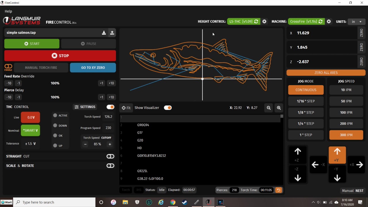

What voltages are you seeing in FireControl?

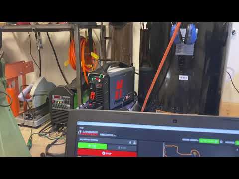

Okay so now I have a brand new hypertherm 45xp, an 80 gallon compressor rated at 14 CFM at 90 PSI and dry air going through a desiccant and oil filter. I have new consumables. My THC is hooked up using the wiring kit from Langmuir.
I dont think my THC is the issue i think it is me but i am not certain since i am so new to this.

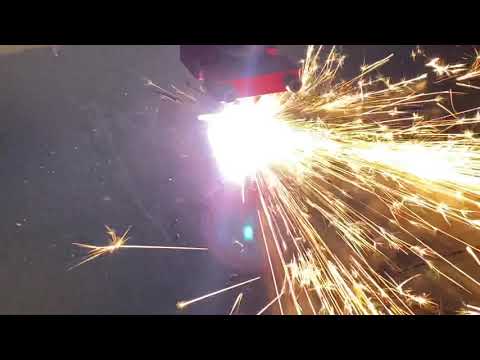

Problem that I consistently have (ONLY when the THC is on) is that the torch will be fine working on a cut as expected and the THC will raise the torch through the roof if it had its way. This random torch climbing has cost me a few large peice. I can make the same cuts NO PROBLEM on same files with no THC and works great.
Now i do know if paths get to close and the arc goes off the metal a little it can cuase issues like this. Or if the lead ins are too short ect. My torch raised up on the last peice on a straigt cut with no other cuts near by, no edges near by and it was a long straigt cut and during the middle of it the torch just randomly raised. I give up on the THC for know until someome can tell me what i am doing wrong or Langmuir makes some updates to the software.
See the vide and still shot.
1:30 on the video is when the torch climbs and you can see the type of line i am cutting

What are the torch volts readings when the torch is raising and what are the ‘traffic lights’ doing while raising. Once we have that info we’ll be able to see what the issue is. It would helpful if you could record your computer screen during.
I will start doing screen captures during my cuts and turn the THC back on. Really dont want to waste any more metal but i need to figure this out. Once i get another issue and capture on screen, i will update the forum with that video and take pictures of the part this go. thanks

Okay got a screen shot of fire control in action, picture of the metal where issue happened and video of me cutting image
16 gauge
Video - Start at 13 sec and you can see the issue happen around 17 second. One cut soon after has same issue
Gcode
simple salmon.tap (37.0 KB)
Screen shot fire control
You need to add more time to your pierce delay. Some of your issues are from the torch moving after the IHS before the torch has time to pierce the part. Looking at your firecontrol video, I see a pierce delay of 0.4 seconds. I’m not sure what the material thickness is that your cutting but for reference, with my powermax 45xp I’ve had to add as much as .5 second to the book settings. I usually cut 14ga with around .7 for a pierce delay and I have also added a .5 second pause at the end of each cut.
I agree. Its not piercing long enough
