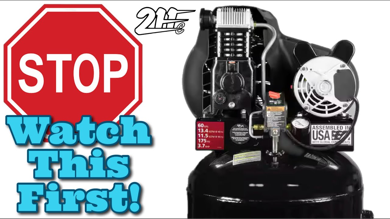

Well, I told @ChelanJim that I wasn’t going to record a video about the compressor, but the weekend was over and I didn’t have anything to upload, so guess what!?
I wanted to thank everybody who gave recommendations on compressors. I ended up going with the Husky, which I got for $860 delivered after all taxes, thanks to a 10% off coupon. And with 12 months financing at 0%, it’s only going to cost me about $70/mo. I don’t normally do credit cards, but with the pay cut I took this year, I’m going to use this one to my advantage.
Initial impressions of the compressor are mixed. I assumed that “Assembled in the USA with Global Components” meant that every piece of this thing was made in China, but the tank actually says that it was made in the USA. That said, the 175psi rating seems…excessive. In all honesty, the compressor pump struggles with that last 25psi WAY more than it should (and it actually cuts out at 180psig). I worry that this will lead to a shortened lifespan and only a marginal benefit. I could of course turn the pressure switch down, but the adjustment screws are coated in glue to keep users from tampering, so…is it worth voiding the warranty to make the compressor “maaaaybe” live a bit longer? That’s a tough decision.

I think I would turn it down regardless unless you need that much pressure to try and make up for not having enough volume. They spin those poor pumps so fast I think its really hard on them.
Most compressors struggle to make air much above 140-150 psi.
I hear you, but voiding the warranty to try and make it live is…well, I guess it’s a sign of the times, isn’t it. :joy:

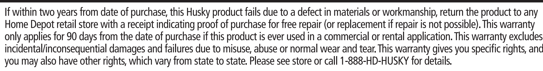

It doesn’t but the glue is usually a sign that they’re looking for tampering to void a warranty. But I guess there’s nothing keeping me from replacing the glue…
I would imagine they’d have more of an issue with you rewiring the pressure switch then adjusting it.
This is what their actual warranty policy says.
You have nothing to worry about. We’ve got your back!!!:face_with_hand_over_mouth:
The glue might be put on there too to keep the screws from moving from vibration
