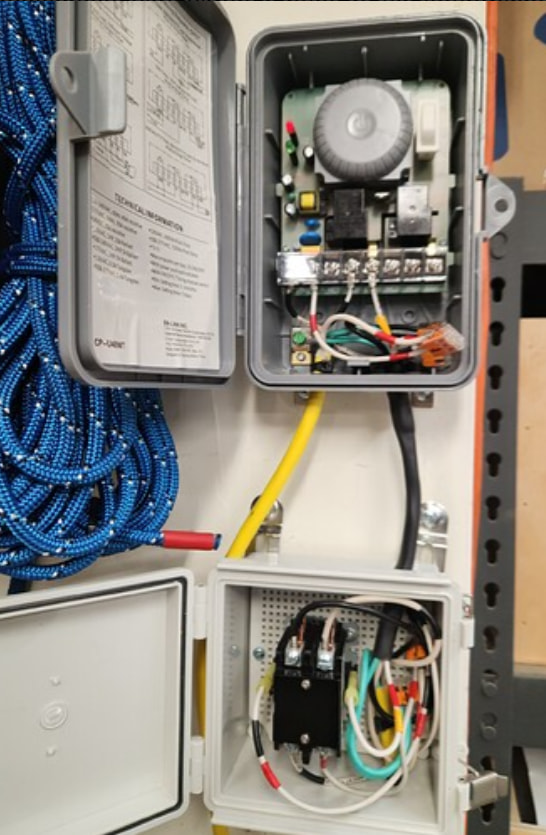

Not that I know any of this but Tin helped me wire my wireless timer to my compressor. The whole secret is a little device called a “contactor.” I never heard of them before.
https://a.co/d/06A4e5W9

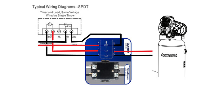

You can put the switch in place of timer. The contactor directs or allows the current only when it senses the contact of the pressure switch which gives a small current of 110V to operate the magnet switch of the contactor. The contactor then carries all of the current.

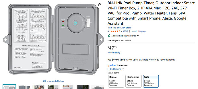

Edit: This was the timer I installed. It lacked the ability to handle the load caused by my compressor.
https://a.co/d/02P8pwUr

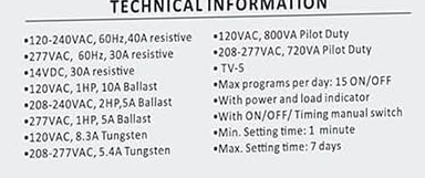

The specs on the timer says this:

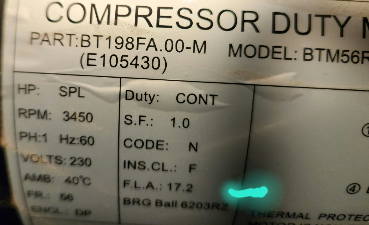

But the label on the compressor shows F.L.A. of 17 amps.
So I would have surely burned out that timer.

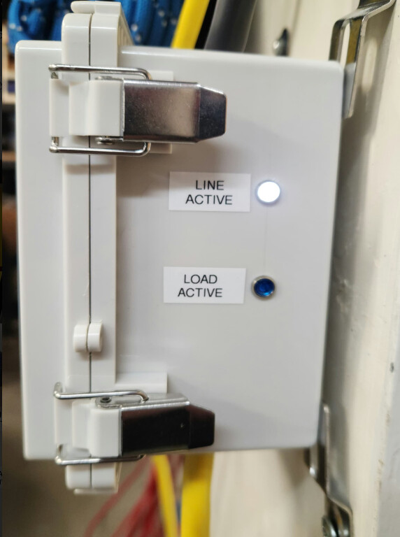

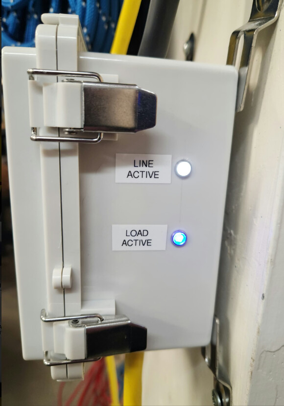

Here is the final installation:
Edit: One final comment. In my situation, I still have the amperage going thru the original pressure switch. To protect the pressure switch, I would wire it so the pressure switch would connect/send the live voltage wire to the contactor and the load wires would then go to the motor. My “load” goes to the original compressor line.

I went a little old School and split the control circuit to the contactor coil and wired in a light switch so I can turn it off without flipping the main breaker.

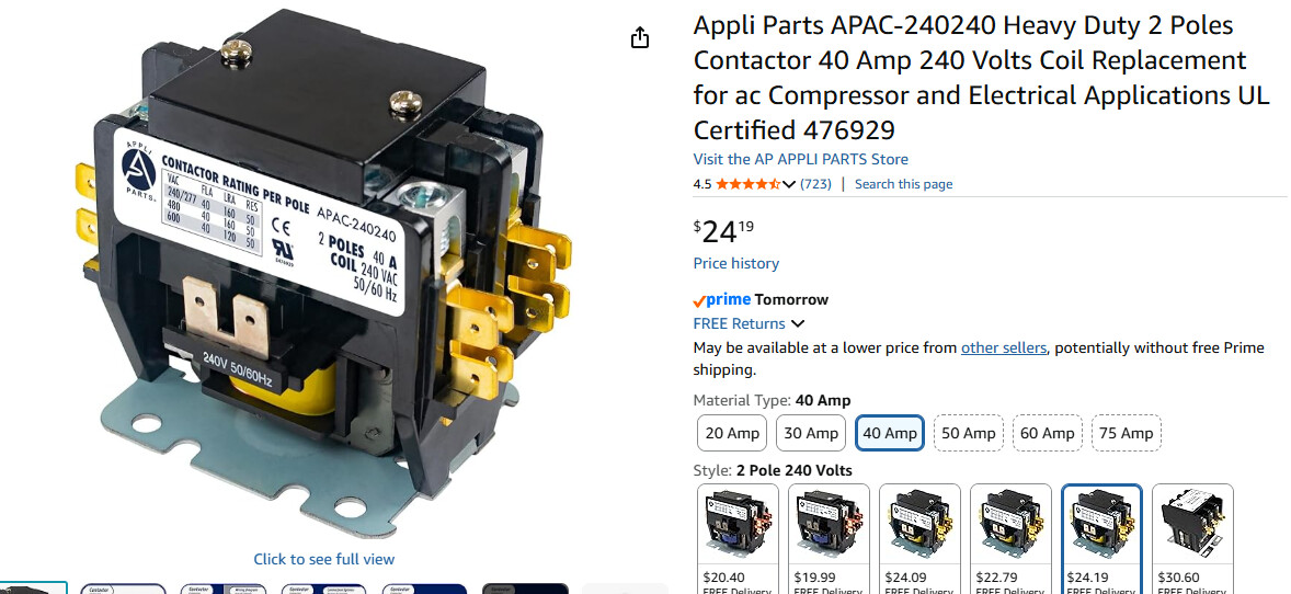

Ok, I see. Is there any value in over speccing
Is there any value in over-speccing the contactor? I see the ones @ChelanJim listed are all within about $2 of each other whether you go 40A, 30A, or 20A.
You will need to put a contactor or well I guess the tech term is a start box that is rated to carry the motor load.
Mine I had to replace the coil once because of a failure. Then a year ago I some how has water fried it again ( water leak). So I couldn’t find a coil so I actually have a 50 amp 3 phase contactor that has a single phase coil in it. It was cheapest replacement to get it fixed fast.
To answer your question though I don’t think there is a need to overkill it but up sizing probably won’t be a issue.

It is not the same as the amperage of breakers in which a larger breaker would defeat the purpose of the breaker being sized for the safe load limit. The contactor is sized so you won’t burn it up with the amount of amperage you expect to go thru it.
Perhaps the larger contactors that are priced a bit cheaper just indicates there is more volume of sales for the larger ones.
