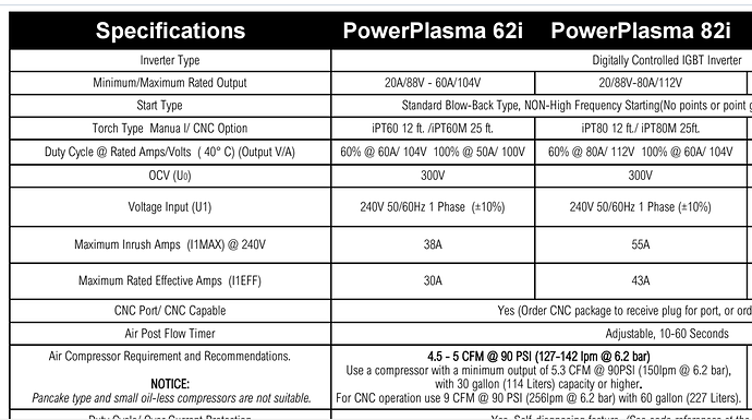

What air compressor you choose is way less about the table you’re running and way more about the plasma cutter you’re running.
You went to a hypertherm 45 XP?
I would go for a 9 CFM minimum.
So it Has less on time
Personally I have a hypotherm 45 XP and a 85 PowerMax so I went with a 18 CFM

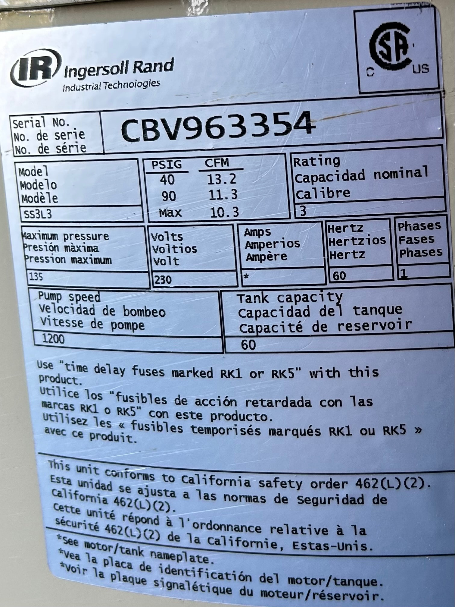

Just for kicks, I was looking at this IR:
https://www.homedepot.com/p/Ingersoll-Rand-60-Gal-3-HP-Single-Stage-Stationary-Electric-Compressor-SS3L3/202889695?source=shoppingads&locale=en-US&fp=ggl&srsltid=AfmBOooWKsanLUPs-EVgYodDI6jVSwH3vDcNq5t10YBTW8rEprV10K9GIRE

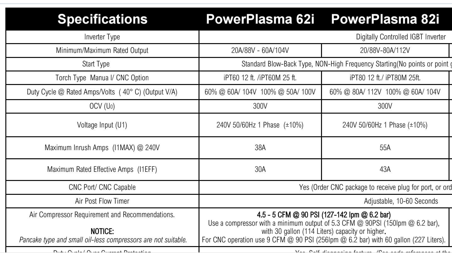

No, sorry, I thought I put it in there (edited now to include it). I’m running the Everlast 62i. I figured the table size and cut complexity was a valid consideration, but I guess I get why the plasma would dictate…
Consider shopping for a tank only to put you motor and pump on?
In your manual it wants you to have a 9 CFM compressor minimum.

I saw that. Can you trust the ratings on compressors nowadays? Both of the ones I linked to are 11.5-ish at 90psi. On paper…
Scfm is different than CFM. Scfm is under the best case scenario conditions. Always be cautious of scfm measurements.

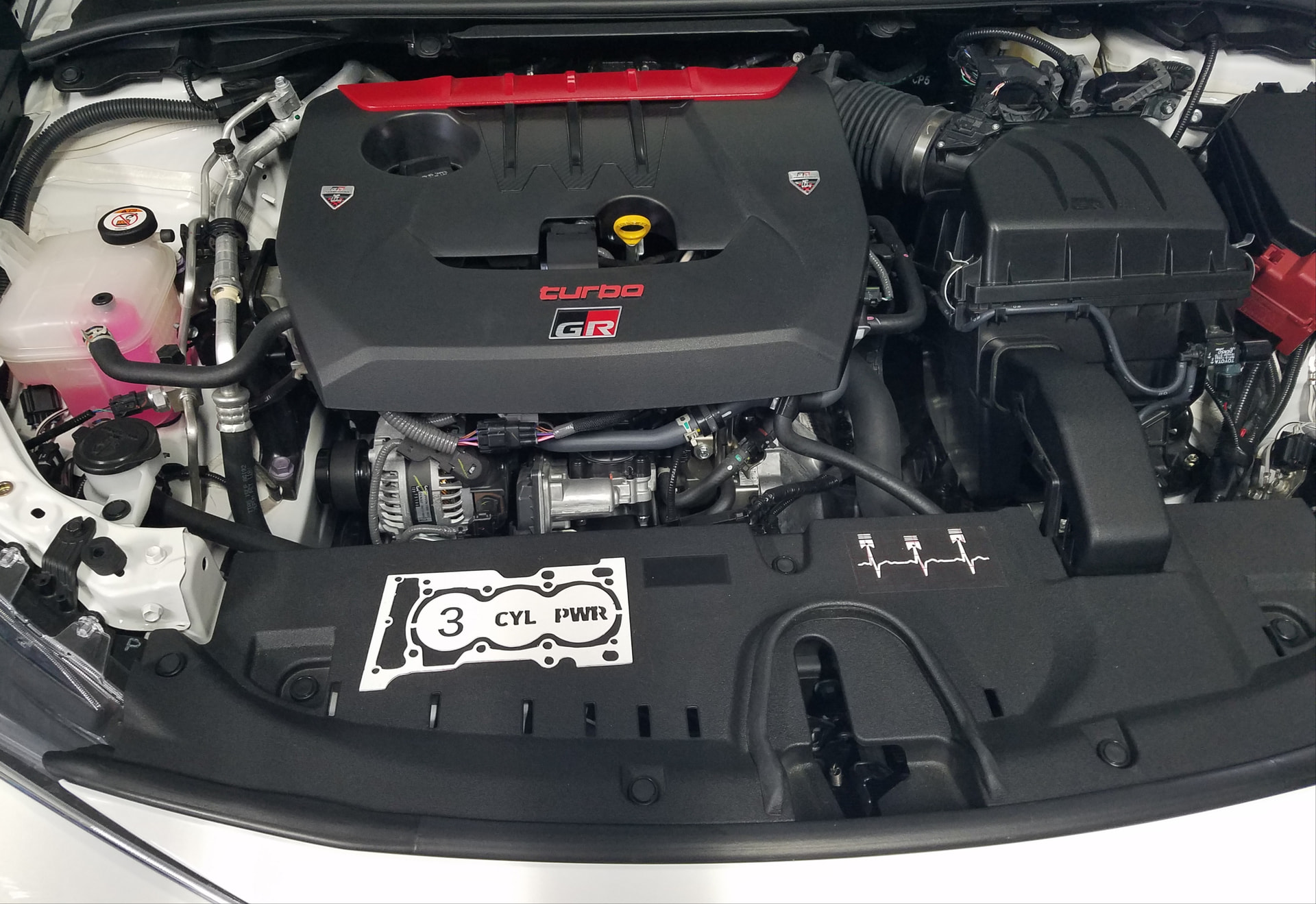

You want one of these signs I made for my GR Corolla :grin:
I like the Ingersoll Rand 3hp. You get what you pay for. 10 years from now, it will still be working. @CrazyCasey
That Oil Dipstick gets to the heart of the matter!
I bought my current car at the beginning of December. I haven’t even looked under the hood yet. Maybe I should…:thinking:
Another thing I’d like to know, is how the Windshield Wash fluid gets through the Turbo Blower and onto your windshield. It must be super atomized by then! :hushed_face:

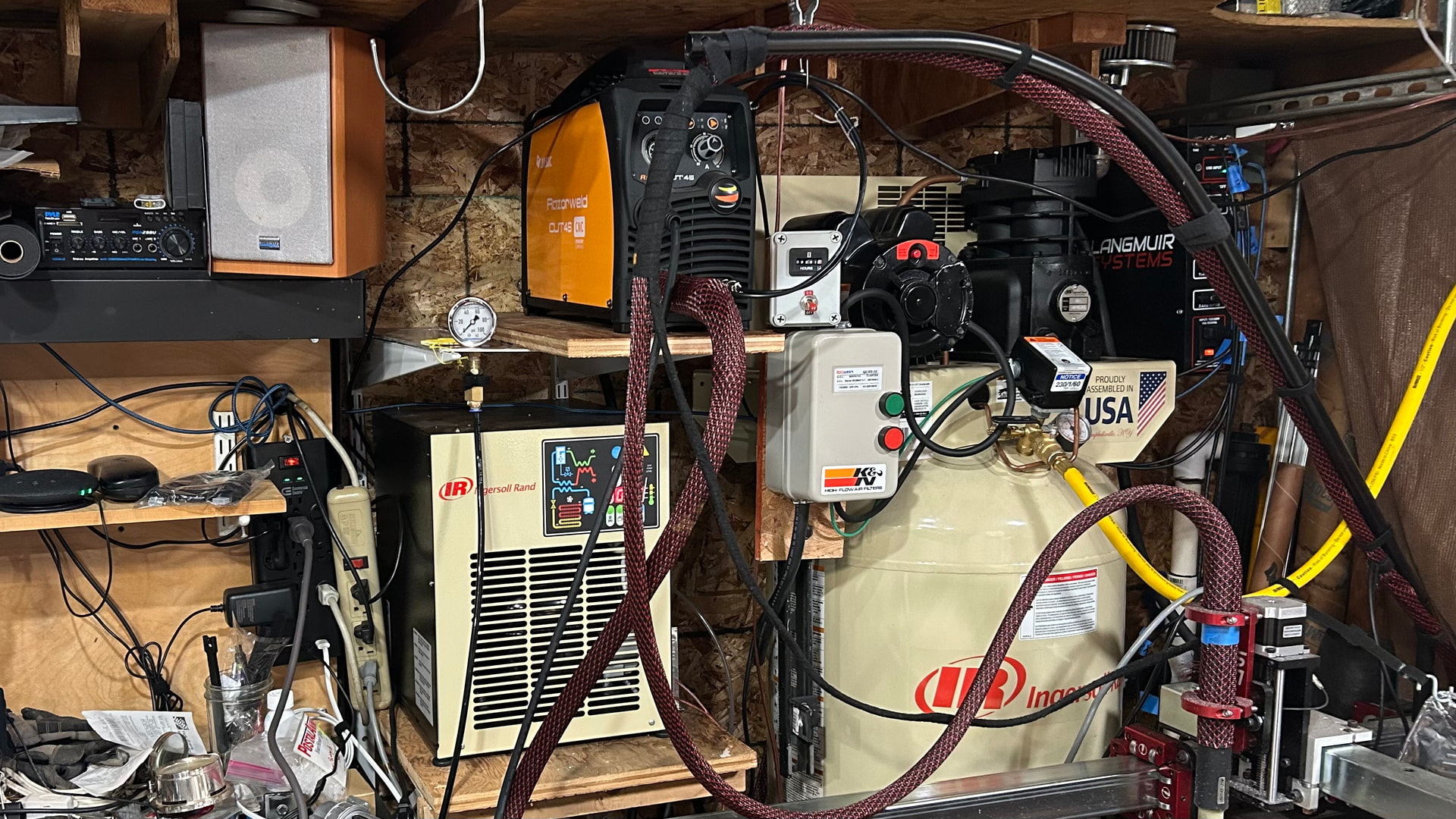

I have the 3 HP Ingersoll-Rand for my Crossfire Pro. The complaints I read before purchasing (through Home Depot) was the pressure switch burnout. So I installed a motor starter and the load goes through it instead, and only control power to pressure switch. I also have the D18INA Ingersoll-Rand dryer. Both are rated at 11 CFM
You can buy a bare tank. If the compressor was performing for your needs, then just replace the tank.
I read your thread shortly after posting this, @B_Lindsey. The SS3L3 still working well for you? How hard is it to set up the motor starter? Also, have you ever done any measurements on startup to see how much that compressor pulls? I’ve got a 20A dedicated service to my compressor, and on paper that should work for the 14.7A IR, but I did see you wired yours for 30A.
:grin: That’s the coolant expansion (overflow) tank.
