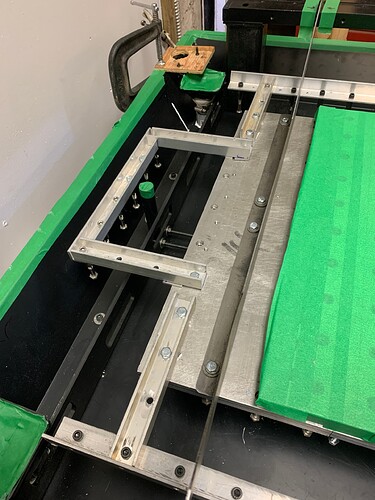

A shortcoming to me of the MR-1 is the ability to hold down larger parts, the baseplate is too small, it’s narrower than the machine’s reach and if the piece is larger you would need through holes to hold it down. I might be machining larger pieces, and even if I cannot reach all the area of the piece I want to be able to mount outside the cutting envelope. I did this two ways:
  • Add an additional custom baseplate to the rear of the two supplied, drilled out to match the pattern. You can also just order an additional baseplate.
  • Add an array of anchors outside the baseplate that can be used to hold vices or pieces in place. These can be held in place with a matrix of aluminum supports indexing off the baseplate.
I really do not know what pieces may go into this machine so I thought it prudent to add anchors now since it would harder later.
I also had cut off the L shaped support tube since it was in the way, and reinstalled it with a coupler later on.
Once the baseplate was machined (and the X rotated and machined the rear base plate), I will hand grind/finish the tops of the new anchors to match.
So the first step was to obtain a 3/4 piece of 6061 plate to extend the rear of the supplied plates 8" (that just happened to be the width of plate I found at the metal surplus suppier I used), and lay out and drill to match the pattern of the existing base plates. I used the same anchor system as Langmuir supplied, expect I switched all the bolts to stainless. Here are some shots of the underneath of the new plate with the anchor extensions.
I coupled the new piece to the existing plates using one of the MOD baseplates - that assured a fairly good alignment. I added an array of holdowns around the outside edge of the baseblate, three rows to the front, two long ones down the sides and two rows to the rear. The anchors are the same as the ones used for the baseplate, but all in stainless since they would be exposed

So now its ready to pour - the entire baseplate assembly goes in one piece. Next, the concrete pour itself.
So next is the concrete pour. I used 6000psi concrete, mixed to the instructions from Sakcrete. That was quite a dry mix, but luckily I rented a mixer and had a few helpers. Tried the sugar trick but not sure it did anything. The initial concrete was easy to place, but you have to be careful not to move the Y axis rails which are floating in the tub. Given my baseplate was quite a bit larger than the stock one, it took quite a bit of tapping/wiggling/hammering to get it to sit flat.
It was a challenge to since this larger baseplate with its additional anchors into the mix, and it took two people to place it. With hammer tapping/wiggling/vibrating we got it settled down.

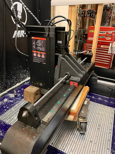

Of course, with an extended baseplate, machining the surface is a challenge since it cannot be reached. I rotated the X axis 180 degree to reach the rear once the front was roughed out.
Here is the reach when the spindle is at the front of the X carriage, roughing pass done. The plate was quite flat, I did not have to take much off to get to this.
Now undo the X axis bolts and rotate the spindle 180 degrees. I had some car dollies in the shop so used that to easily rotate it clockwise.
Rotating
In place facing to the rear
Once in place, I had to realign the x axis and check the nod of the head, which was fine. Since the X axis is now backwards, you have to be careful with the controls (since they are reversed), and the new start position for the baseplate program is to the right, not to the left. Here is the new home position.
The cutting program works fine since the direction of the Y travel is the same. I then surfaced the rear of the extended plate, machining about 1" into the supplied plates. Two passes and a finishing pass.
Resulting in this
Ok, time to rotate the X axis back again and realign it all. Since I cut about 0.003 below on the rear surface, I have some meat left on the front to finish pass it to match the rear plate.
