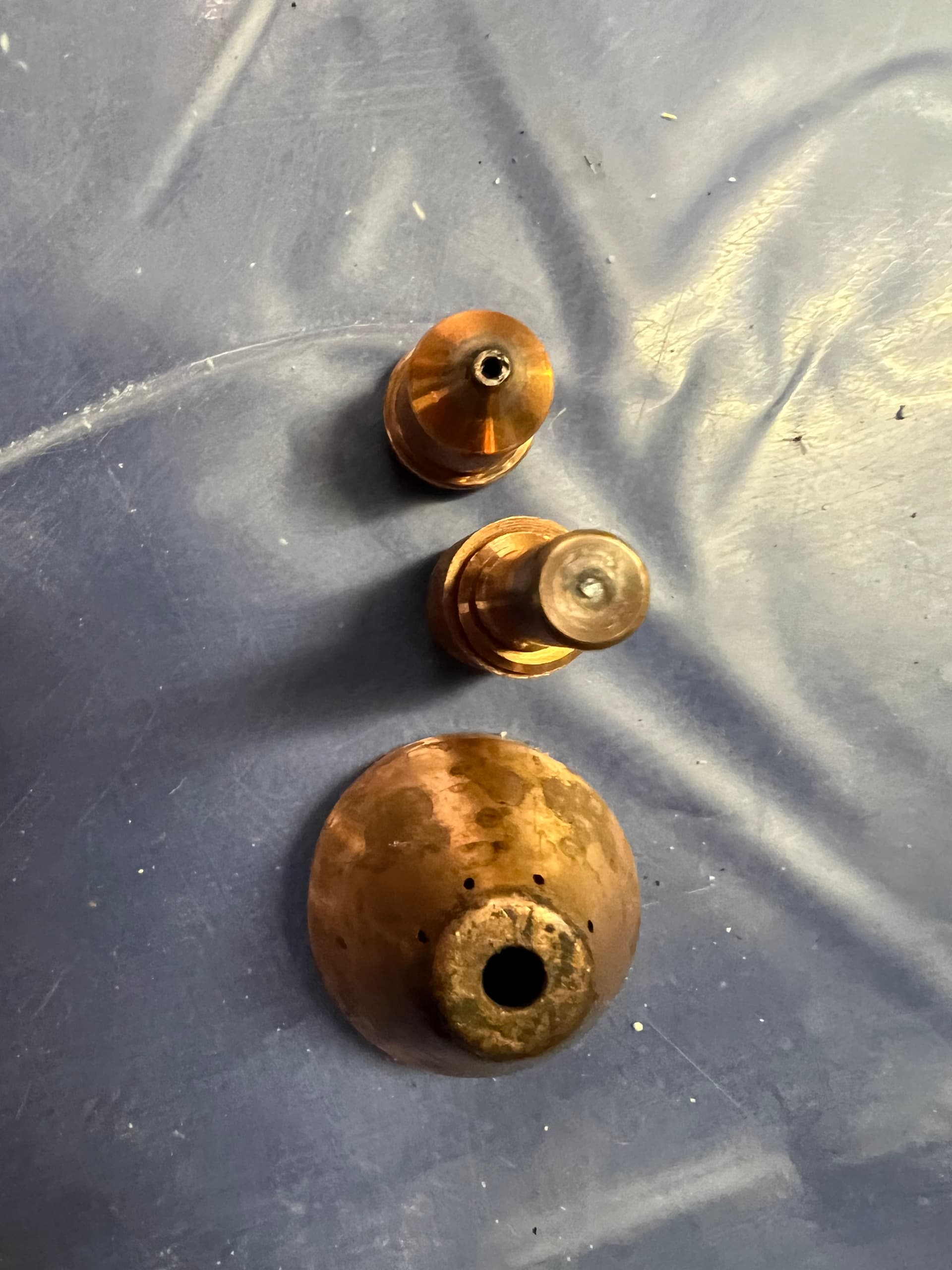

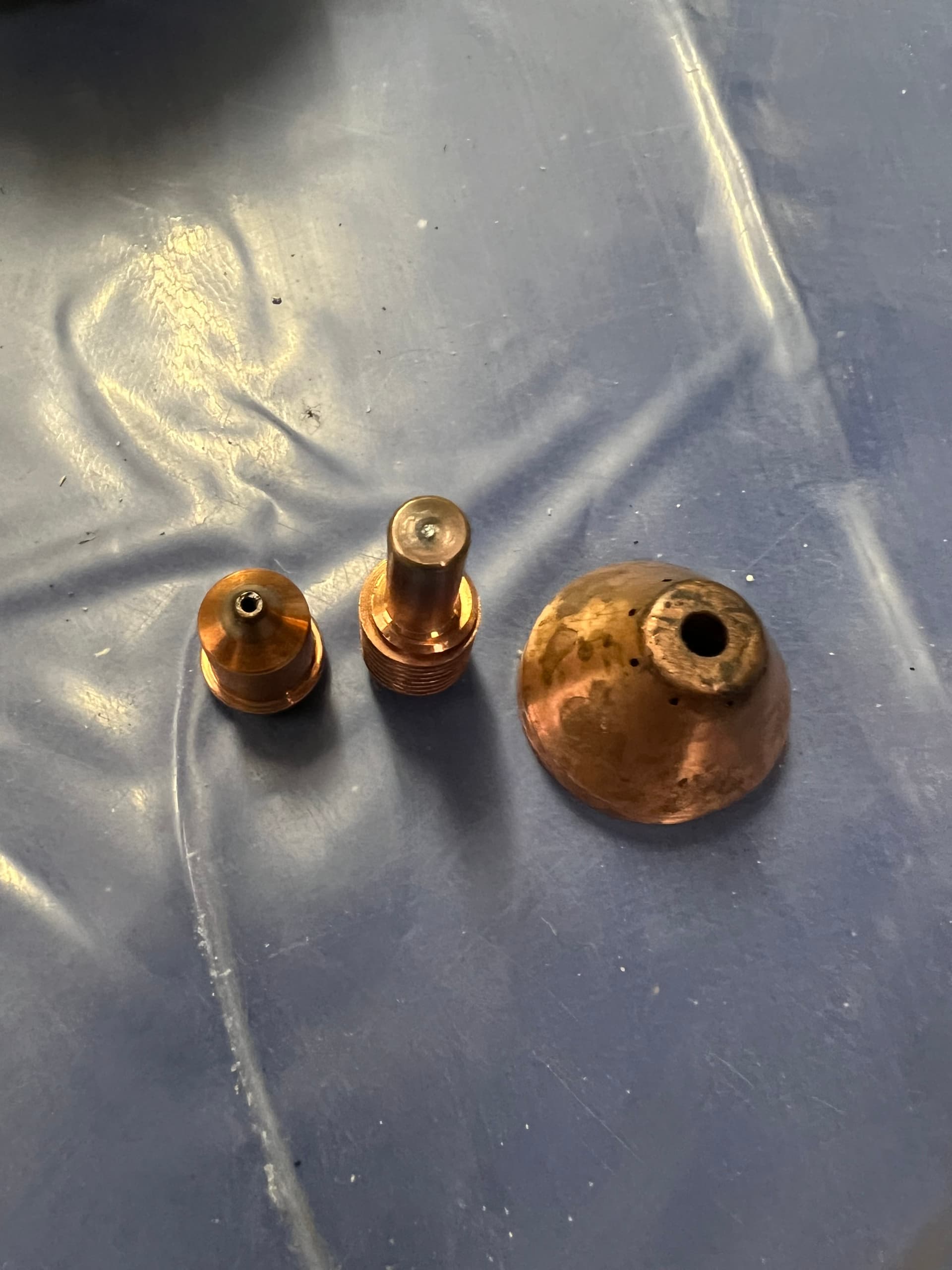

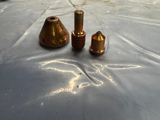

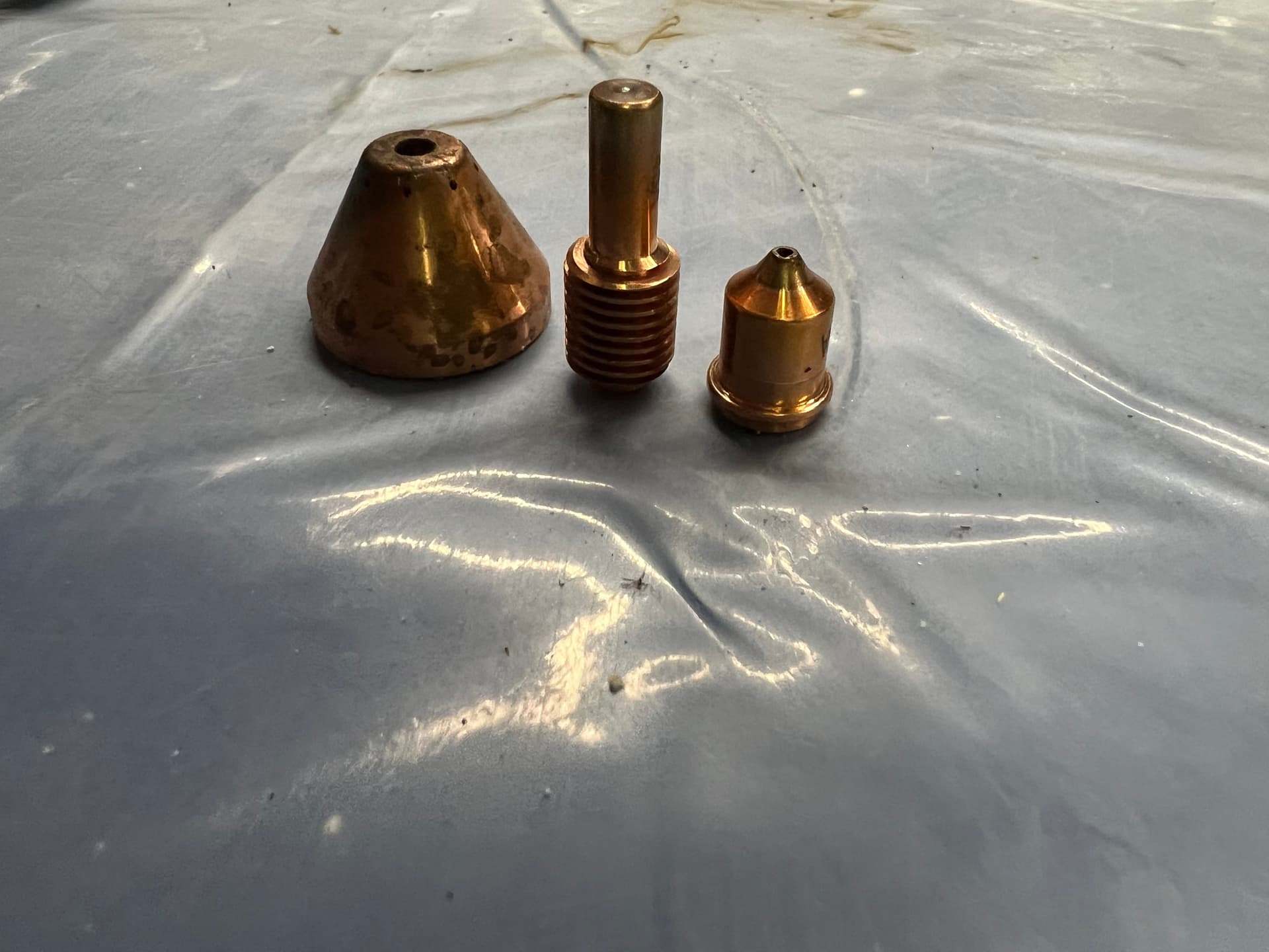

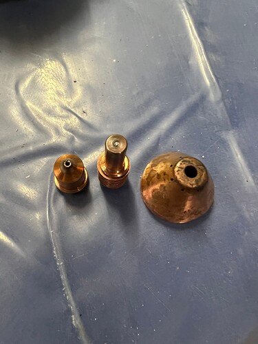

Post pictures of your consumables; not knowing how well your air setup is I would say moisture could be playing a role as it leads to inconsistent cut results.

The gauge reads 3/16. You were right about the T2. Somehow it was on T4. Thanks for the images. It is installed correctly now. The bottom was not finger breaking tight on the clamp. I replaced the thumb screw with the allen and adjusted the torch position. For the last 40 minutes I’ve been trying to load or email, message or bt the parts images from my crappy phone. I’ll probably bring the laptop out there and use that camera. This freakin pnone!

All I have is the tip that came it. Where’s the best place to get those consumables?
I mean nozzle

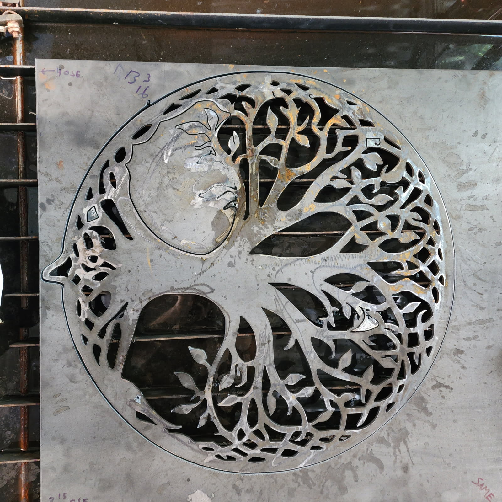

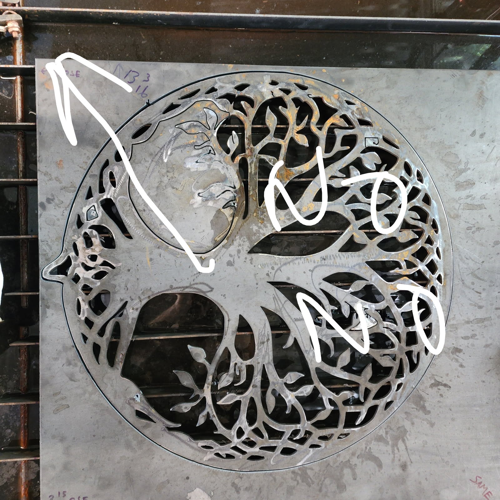

So here are the results of the first almost successful run. After finishing the program, I slide it out to inspect and clean. A couple of spots failed a full penetration. I slid it back in, hoping to hit those spots one more time. I zeroed the torch, located the line number and entered it for a dry run to be sure, then ran it. It began a pierce, BUT quickly stopped, displaying the same message as last night. It looks like everything is in order. So I’m lost again.
Also, I was kind of expecting this next one. The compressor and the cutter working together on the long final outer cut flipped the common breaker leading out from the house. The individual breakers in the shop are fine. I flipped it back on and finished the last several inches of the circle. This happened BEFORE trying to recut the failed penetration. It is possible the failed penetration is related to this condition. So, until I can change the wires from 10 to 4 or 6, I’ll have to pause the program during compressor intervals. For now though, I’ll just hand cut those pieces with a different cutter.
