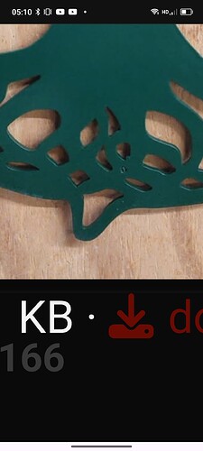

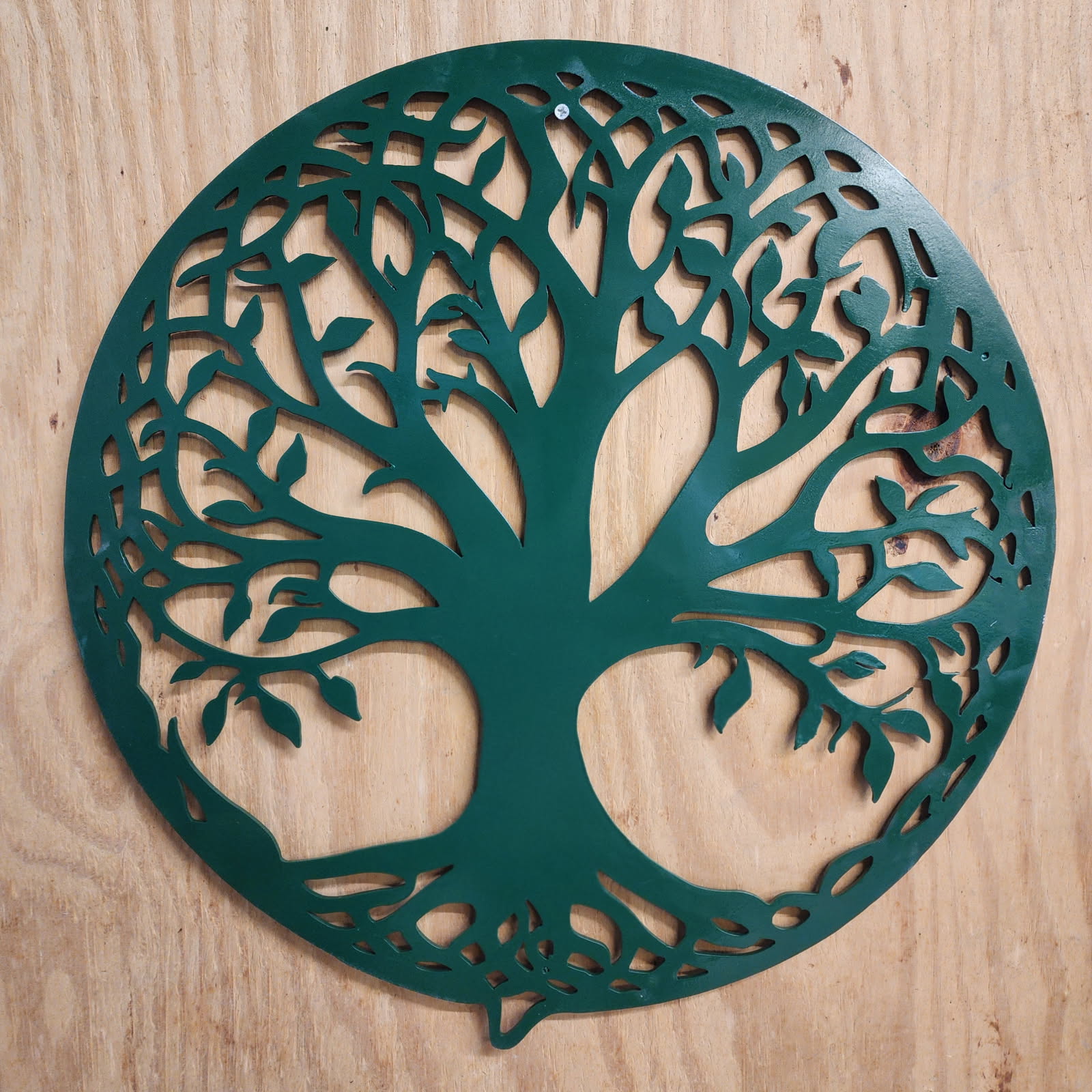

I like the detail of this little loop. It makes it look like it’s some kind of knitting or macrame that’s loose at the bottom. Cool detail
No, I brought out my ole oxy/acetylene bottles. Cheated. Only needed to cut a few inches.
Cheater….
Haha
Thanks, but I can’t take the credit. It was copied from someone else’s work, Celtic Tree of fife.
:rofl: Oop… you a laugh out of me! I needed that.
