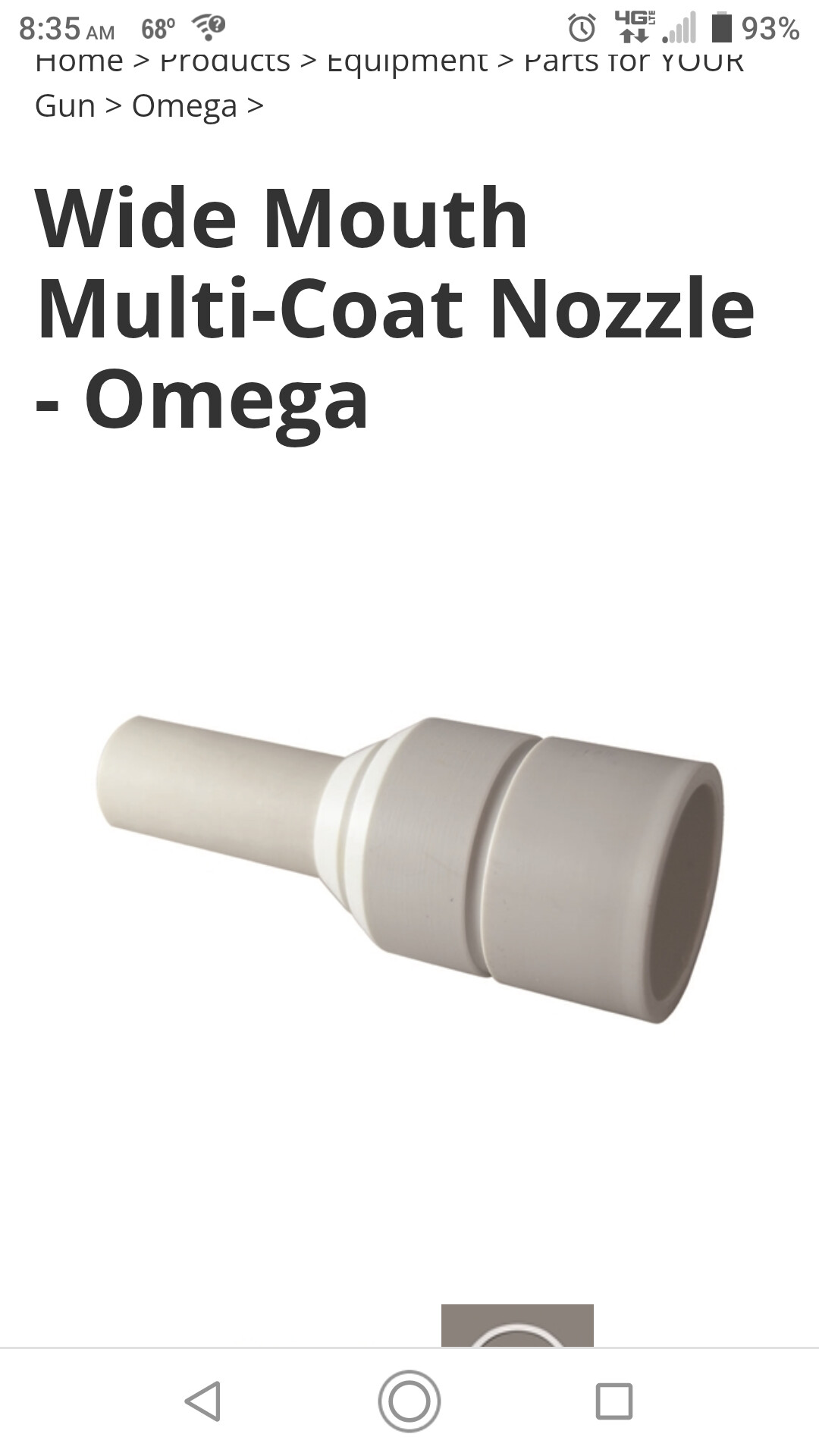

Have you attempted adjusting the kv? I have a nozzle for my gun that helps with faraday. This nozzle makes multi coats a lot better and also helps faraday areas. It slips right on the end of the nozzle.
I have also found the farther back you hold the gun through easier the powder will stick to faraday areas. Then turning the air down helps too.
I have got pretty good at getting those areas, I do turn down the Kv but I also have nozzle that work pretty good.

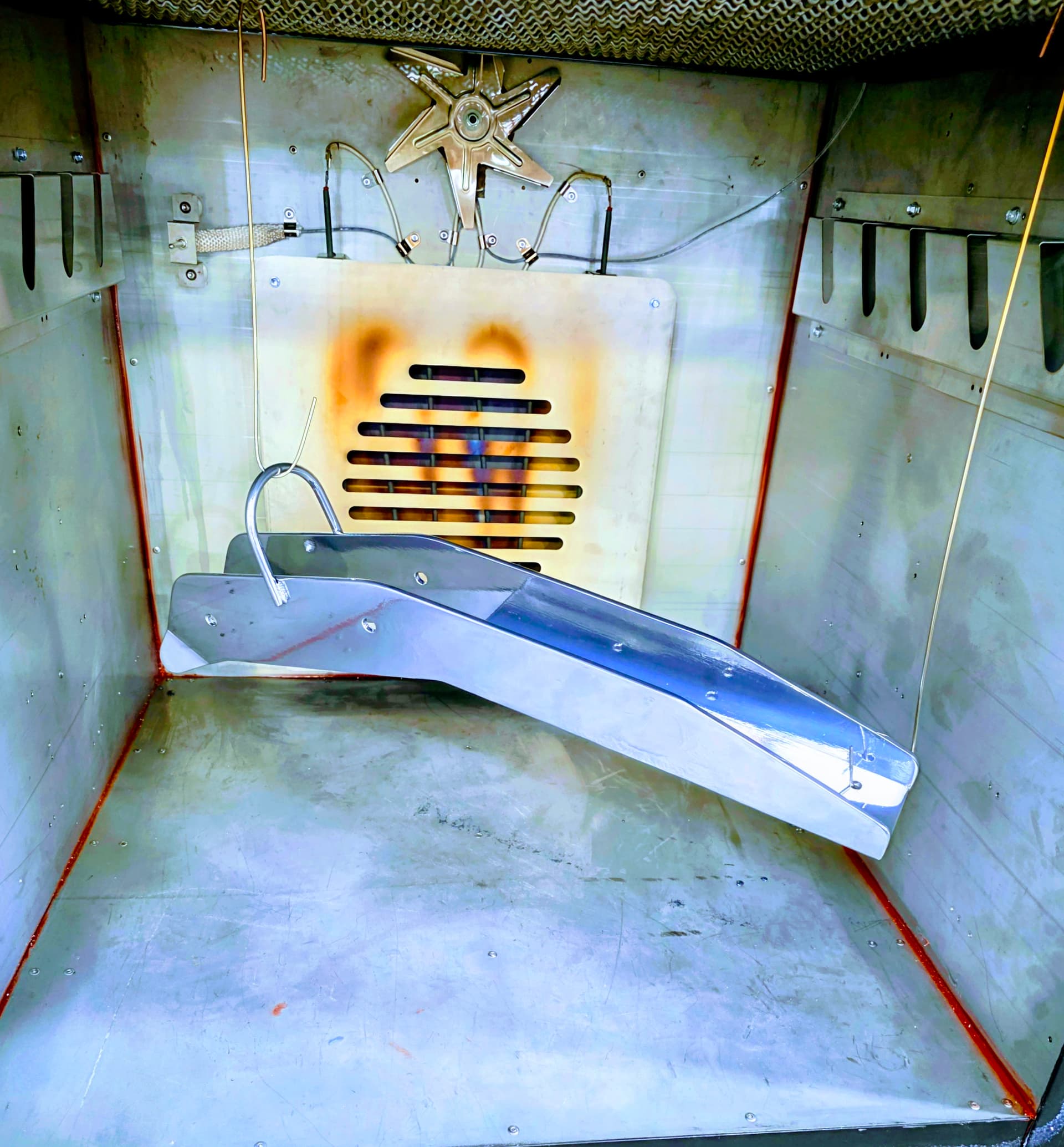

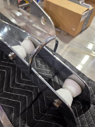

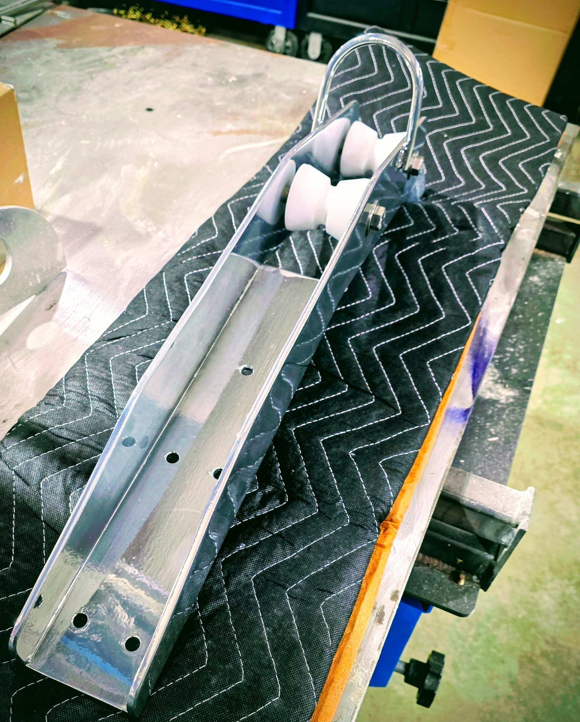

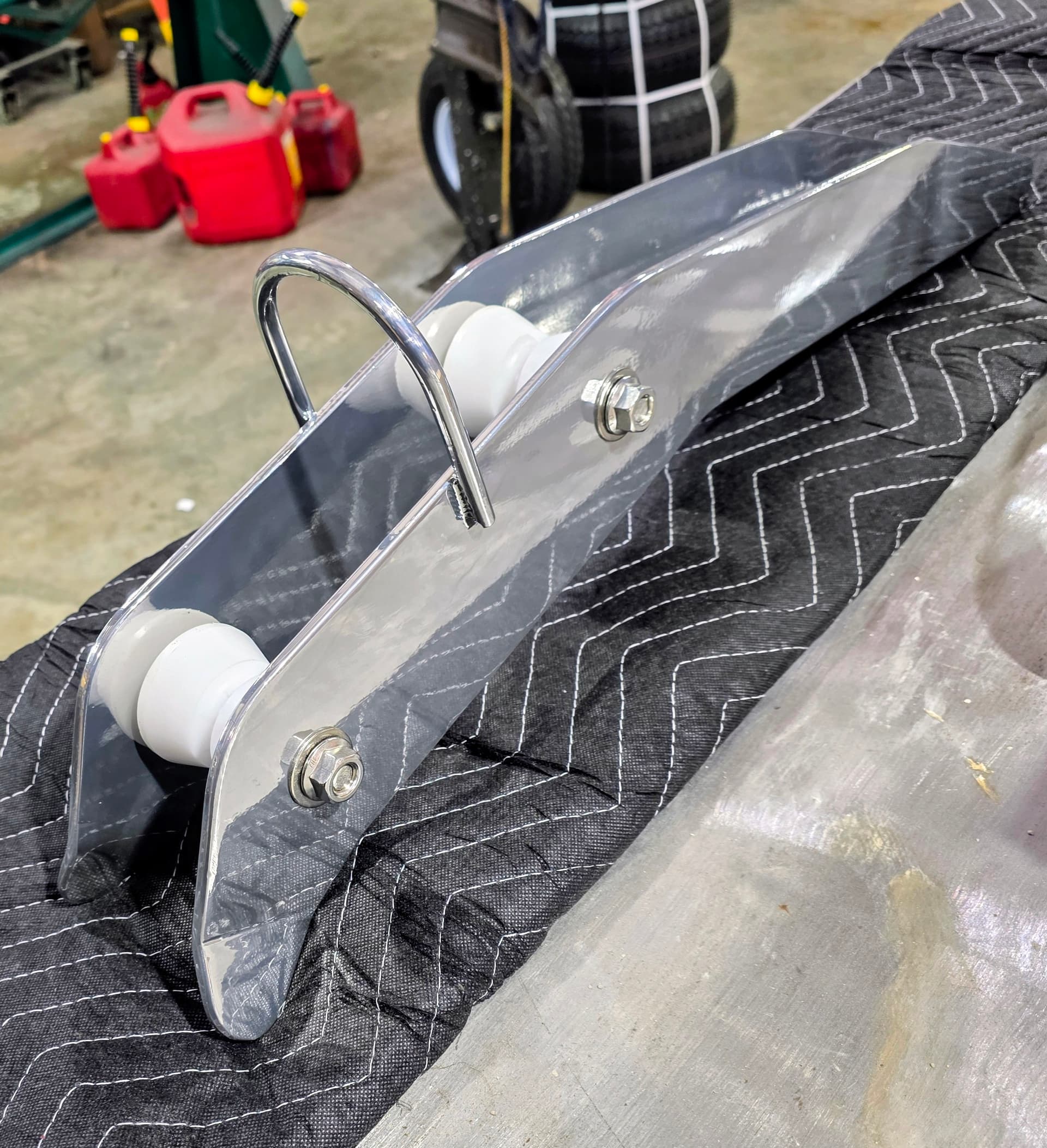

Here is an anchor pulpit that I fabricated out of 304 SS for a cruiser for which the original was no longer available. Prismatic coatings - Super Chrome Plus with a clear second coat. The Vulcan 16 is working perfectly so far.
I have used that and had good luck, Im curious why paint stainless?
The cost of polished 1/4 SS was crazy—four times what a replacement would have cost. Unfortunately, it is not made anymore.
He decided to go with a regular 304 plate. It was too big to bend in the Titan so I made it in three pieces ,and Tig welded them together.
The pictures don’t do it justice after powder coating it. He took one look at it today and said God dammmm.
