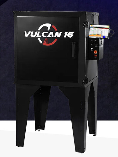

Hello Everyone!
We are excited to announce the Vulcan 16 Powder Coat Oven! Provide a refined furbish for your parts!
You can read more about it here: Vulcan 16 Powder Coat Oven | Langmuir Systems

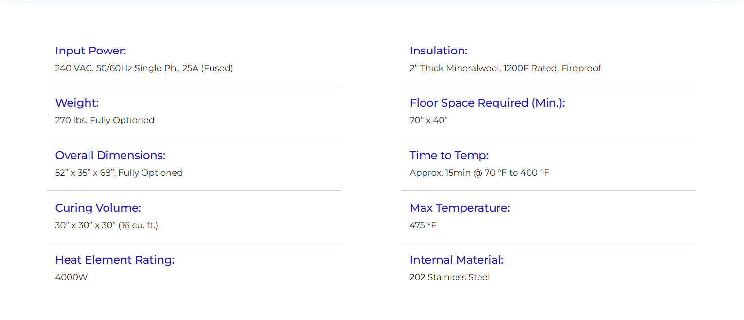

this thing looks freaking cool, what kind of power requirment is it going to have?

240 VAC, 50/60Hz Single Ph., 25A (Fused) is the power requirement.
You can read more about the specs here:

Max temp?

So is Cure control tracking part temp? and if so hows it doing it?

Yes it is tracking part temperature. Two thermocouples and a PID controller. +/- 5 deg temperature accuracy.

475 degrees Fahrenheit. So no annealing but you could use this to temper your metals.
