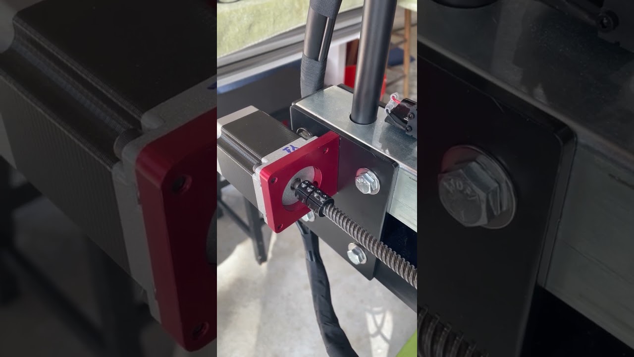

I’ve been working slowly and deliberatlely trying to get my machine ready to fire up for the first time.
Installed the Limit Switch kit and had it pretty well dialed-in yesterday. Set up my hard and soft limits and the machine seemed to home properly and stopped before crashing at all extremes on the table.
Unfortunately, when installing the limit switch brackets on the Y-axis I didn’t fully tighten the bolt so the bracket was able to slip out-of-position and it ended up moving back toward the stantion plates. This caused the machine to crash against those plates before it hit the Y-axis limit switch and it was fighting to move to the zero position for several seconds before it finally gave up and threw an error on the screen.
Once I realized what happened, I moved the gantry and secured the limit switch bracket properly, and was prepared to re-do the whole limit switch calibration / soft limits set up again. The problem is that the machine was acting funny whenever I tried to jog on the Y-axis… there was a strong stutter or stammer at low travel speeds and even at high speeds it would occasionally glitch and not move.
My initial thought was that the lead screws were bound up and the gantry might be misaligned after the incident, so I tried loosening the allen screws on the coupling cylinder on the Y1 motor to see if it would relieve any binding there… it didn’t seem to make any difference, so I also removed the 4 bolts from the leadscrew tensioning block to see if there was some kind of preload in the gantry.
At this point, both the Y1 and Y2 motors were still attached electrically and the lead screw coupling cylinders were tight on both sides. This would allow me to see more clearly what was going on when I tried to jog the machine. When the machine was jogged, the Y1 motor acted funny and appeared to stutter or stammer but would not rotate properly.
I reseated the Y1 cable in the control box, and will try completely powering off and back on to see if that helps. Obviously this all worked properly just before the Limit Switch / Stantion crash so I know that everything was wired and set up properly earlier this morning.

UPDATE -
A few more data points…
  1. Disconnected the 4-bolts on the Y2 motor lead screw side (good side) just to see what the behavior of that motor was and to notice any differences. The leadscrew spins perfectly at all travel speeds (10 ipm - 300ipm) and is VERY hard to turn by hand… but it can be done. Has a slight ratcheting feel when it is rotated by hand.
  2. The Y1 (bad?) motor is a LOT easier to turn by hand… can almost do it with 2 fingers. Also discovered that the stuttering only occurs at low travel speeds (10 ipm and 50 ipm)… it spins normally at 100 ipm / 200 ipm and 300ipm. When stuttering the motor does not rotate… it just moves a few degrees clockwise, then a few degrees counterclockwise.
  3. Disconnected the Y1 and Y2 motor connections on the control box and swapped ports to see if the issue was wiring or controller related. The issue stays on the Y1 motor whether it’s plugged into Y1 or Y2 on the control box.
This additional information leads be to believe that the Y1 motor is bad. I have removed any possible binding from the lead screws (on both sides) and the motor still behaves strangely… swapping wiring does not move the issue to the opposite motor.
Full cold-boot on the machine and PC did not resolve the issue.

Is the motor shaft spinning inside coupler, due to lose screws on motor shaft side? I can’t tell in vid; I would check that might have spun inside coupler chewing up inside bore of coupler.
No… I wish it was something simple like that.
The unusual part is the way that the motor does not turn at all… it just wiggles back and forth from left to right a few degrees instead of spinning all the way around… almost like it has a damaged stator or something. When I set the machine for a fast travel speed, it WILL spin correctly… but when I set it to go slow it will just wiggle helplessly.
-TM
Well that sucks, burned something in motor then.
Thats my guess at this point… feel like I did a pretty logical diagnostic to isolate the issue to the component level.
