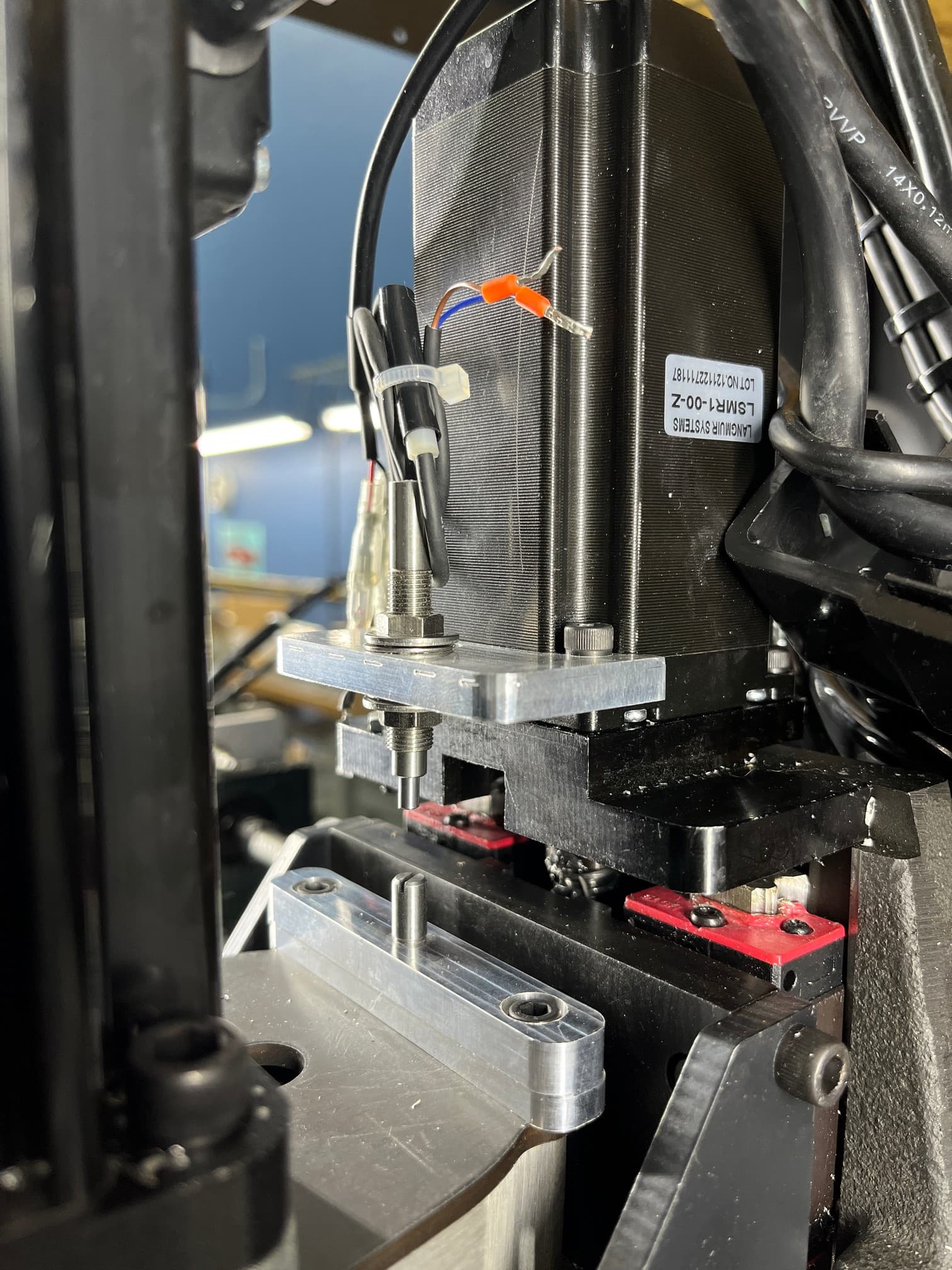

This is one for the electronics experts. Some time ago I upgraded the X&Y limit switches. A big improvement. Recently I decided to upgrade the Z limit switch. I get an error indicating an “open switch condition”. I thought that it might be due to the load from the LED and located the same switch minus the LED. I get the same error message. I have reverted back to the original Z limit switch for now. Any insight would be appreciated.
Also. A few photos of how I mounted my limit switches. And a Step file of the Z limit switch mount. I decided to use a small pin contact point for the Z-Axis. I found that chips can sometimes make their way onto the flat surface of the spindle mount. I figured this would reduce the likely hood of the switch coming in contact with a random chip.
Z Axis Limit Switch Mount ASM
Very nice job. I never updated the Z switch on my machine. It will be interesting to find out what you find.
It looked like a pain to get done, and I had several projects at the time. Now, when I get in every morning, I sit and stare at it from my desk. Love your brackets.
Maybe a case of overthinking this on my part. Yes the precision limit switch on the Z axis would be nice but is it really necessary? As you noted the X&Y axis limit switches are exposed and prone to interference. They also use a flexible arm to trigger the mechanical switch component. On the Z axis the lever arm is discarded and the machine makes direct contact with the switch mechanism. For this machine that is probably more than sufficient.
The bigger issue seems to be the inconsistency related to the probe that others have also experienced. You can see it in the mount that has the contact pin.
