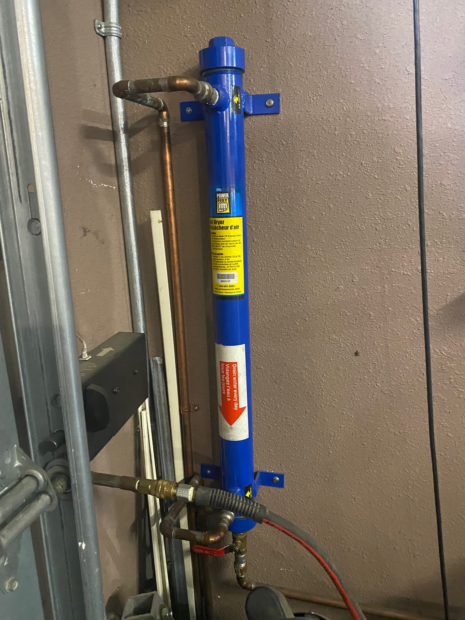

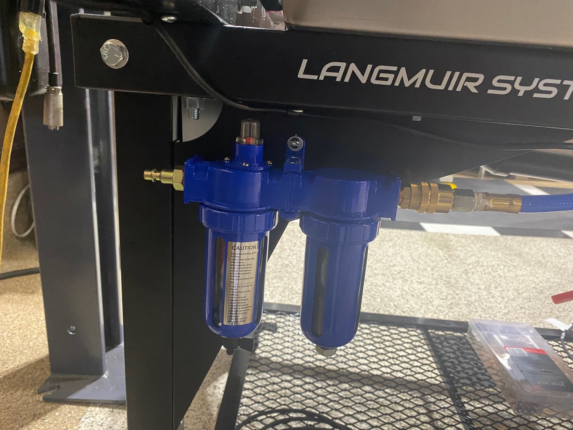

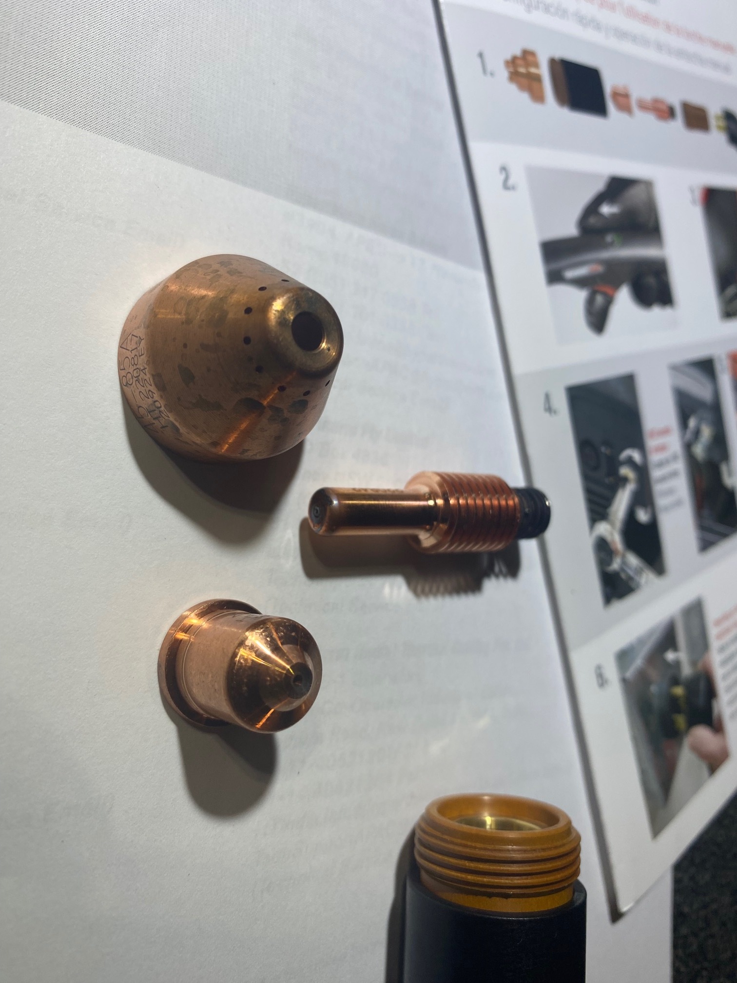

Post pictures of your consumables and tell me about your air system. What do you have to cool and dry your air? You say two small air dryers; but what exactly and how much air line do you have and what size. You can trash consumables fast without a good setup.

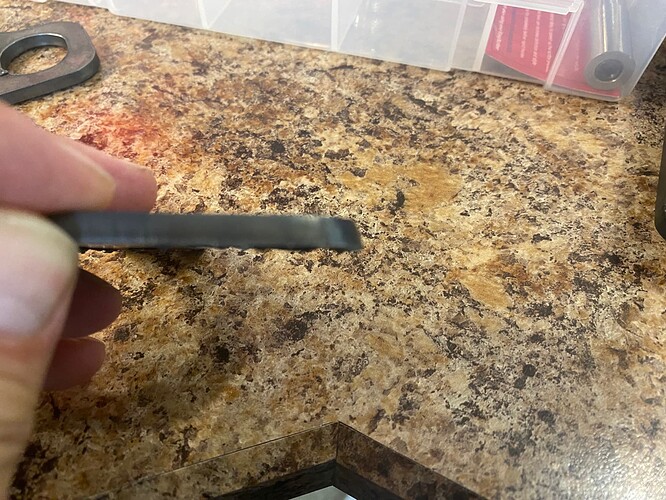

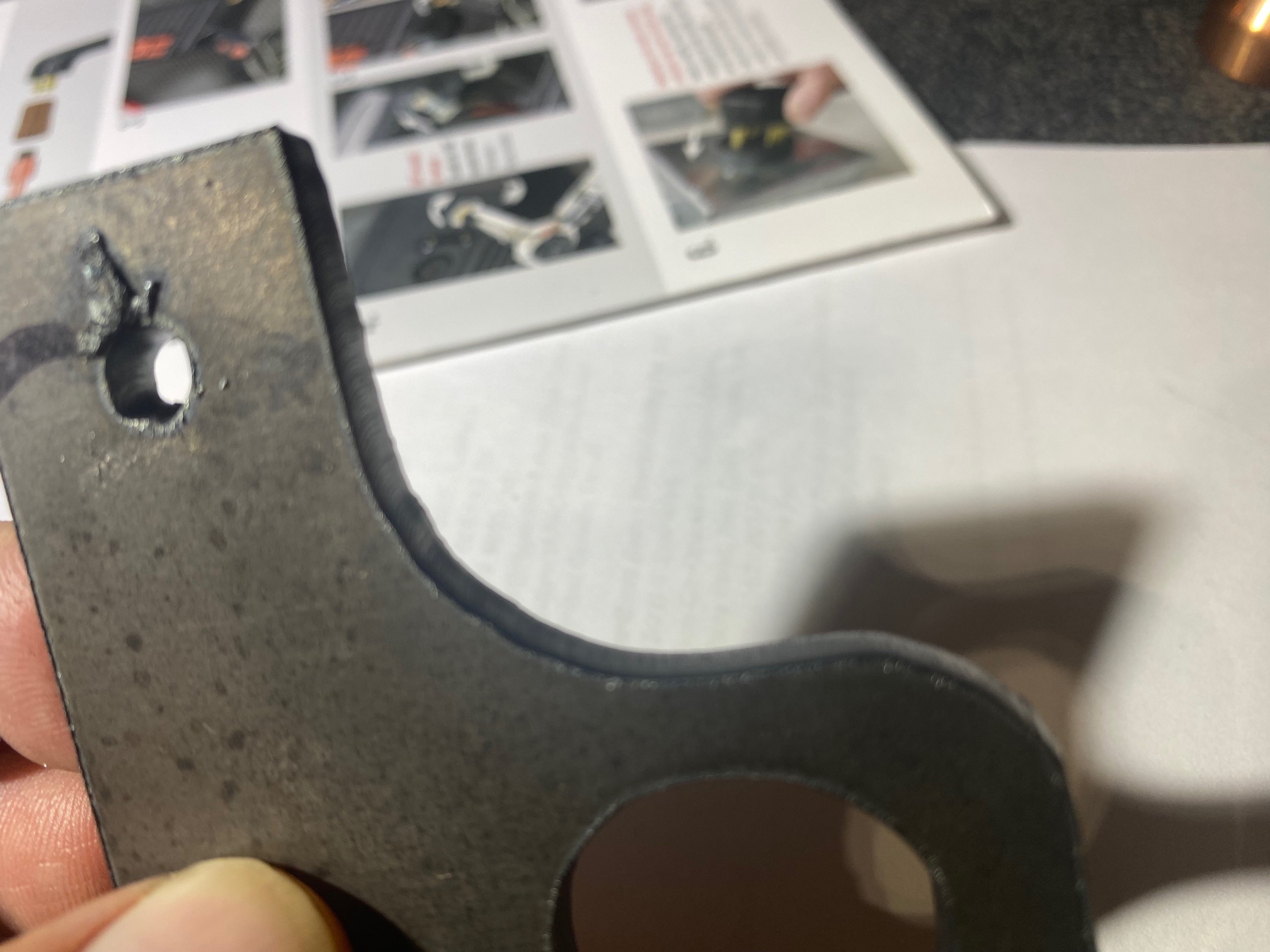

Also post pictures of the bevel, and try cutting in a different area of the table.

The larger air dryer is mounted about 33ft from the air compressor and I used 1/2" copper tube through out the shop. The feed goes from the compressor to that larger air dryer back to the compressor area and through out the shop. The consumables shown are taken today after the have cut about 12 of those items in the picture. I am pretty sure that most of my problem is height as I did find it too high but quite a bit. I did not measure what it was as I thought I could just lower the torch in the mount and it would take care of it. The machine was set to 45 amps. I dont know about what the live voltage was. I will play with it more today and document these things. The ground I have split on a lug. I have one permanent to the table and the second is the normal clamping style that can move around. I had that on the table slat that the work piece was sitting on and not direct on the work plate. I really appreciate the help on this from everyone.

That being said, looking at your bevel, I’m guessing your torch is rising due to low voltage, because that’s what mine did when I experienced it. If you had an even longer cut I bet it would rise and stop cutting altogether. This usually happens on longer cuts, as the torch raises over time to reach the voltage it feels it should be at. Your interior circle is fine because the torch hasn’t had enough time to try and raise to compensate. I experienced this all because I fell for the classic plugged in laptop (grounded outlet).
Your consumables look fine, and your air setup doesn’t raise any flags. Is the bevel happening on the Y axis just because that’s a later segment in the file?

The picture is not that clear to the real deal. It was hard for me to get it to show up in a picture properly. the bevel issue that is.
The holes are the first to cut and the are as beveled or even more than the outside cut. Upon closer look, all the sides have a bevel too them but the one cut direction is WAY more of a bevel than the other.
Cut height and speed is something I need to play with indeed. Where it slows down for a curve, its noticeably worse.
Yeah that all makes sense still. The inside curve looks choppy too.
