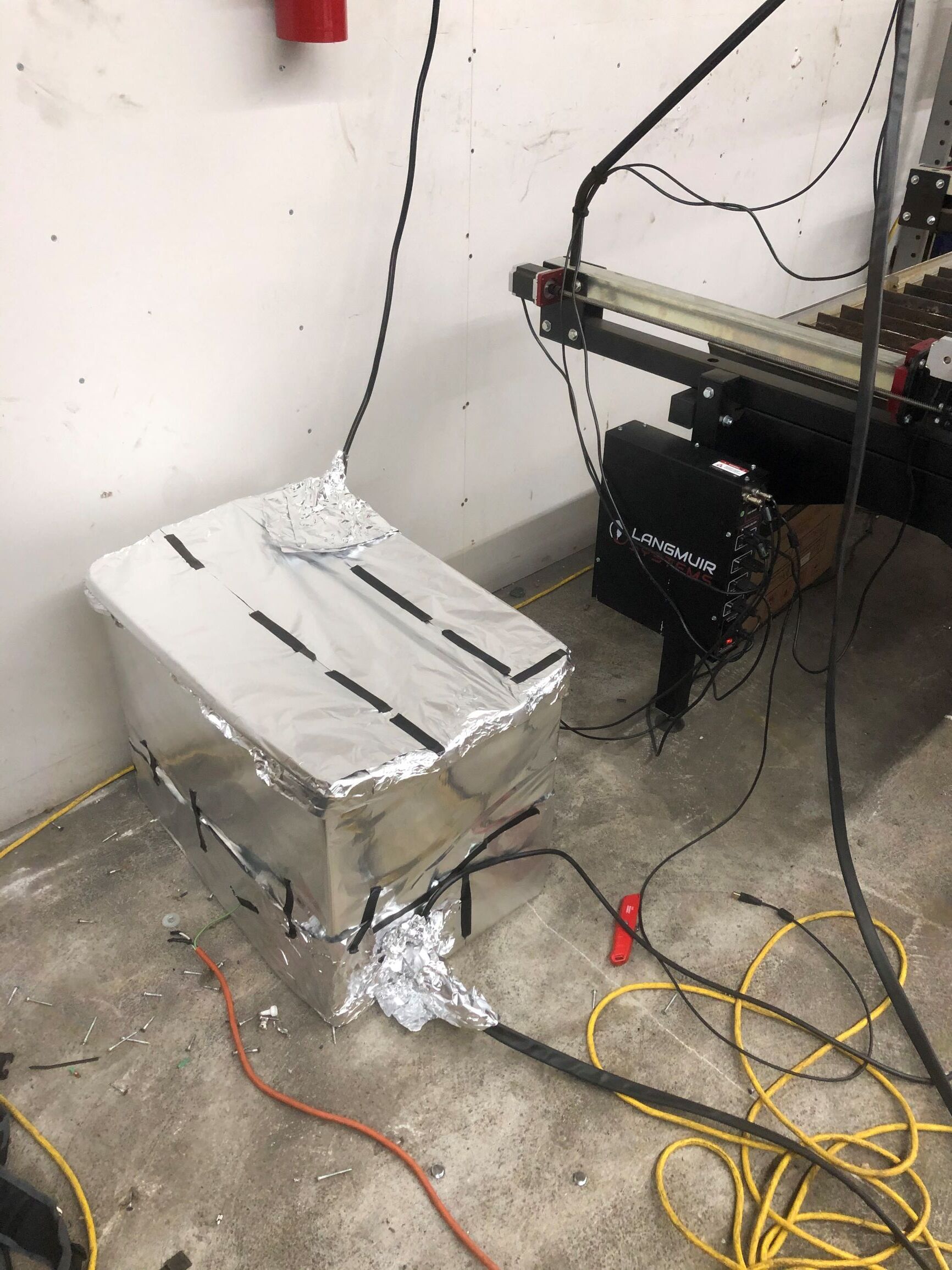

I have never seen that before…not sure if I want to ever again…
you are going to overheat your plasma cutter…no ventilation
It was literally for one test cut for diagnostic purposes…

Nice Faraday cage.
