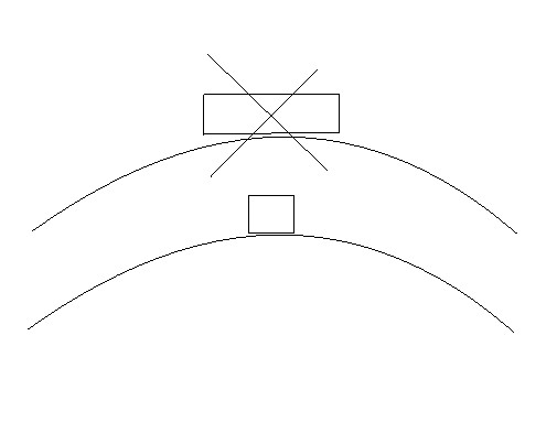

One of the common missuses of a magnet is placing it the wrong direction. If you place the magnet across the curve of metal it will fall off.
magnets and sheet metal
I had mine like shown in the lower drawing but still fell off on 1/8" and 14ga, 3/16" it was fine.
