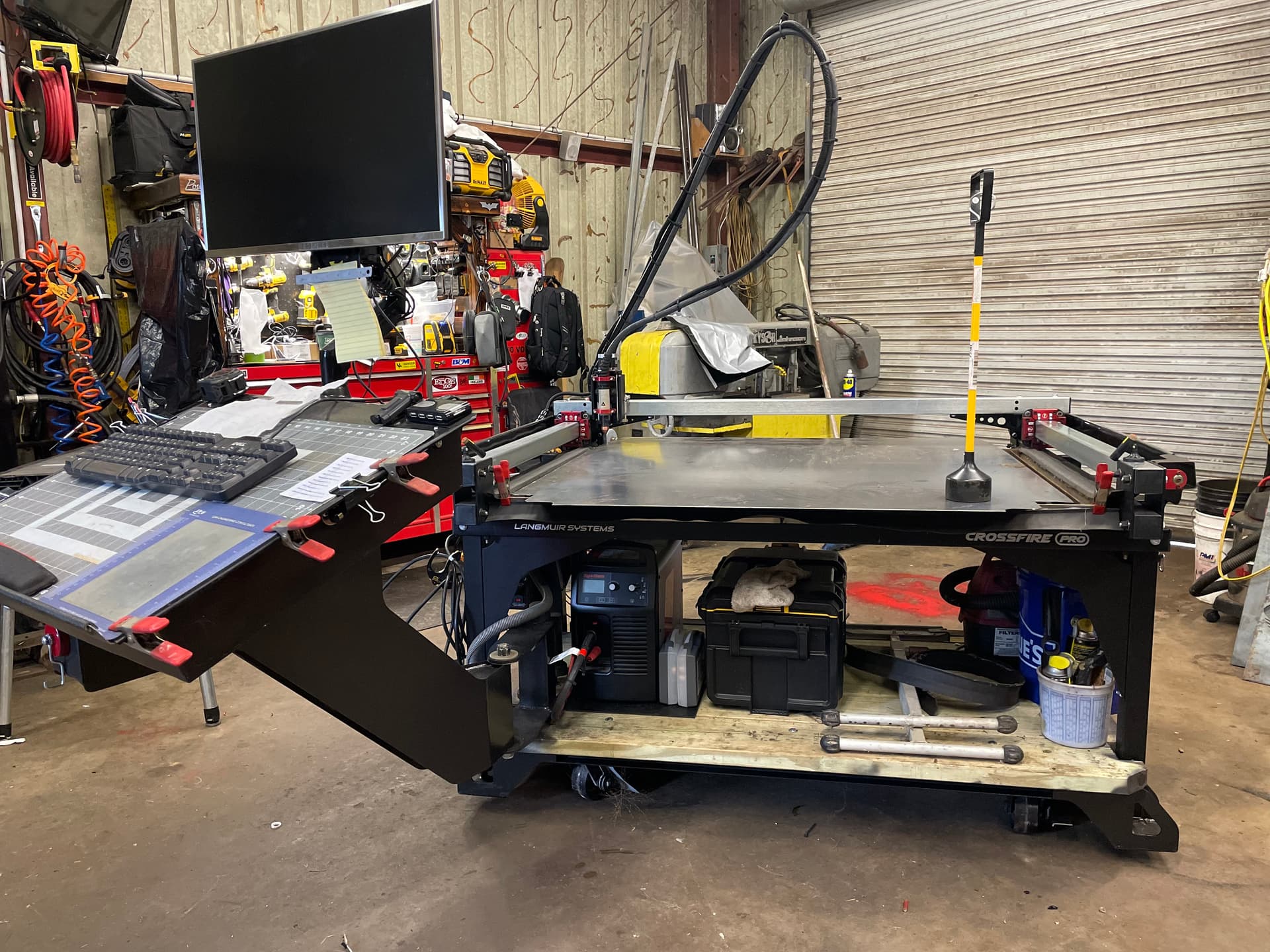

Purchased the Crossfire Pro late last year and have been steadily modifying; adding guards, LS kit, rolling stand, & etc. (mostly sourced from this forum). Looking for methods or ideas of loading full - half sheets of 1/4" or 3/8" plate and was wondering how everyone else is doing it? . Recently, just completed a rolling stand and had the idea of an integrated scissor lift to help achieve the task but would like to source the forum first. Any tips or ideas you all may have would be greatly appreciated.

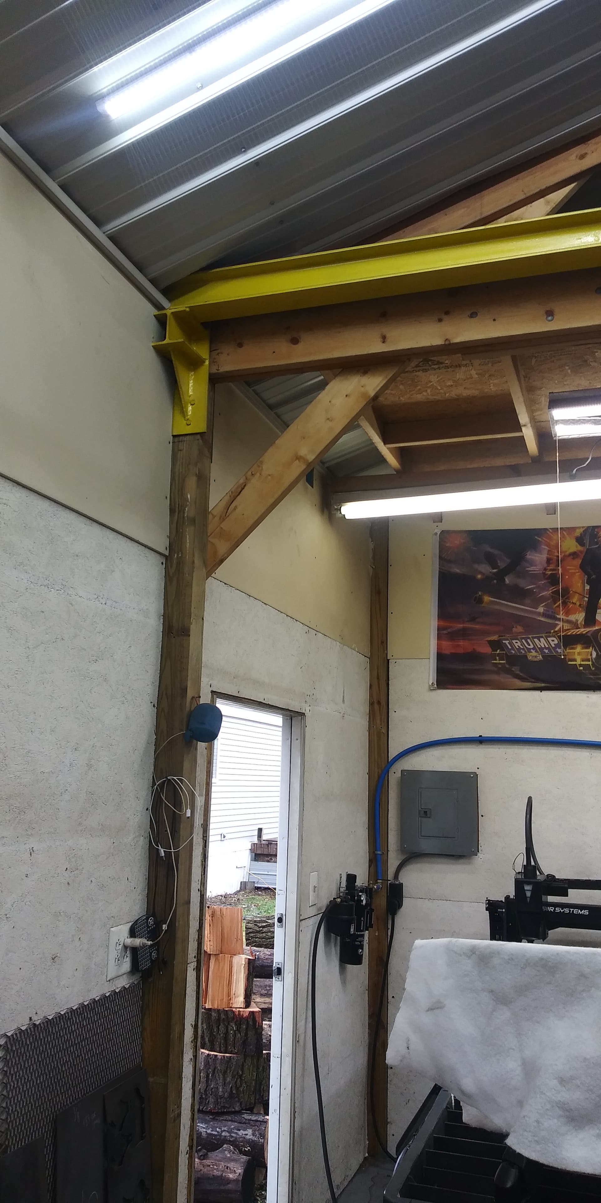

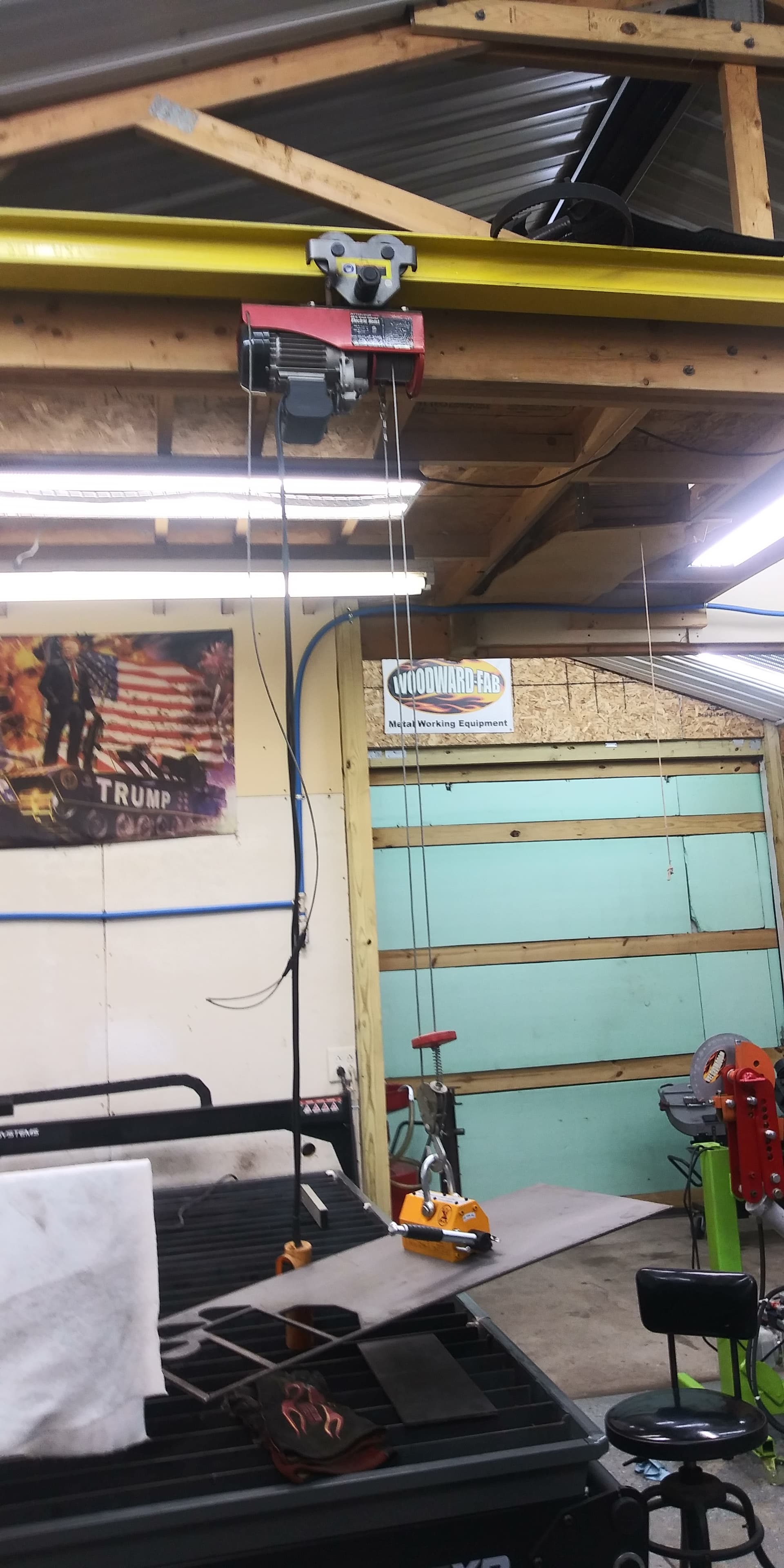

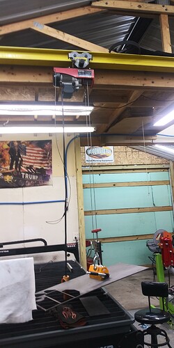

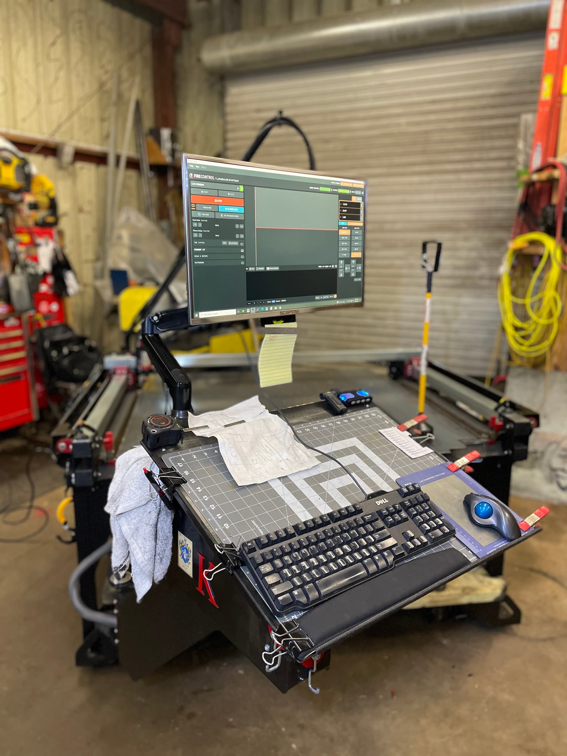

Here is my setup, electric hoist from Harbor Crap, 1400-pound capacity on/off magnet .Installed 3/8" x 4" x 20’ I-beam when I built my shop. Works great.

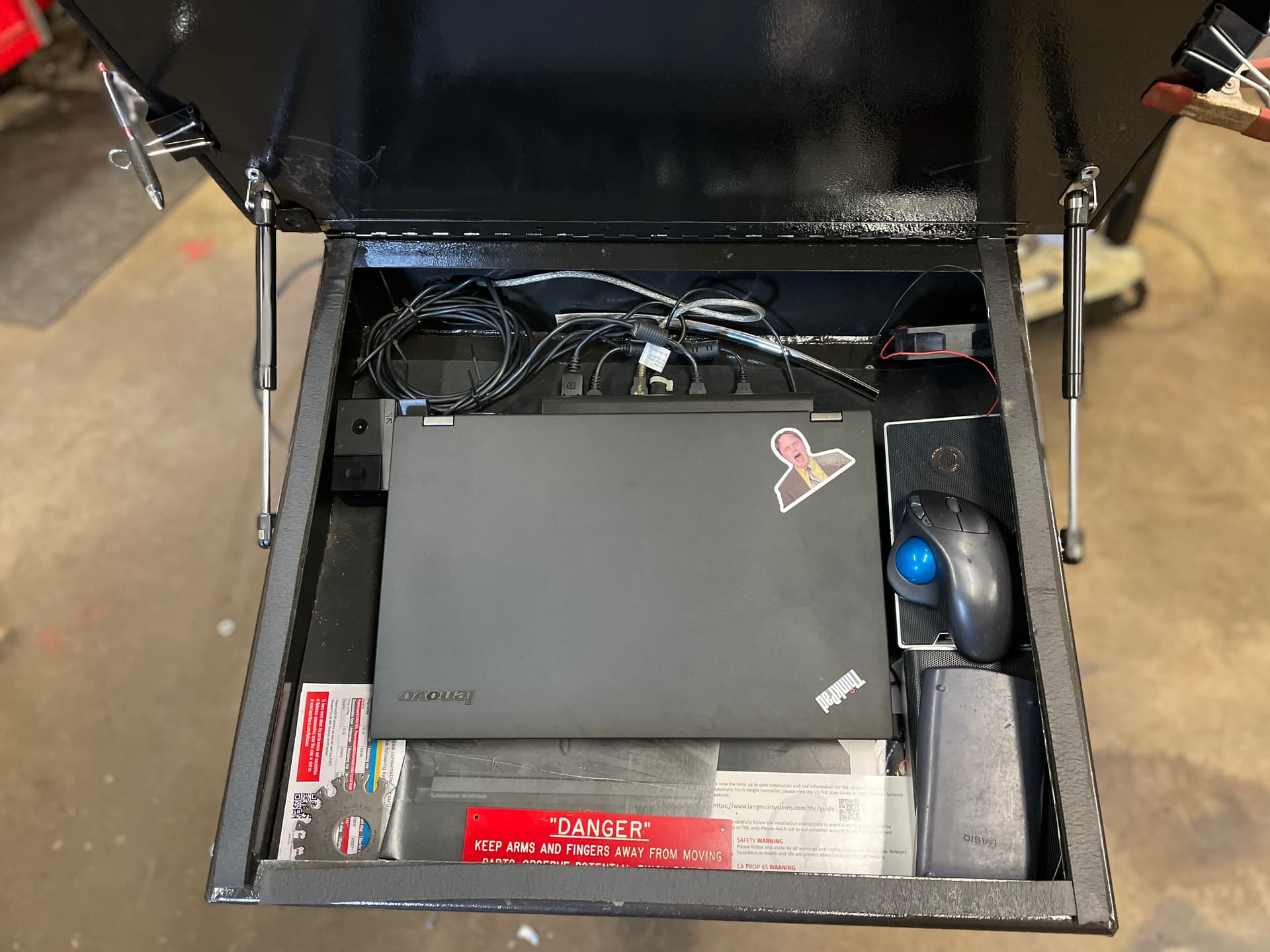

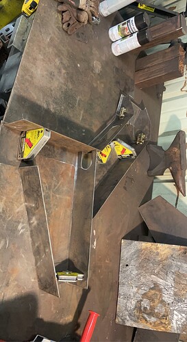

Could we get a few more pic of Laptop stand? I like it.
Nice setup sir, looks similar to what Phillipw has described earlier. How does the magnet do if you wanted to set sheets upright for storage; would it break away easily? Would it be possible to stack lets say a 4ft x 4ft sheet of 1/4" plt without testing out the steel toe boots?
I also have a lifting magnet. Works well. I also have a 6” deep wide flange beam that is 20’ long I am planing to mount to rollers that will attach to the steel pipe trusses. I am working on gathering the parts. Then all I will need is the time to install. I got the wide flange beam free from a previous employer when i was in college.
I did a truss analysis and they can support the Max hoist capacity with a little wiggle room. I may have to use some discretion on loading it up when there is snow on the roof.

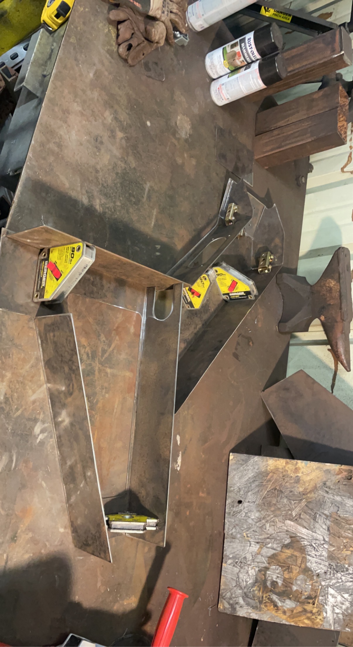

Yes sir, here a few more pictures. The majority of the pieces are 14 ga. mild steel. Once I clean up my sketches, I plan on putting the dxf’s on fireshare.

the lifting magnets need to pull straight as for as using to stand metal upright i don’t see happening. They can break away easy for sure don’t get under it. i do stack metal on top of each other. steel toes definitely a plus.
Here is the magnet I am using. I was skeptical but so far it has been Working for me. I haven’t tested it’s limits yet. And I defiantly keep all my digits out from underneath the suspended load. :stuck_out_tongue_winking_eye:

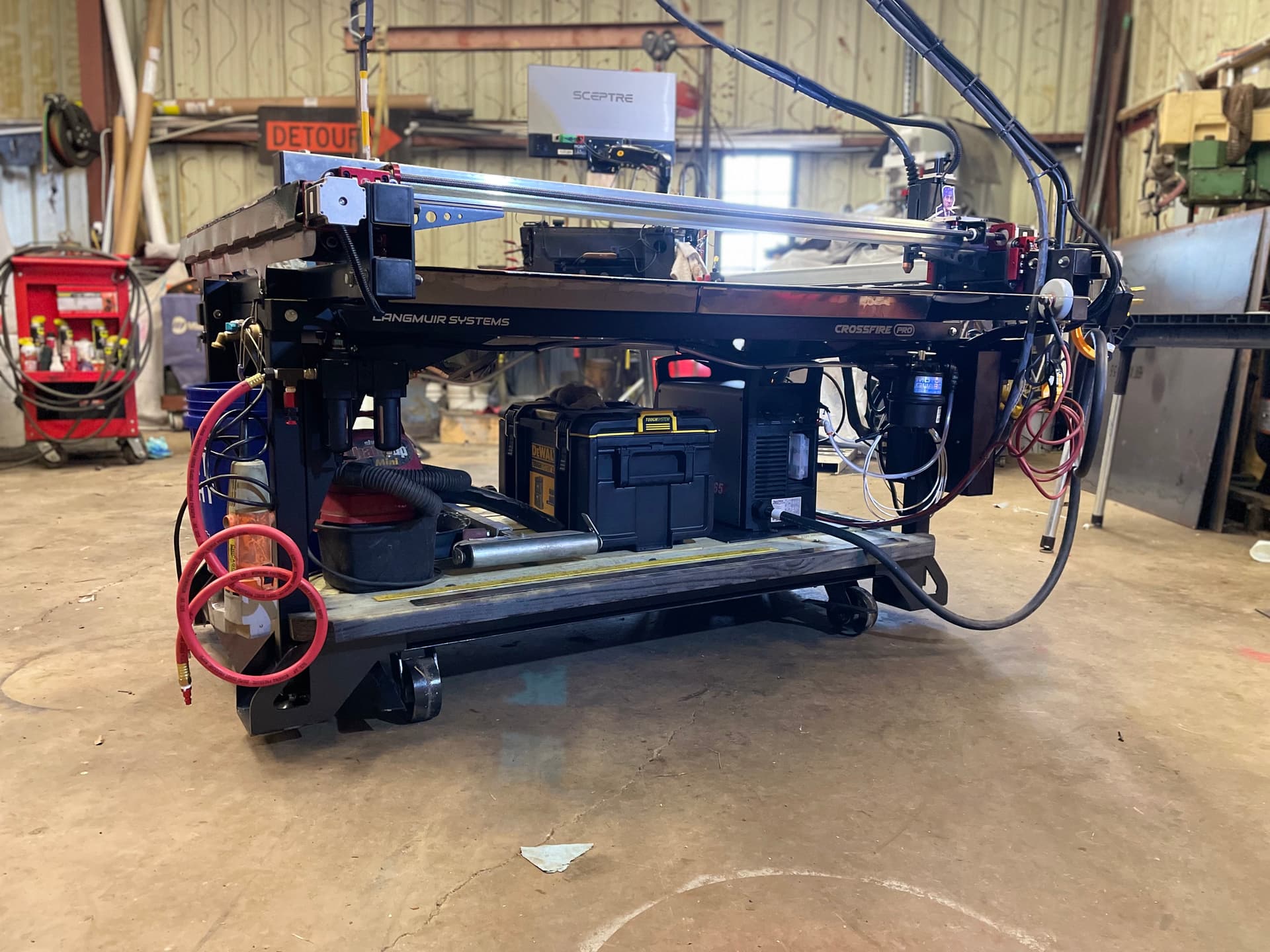

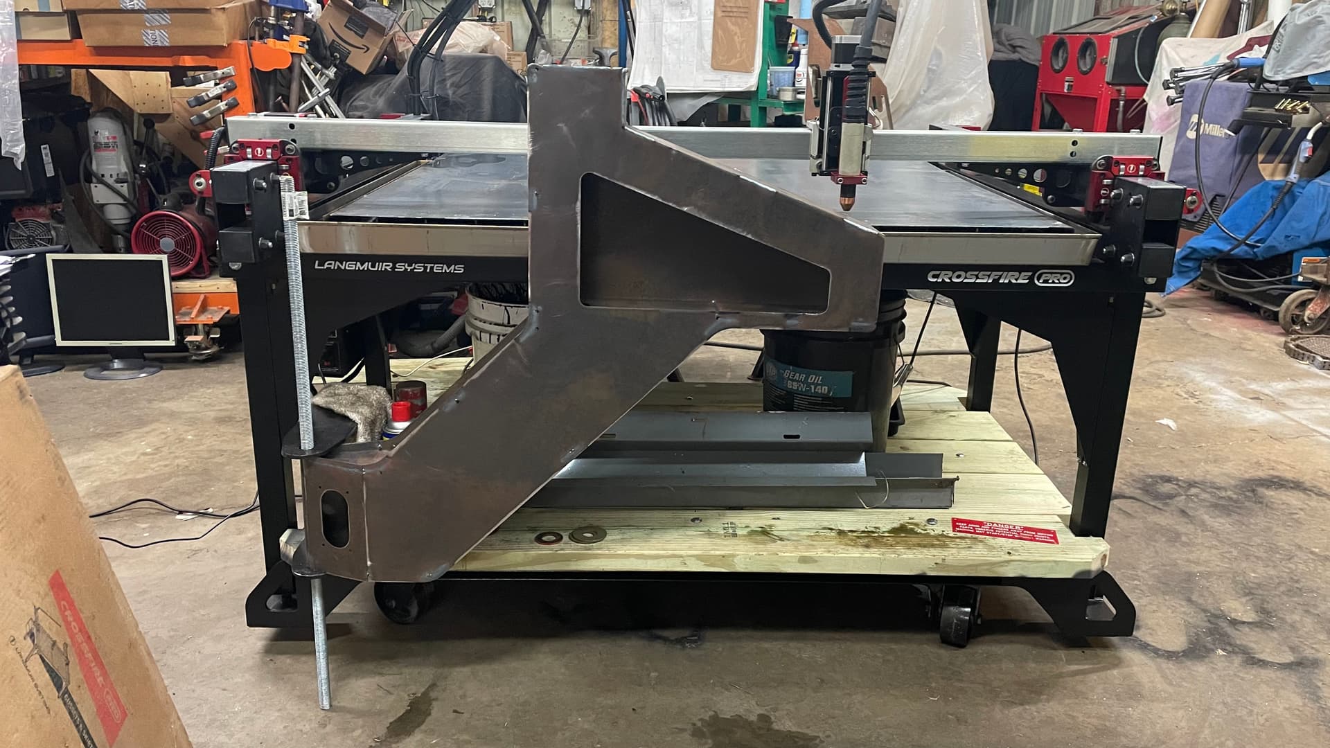

That’s a serious movable platform you made to put the table on! Is that 1/4 plate?

The frame is 2 x 1 x 3/16 bar channel then I used 1/4" plate to make the cradles where the pro’s feet rest. Attached is a couple pdfs for the rolling assy.
Overall Assy…pdf (322.5 KB)
Rolling Assy…pdf (300.7 KB)
