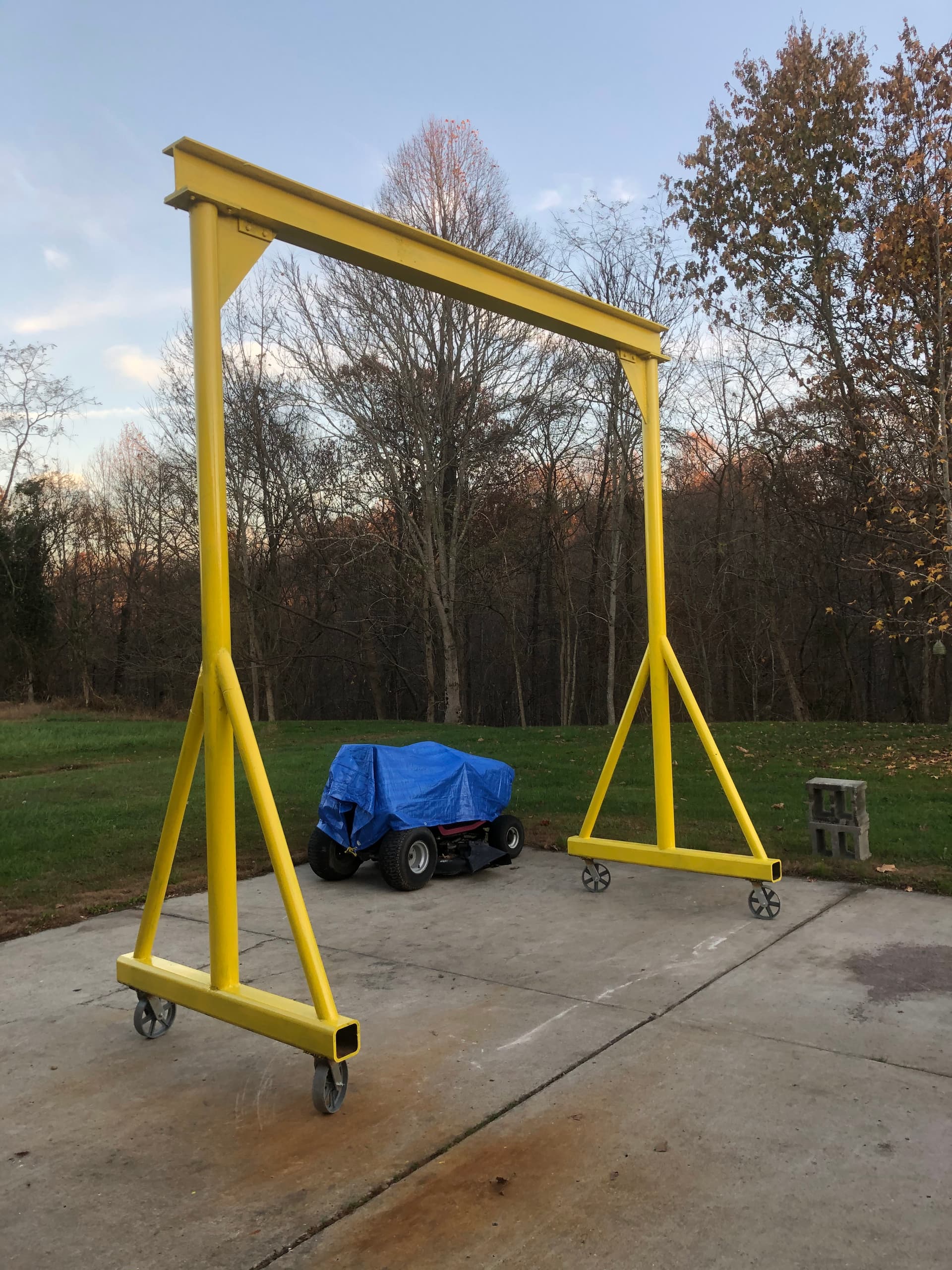

this is what I made to lift metal. I made it from scrape steel from the scrape yard. Used 6" wheel and with the wheels it cost about $200 for the materials.

That’s a lot of steel for $200!
The 6" steel wheels was the biggest cost, the steel for the structure was only a little over $100. The scrap yard I go to only charges about 20 cents a pound and the guy always knocks the weight down.

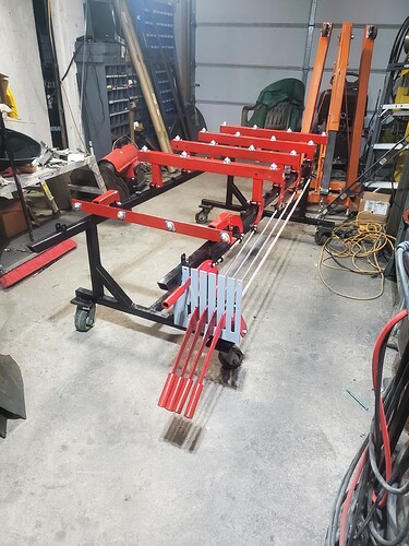

That was the plan but did not end up building it, so I can’t speak on the performance. My thoughts is that it would support (at a maximum) the hangover of a 4’ x 5’ sheet of 10 ga. and 4’ x 4’ of 1/4" plate. Also, with use of magnets on the pads to anchor thinner material to prevent it from walking around on the material.

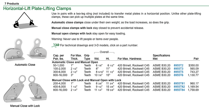

Magnets are ok for flat pics for loading the table however LOAD RATINGS should be looked at carefully. The flex of the plate changes everything. Get the manufacture specs per the plate thickness. load ratings is dependent upon the thickness. NOT rated for picking up more then a single sheet at a time either. We have magnets at my work and I see people drop stuff often. Most industrial sites won’t allow them. Everyone on this site would be better off with clam shell style plate clamps for picking flat. That’s my opinion and I understand that. Here is the specs McMaster gives on some of their magnets for reference. You can see you have less capacity with thinner plate as it will flex more and cause it to pull off the magnet clamp.
Here is a better option since I am being mr saftey today lol.

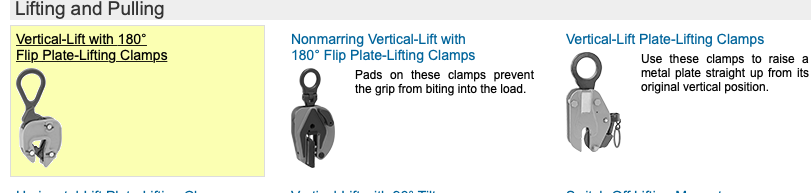

also here is best option for lifting vertical
