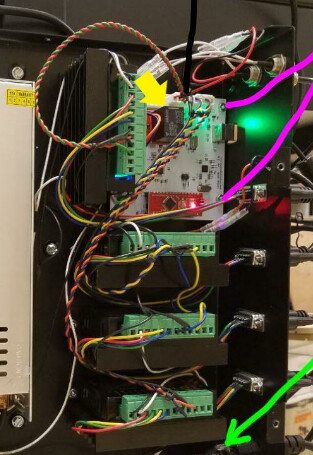

I did go through a standard crossfire electronic enclosure and take pictures of every possible thing and posted on the site here but I cannot locate that topic
Here’s a link to the pictures of the electronics in the enclosure

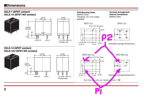

Here is the relay, I believe, but this is a photo from the CrossFire Pro table, not the CrossFire:
You might check the power supply:
Adjusting power supply voltage.pdf (2.4 MB)
In the original Mach 3 system the relay was not plugged in, it was soldered inline with the Torch Control signal from the Mach 3 control board and the contact were wired directly (maybe with some butt connectors) to the torch on/off connector on the panel.
If you follow @TinWhisperer 's link, the photo ending with ‘550’ shows the relay enclosed in black heatshrink.

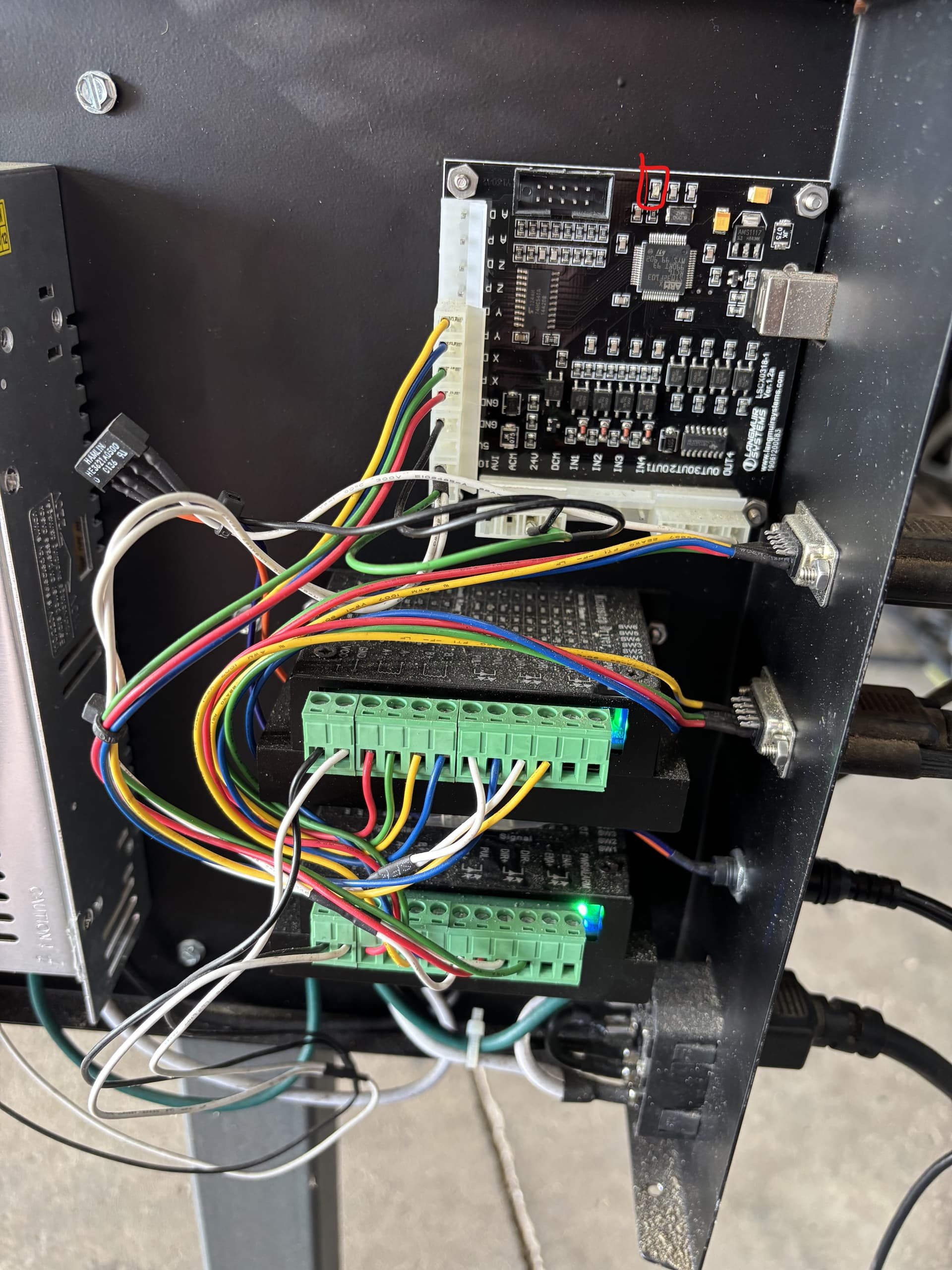

Here is my board, Mach 3 is running the program but no movement on the table or torch fire. I’ve checked everything from the plasma to the table. I’m starting to think its the fire control cable being with a break. Where can I get a replacement cable? Any ideas?

Step 1: When you plug the USB cable into your computer (with the enclosure open), do you get a red (or sometimes yellow) light on your Mach3 control board? That will tell you if you’re connected and getting power to the board.
Yes in the attached photo I get the light circled in red flashing.
as i stated before, did you download and install the other files from the download section for mach3? you 'll need those 2 files in order to control this table.
show a pic of the mach3 screen.
The files need to go into the Mach 3 installation folder, Mach 3 needs to be restarted, either referencing no config file (so it prompts for one) or the CrossFire config file you’ve downloaded.

Well after a long discussion and trouble shooting session with tech support today, I learned my Mach 3 control board is fried. So for just over $200 I can get a entire new control box with the latest Fire control and all my troubles are fixed. So thanks everyone for helping out.
Oh, let’s hope so! There are lots of moving pieces but we shall keep our fingers crossed. Probably not what you were hoping to hear from the tech department.
Let us know how things progress.
or for around $20, you can get another mach3 board from amazon and be back up and running.
Yes, but that was already mentioned. I doubt the board is ‘fried’. More like LS doesn’t want to provide support any more.
Which is weird, in one sense. If you take the percentage of ‘failed’ Mach 3 systems vs failed FireControl systems, there is no contest which requires more support.
