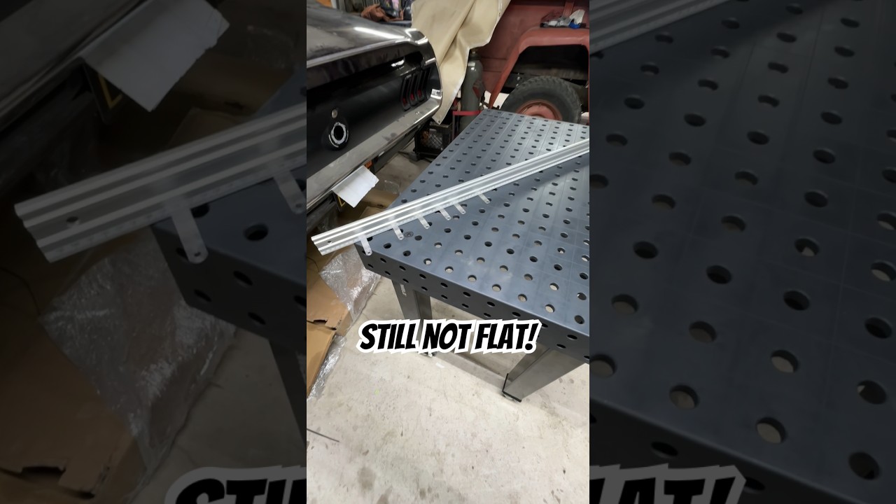

But I guess this is about as good as I’m gonna get:
Regret isn’t a sentiment I’m particularly fond of, but I really should have saved my almost $2,000 and bought a Fireball Table later this year…

One other thing did you ever flip the level to see if you got the same readings?
I would be curious as to how that level checks against a real straight edge. After all you are basing all this on something you have no way of knowing if it’s straight.
Look up and see how much a Starrett straight edge is.

I am measuring these tables with a 50” Powertec brand straight edge that is advertised to be within 0.003”, which I purchased specifically for the purpose of verifying the measurements obtained with my really nice Empire level. The straightedge agrees with the non-magnetic side of my Empire level within about a thou.
One other thing I will say, is that both tables are almost dead flat across their opposite corners; within a thou or two, so even if my measuring devices are flawed somewhat, it’s all relative. That, and one table measures low in the center, and the other measures high in the center. Measuring the same results with the level. Both agree with my mill table as being flat within a thou or two as well. So any error is absolutely minimal.

It’s an interesting thought and something I would certainly do ahead of actually purchasing one. Fireball does seem to very proactively QC their stuff though, in general, where my gripe with both Langmuir and Primeweld is and has been from the beginning that they really do NOT do any kind of secondary QC to their factory.
Fireball’s tables are 1” thick, so I do imagine the potential for warping would be minimal. The one they call “the workbench” is the one I am referring to for $5,000, and it’s a 60x30 that weighs over 1,000 lbs. That’s 80 lbs/sqft, where the Primeweld/Langmuir tables weigh 24 lbs/sqft.
When you think about it, 3/8” is really thin for a casting that is then going to be machined, and expected to retain its flatness under any kind of loading scenario. The Primeweld/Langmuir tables are cast and machined to a weight specification based on a ground shipping limit of 150 lbs WITH packaging. It’s a flawed approach to making a precision piece.
In my opinion, err, rather the conclusion that I have come to…the reality is that these cheap tables are just too thin to hold precision flatness under fixturing use, or even “handling” by an unconcerned shipper.
In conclusion, I do believe that Langmuir probably does a better job of packaging their tables than does Primeweld, and that very well may translate to a better product received by the end user, BUT based on how much my tables move when they’re not perfectly level, I anticipate that clamping uneven material to these thin tables will distort their surfaces beyond what I am already measuring in short order.
I think that most customers who order these cheap tables are really just looking for a “fancy work bench”, and for those types of customers, this product certainly fits a niche (and is a huge upgrade over something like the Klutch/HarborFreight table). It is, however, marketed as a precision piece, and I don’t believe it is actually capable of being that at only 145 lbs.

Prior to posting that “Short” of the new table on YouTube, I had told Mike (my point of contact at Primeweld) that I was still unhappy. He apologized, and based on our previous conversations I do believe he had done all that he was authorized as an employee to do, for me as a customer.
Shortly after posting that last YouTube “Short” to both YouTube and Instagram and tagging Primeweld in those posts, Primeweld’s account commented that I had been fully refunded, and that they were making a slight revision to their design to insure more flatness, and that they would be sending me a new version table as soon as they had one available.
I had already filmed a full 15 minute detailed review video and was in process of uploading it to YouTube when I saw the comment, so I switched the privacy on that video so that it wouldn’t actually go LIVE, and I emailed the viewing link to Mike, explaining this review wasn’t going live, but that I wanted him to watch it, and share it with everybody else at Primeweld who would benefit from watching it. It was titled “3 Reasons Not to Buy [their table]”, and it was VERY critical.
The video was watched a total of 5 times.
The next morning I got a very heartfelt email from Dustin, the owner of Primeweld, who apologized for my experience, and said he agreed with all of the points in my review video. He made a couple counterpoints, but said that they were taking my feedback seriously and using it to help them improve their next batch of tables and their packaging/shipping, etc. He said that future batches would be flat, and wouldn’t be able to get beat up in shipping as badly. He made a point to say that they are treating me the same as they have treated every other customer in the 10 years they’ve been in business, and that they would do anything to ensure I’m happy.
So, anyway, I’m really impressed. My money was refunded, and my feedback was heard, and is being implemented. I’ve always heard that Primeweld’s customer service was the best in the business, and I had experienced it to a certain degree previously, which is why I bought THEIR table in the first place, but they really went above and beyond, in my opinion.
