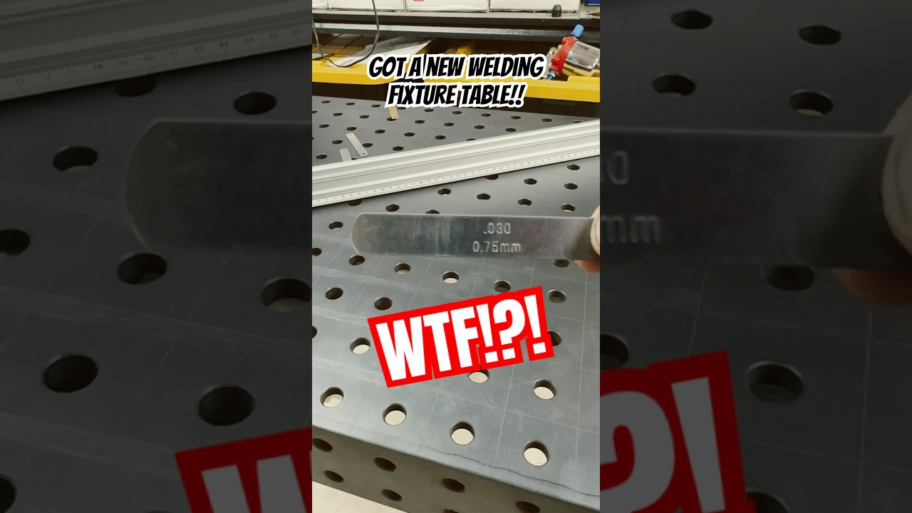

There’s a new (two days ago) YouTube review on the Primeweld table, and it does look like one of the three tables this guy received is almost as bad as my worst one. But the other two seem a bit better than my good one. It’s a bummer that QC is such a roll of the dice on this kind of stuff. +/- 0.0075” shouldn’t be a hard spec to hit for a modern machine shop. I almost wonder if these things aren’t being machined on some type of sled fixture (like wood guys use with a router to surface slabs). Typically with a milling table, you’d end up with a crown if your setup isn’t rigid enough, versus a dish…

I discovered something interesting today. Whether or not the table is leveled makes a huge difference on how flat the surface actually is. Sadly, my pair of tables is still way off even when they’re level, but my good table goes from a 0.020” dish to a 0.040” dish if I put it somewhere on the floor where there’s more weight on those already high corners. Anyway, for those of you that might have your tables on casters with no way of leveling them, it’s something to consider…
So they have adjustable legs? forget about level for a min, can you adjust the legs and get the table flatter?
Those tables are not that big seems odd the legs would effect them that much, seems like the top would be much more stout than that.
Is there any type of cross bracing on the bottom of the table?
Yes they have adjustable feet as standard, and I spent an extra $100 to get adjustable Footmaster casters. And, of course I tried to adjust the legs more to level the table surface; I couldn’t get it there. It seems that they will sag a little on an uneven surface, but I can’t seem to “distort” them any flatter. I was honestly pretty surprised when I discovered it, but it makes sense, because my 10” Southbend lathe is way more stout than this fixture table and if it’s even a little bit out of level, it will start cutting tapers.
Also yes, the back side of the casting is fully webbed, just like the Langmuir table. I guess 0.015-0.020” isn’t that much over 3’, even at this weight.
Anyway, very interesting…

So far they have offered me my choice of a $200 courtesy refund (per $900 table), or to exchange the table tops, once I have returned these back to them. I am awaiting clarification on whether or not they are willing to cover the return shipping, which at 150 lbs per, would likely make returning the table cost-prohibitive for me without a commercial shipping account.

Anyway, for full transparency, PW just yesterday gave me back $200 on my table that had slight cosmetic damage but was very close to their advertised flatness (my choice), and they are going to exchange my really bad table for another one, paying return shipping, etc. There is some concern that they will actually have a table that’s any flatter out of the 5 they have in stock, which tells me that they know they are having some QC issues. They also had to purchase a straightedge to measure the tables they have in stock, but did make a comment about measuring future tables, too…!? The other big issue is that their tables currently ship without any corner protectors in a single layer of cardboard, which I’m assuming is how they are packaged by the Chinese factory; PW says they are “working on this” for some time in the future.
So, my take is that within the next few months you’d probably be able to get something a little better (flatness-wise), delivered to you without damage, from Primeweld. If they can sort these things out, they will have the clear winner in the under $1,000 category. In the meantime, you can roll the dice, and you might (some might say probably will) get a decent table, and even if you don’t, with a fair bit of hassle, Primeweld WILL make it right (they’re good that way), BUT…
If you are buying two or three sections to make a 3’x4’ or 3’x6’ table, then you’re looking at $2,000-$3,000, and for that kind of money you’re awfully close to Fireball Tool’s “The Workbench” fixture table which is 60”x30” and has a 1” thick surface for ~$5,000. After seeing how much these 3/8” thick tables flex when they’re just a bit out of level, it starts to sink in that they’re probably really too thin for any substantial work-holding.
