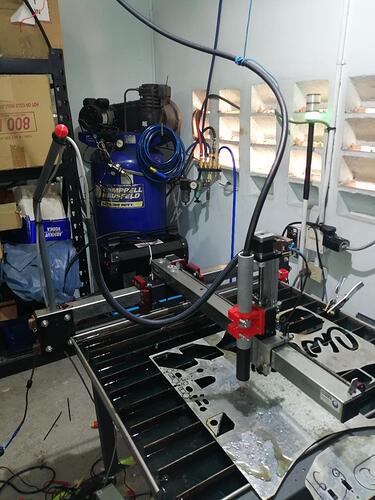

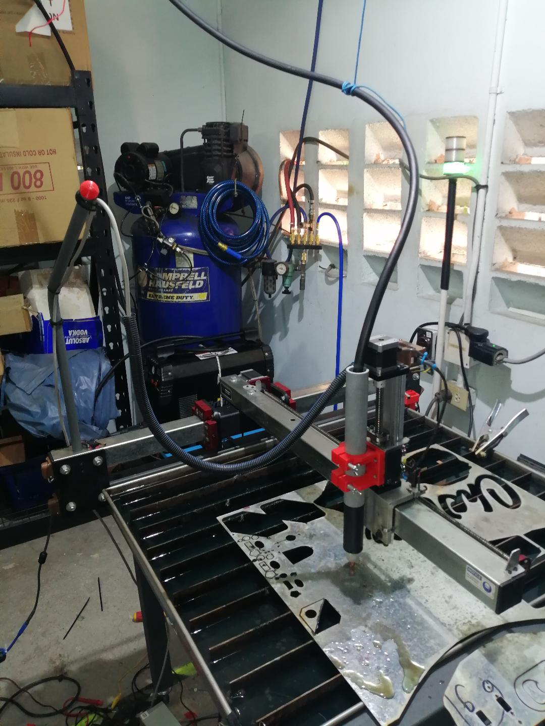

PTM-60 Machine Torch:
I chose to suspend the Coax from the ceiling above dead-center of the table. This seems to work out very well. Z-Axis umbilical will remain on the OEM swing-arm suspension.

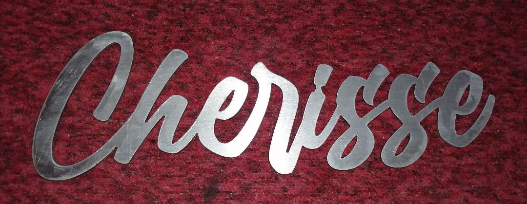

My daughter is in the PR and Marketing business and she was over last night for dinner and saw it work. I had made a name sign for her out of 16guage galv steel. So lots of commercial ideas flowing. She may just convince her mom to let me extend the workshop and get a bigger table if the prospects pan out :smiley:
Get that work clamp off the table or slats and put in on the work piece, please. That will cause bad cuts as well as false reading for your THC.
What font is that? It stitches together nicely or did you massage it?
https://www.dafont.com/billion-dreams.font
Required very little massaging. I’m no artist, so I’m always searching for fonts that will not need much work.
Copy that on the work clamp George, thanks.
