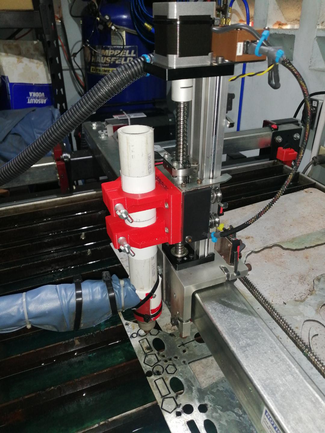

I made a hand-torch holder from Schedule 40 PVC pipe and attached it to the z-axis last night.
Going in a bit to collect the machine torch. Shipping MIA to Trinidad + duty and taxes US$43, not bad I think.
