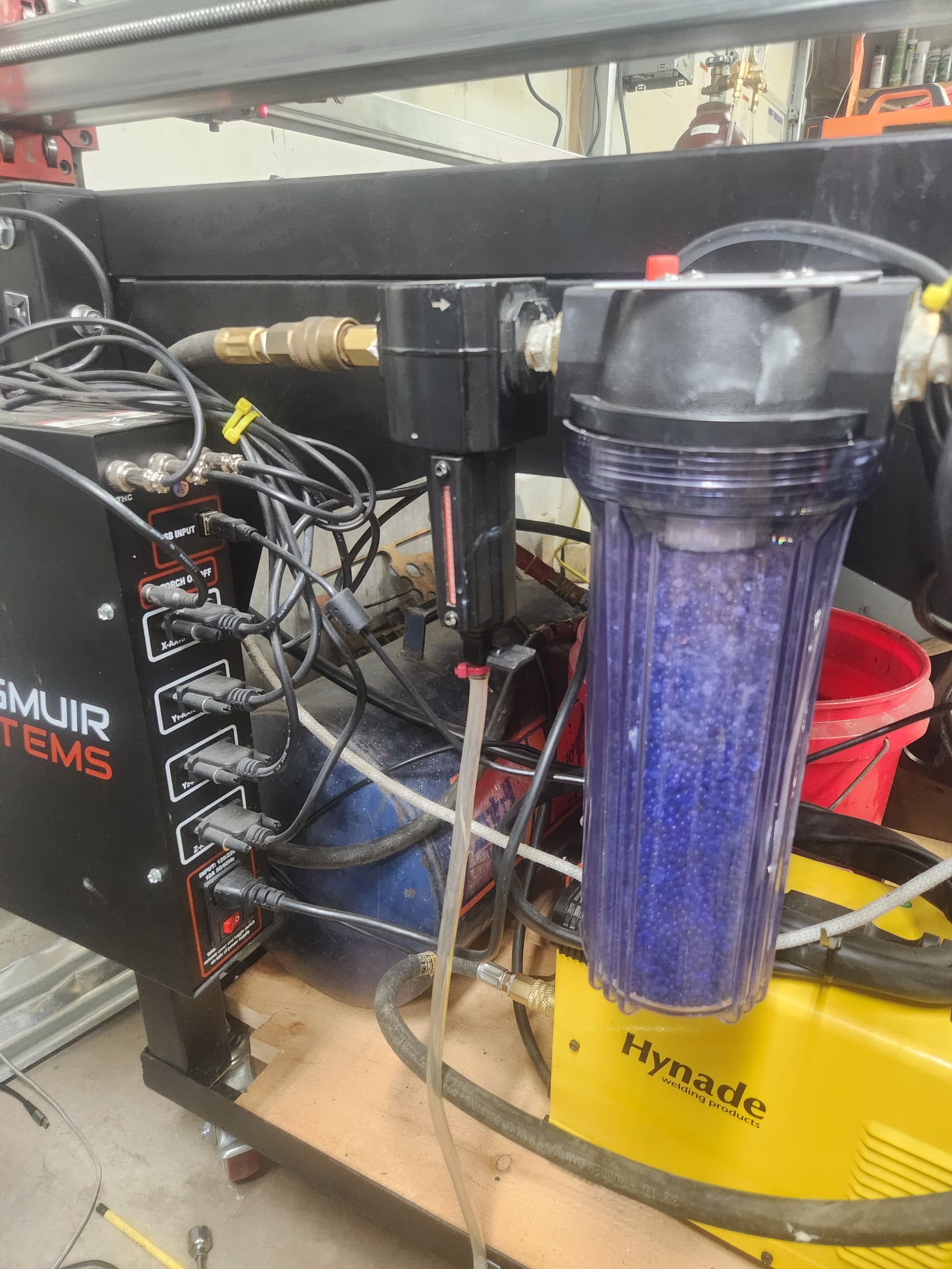

Now that I have my computer issues solved, I’m starting to think about air systems. Of all the variables, this one seems to be the most critical. Read all I can find on the forum so I think I understand what I need; my question relates to manufacturers. Been cruising Amazon and find there is lots to choose from.
If we are allowed to critique specific makes, what brand seems to work, not necessarily the best, but perfectly functional, without having to take out a second mortgage.

Buy yourself a Motorguard filter, and place it just before your plasma cutter.

Many people use transmission coolers as an after cooler - yes it’s extremely common.
You’ll get better performance out of it if you can run an aux fan on it, but just the cooler itself helps many.

Read this thread. I have read every single post in that thread. Tons of questions and testing. Like Kwikfab said most people do the aftercooler. Questions is before the tank or after the tank? All explored in that thread. What I have discovered is at a minimum you will need 2 solutions. If you get an oil water separator you will also need a motor guard or desiccant dryer. If you do and after cooler either Cooper tubing or Transmission cooler you will also need a water separator..
My system worked fine for over 2 years with just a 2 stage Nanpu water separator. Last 3 months I have had all kinds of anomalies. I now have a transmission cooler, 2 stage water separator, and a motor guard filter. Getting the hoses together to get the transmission cooler installed. Most popular one is a Derale 15300. I just got mine on amazon 2 days ago for $71. says cheapest price in 30 days. My 2 stage Nanpu was $74 (2 years ago), I just got the Motorguard M-45 kit for $101 (last week). I’m going with flexible braided stainless steel hoses. I want to mount the cooler on the wall to avoid the vibration from the compressor some people have had there inlet or outlet break due to the start and stop vibration from the compressor. I using flexible hoses because I suck with cooper and I want some flexibility in location. If you just a hose you need one that can handle well over 300 degrees. Many air compressors the outlet form the pump is right at 300 degrees. I hope some of that helps. I got luck with a few low humidity days and was able to finish up the rush cutting I needed to get done

Bottomline like I said above. Build an air dryer system with at least a cooler (derale or copper tubing) and water separator at a minimum. The Motorguard is going to be a third line in the system. Or go with powered air dryer/refrigerator unit.

  1. Trans cooler works well. It is intended for fluid to air exchange. More money you can buy one for compressed air. Both need a fan to be efficient. I myself use a trans cooler but want to upgrade.
  2. Absolutely please reconsider the house water filter as a desiccant filter. Your not saving much if you consider the risks. At least contact the manufacturer and get them to sign off on the use.
After my compressor and under the table I have another portable air tank which is just a pass through that adds additional capacity and water falls to bottom then out of that have a HF water trap then a water filter housing with 1 inch pvc pipe with multiple holes drilled in it and wrapped in fiberglass cloth replacing the filter. Fill with dessicant. Been running all hot humid summer amd haven’t had to dry the dessicant yet.
I have an Ingersoll Rand refrigerated dryer, which I installed on the air compressor outlet line. That dries all air going anywhere in the shop. Then, I have a Motorguard filter which is only for the plasma cutters. I have zero issues with moisture and get very clean cuts and excellent life out of the tips.
