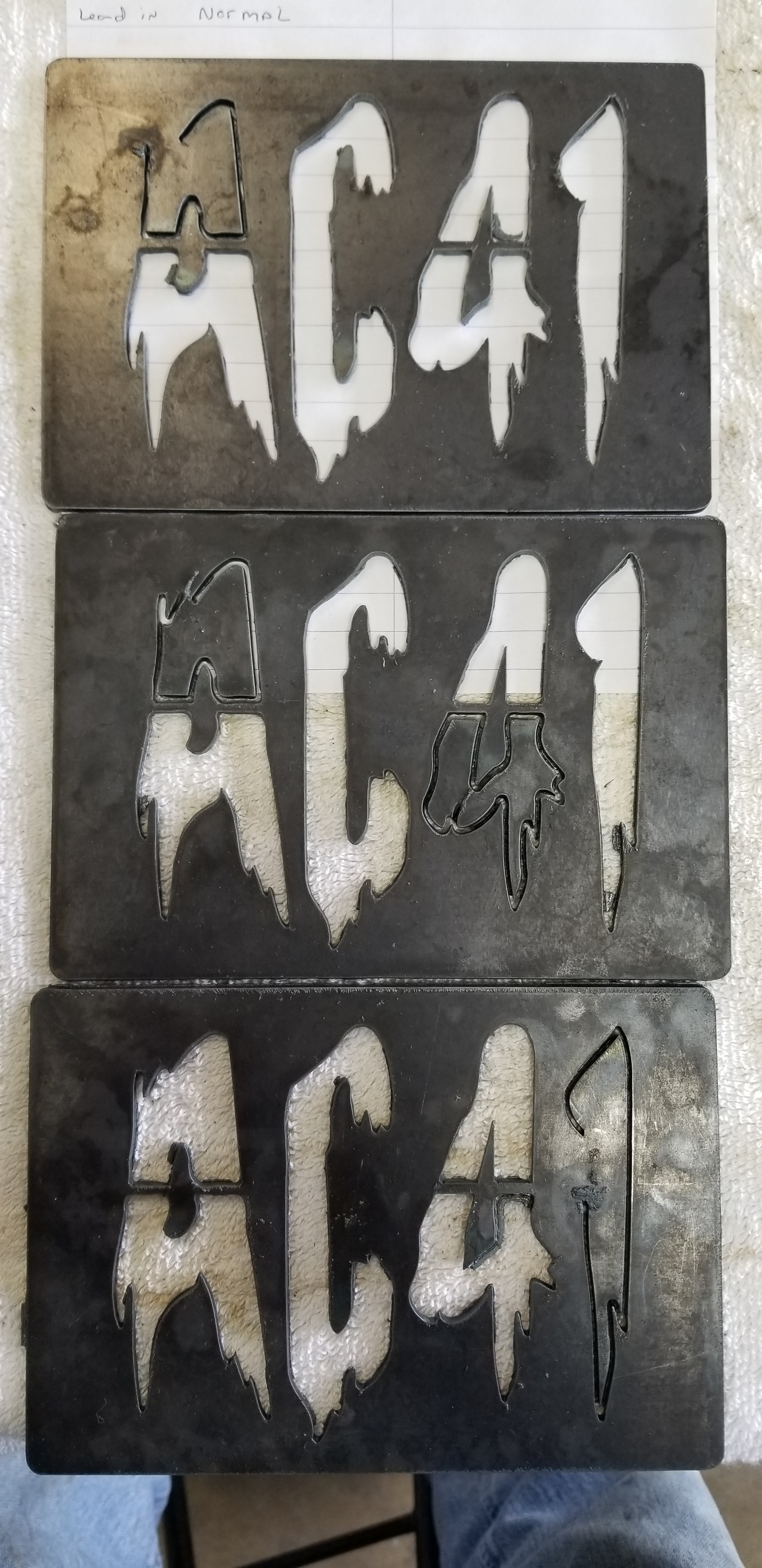

Can someone help or donate some brain cells?
I keep getting random no cuts on my design, torch doesn’t fire over different letters on different cuts.
Crossfire XL
Primeweld cut 60 (60amp consumables 0.045) cutting at 35amps/55psi
14 ga plate
90 IPM
Pierce delay 0.7s
Using Sheetcam with outside offset
90 IPM
reverse cut direction
Lead in Arc 0.15s
ground clamp directly on the steel plate
I can change pierce delay and lead ins, amps and IPM but still getting the same issue.
I can go back to lead in points in Fire Control and finish the missing pieces, just wish it would cut it all on the first pass.
Help is appreciated.
Check the condition of your consumables and orientation of your swirl ring. Once or twice I had a cut not start properly like that and it was a problem with the consumables.
No guarantees, but it’s the first things I’d check.
Laptop or desktop computer? If laptop try unplugged from power. Make sure you have a USB cable to the control box with multiple ferrite chokes to cut down on electronic interference.
Using the Primeweld cut 60 with the IPT60 torch, the swirl ring on that torch can go either direction, on my 3rd set of new consumables.
It’s a laptop using the USB cable that came with the table, unplugged the laptop, ran the design 2 more times with no luck.
you have provided great information…except one I think might be important…might…
Air…how dry is your air and what size of compressor are you on…?
it almost looks like you do not have enough air to finish some cuts…
@toolboy why you gotta bring up my compressor??? :smile: I intentionally left that part out cause I didnt want that to be the first thing jumped on… yer killin me smalls.
Air is dry, I drain the tank every night and have 2 dessicant filters plus the one installed inside of the plasma cutter.
Harbor Freight special. 4CFM @90psi 27 gallon tank, when the tank is full I can cut the entire 4x6 design and the compressor never comes on.
It could still be an issue but this is a pretty small and simple design.
Torch doesnt fire over the letters/numbers which are cut first but the outside cuts perfect everytime, I would think if I was running out of air it would not fire on the longest cut…

Are you setting your air on the plasma cutter by using the “air test” switch and getting the correct PSI? If so increase by 5PSI.

I had water in my lines… < going to hide under a rock now :angry:
