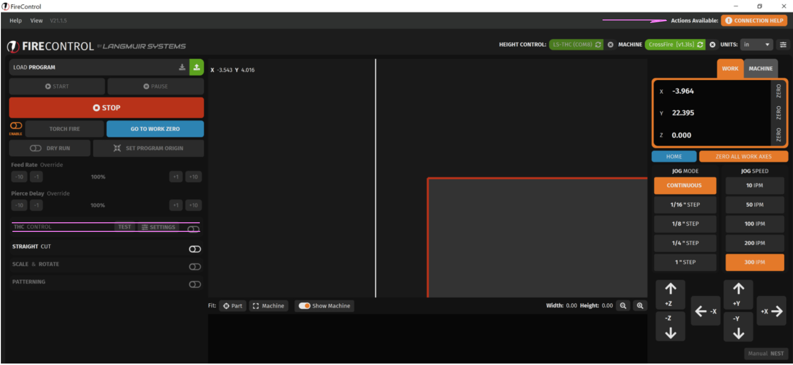

Here’s a picture of what I see:
As you can see, the radio button to toggle the THC Control to be enabled is grayed out, and there’s that connection help in the top right corner. When I click on that, it shows me the error that the orignal OP mentioned (I tried ti embed it, but being a new user I’m only allowed one picture). I’ll see if I can reply again and post it.
I can enable and manually fire the torch, so that part works, and I can jog through the break in program. Everything but the Z-Axis appears to be working.

It looks to me like as the error dialogue says your firmware is not working correctly. Did you reflash the software on the THC as it suggests? The greenbox should include the firmware version just like the machine green button.
The other thing I might do even before the reflash is to reseat the THC module on the main board.

well it’s definitely not working so I would reseat it and then call @langmuir-reilly as you may have a bad THC module. It is definitely not interacting with the main board as it should.

Re-seating didn’t work, so then I proceeded to re-flash the firmware, which I can’t tell if it did anything to the actual module, and then I manually uninstalled the drivers using the installer with the USB port unplugged, and then re-installed them. I then plugged the USB cable back in, opened FireControl, and it had the same issue. Not sure if there’s some sort of additional application logging in Event Viewer or some sort of file based log with more data in it? I spose I can try to find another laptop and test on another machine.
P.S. - Good to know regarding what you said earlier, where in the green it should show the firmware version. Definitely not showing that, which makes me think that the re-flash attempts also probably had no effect.
I would say the THC module is no good. I would open a ticket with @langmuir-reilly and get their take, they’ll probably send you a new module and my guess is your problem will be solved. Unless they have a way to force the reflash that we don’t know about. It seems like the hardware part is communicating but no software is running on it. It’s interesting that it doesn’t error out during the reflash.
