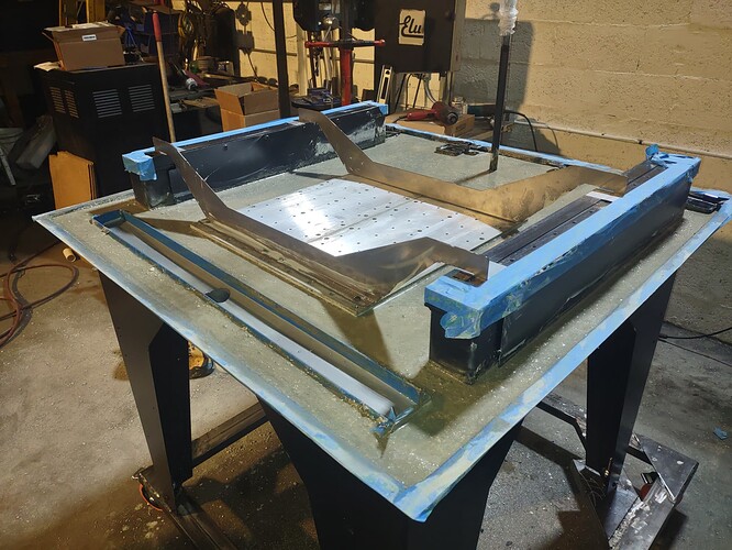

We are getting ready to pour concrete and there is some of the tools we will be using hopefully we’ll get the concrete in on time and you can sit there for the 5 days that’s required
We only got to use seven out of the eight bags of concrete something is slightly off
Well this is all we could do for now hopefully we can get back to it next week
Looks fine, but why couldn’t you use the 8th bag? I see a lot of space left.
I made my concrete level with the drains and the epoxy is a little above the drains.
We have seven bags in and had to scrape some out due to when we inserted the table it was going over onto the table and it was too much .Lots of it is down to the drain that we have has taken up a lot of space but seven bags is what we can get in well six and a half bags really we couldn’t get the full seven bags in but what would do now wait and see how it turns out then put the epoxy on it later on

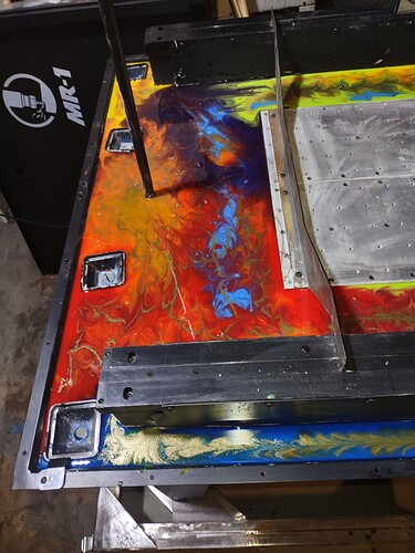

This is the brand of epoxy we used one and a half gallon in total
Yep we went straight to the other side and showed our feminine wilds all over this
And there is more so many things you could do to cover concrete fancy floor coverings with fancy colors
Don’t judge us it’s the Florida style
This is what takes place when you think outside the box grown men acting like fools
