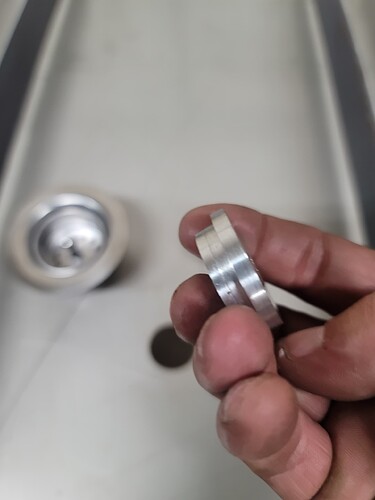

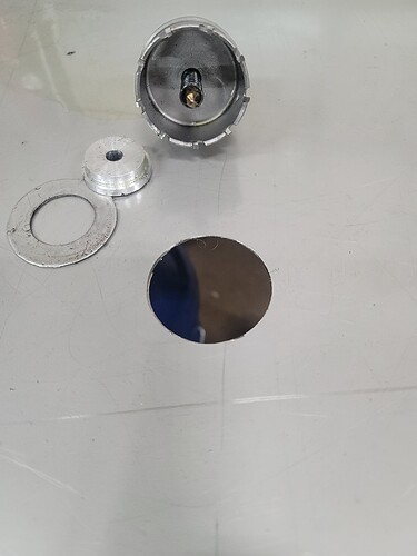

Turned a simple drill center guide out of aluminum to drill out the stock drain hole. Made things easier and faster since my table was already installed in its place.
Dies showed up today - Man these things are slick and produce a really nice dimple - Got both holes done in a couple of hours. Most of that time was doing test pieces since I had to change hole saw size from what I planned on using to what I actually ended up using for the drains I choose.
I also did something similar to @mnicolia and drilled through the old drain plug as a guide for the hole saw. I did end up pre-drilling the hole in the plug on the drill press outside of the drain just to try and get it as straight up and down as I could before putting the drain assembly in the pan. Then just drilled straight down, worked perfectly. Then just a quick light clean up with a small sanding/flap wheel and deburring tool then center the die and a few uga dugas later I was done.
I mentioned I was going to try the stainless drains from Home Depot (linked above) - Before I drilled the actual table I did several test holes on a scrap piece to make sure I got the size right. These drains seem to have a more gradual radius on the flange so with a 2" hole they wanted to sit proud of the dimple. Stepping up to the 2 1/8" hole saw corrects this, but the dimple die will not self-center itself since there is so much play with the larger hole. After a couple of test holes, I was able to figure out how to line up the top die so it was mostly centered and then use a sharpie to draw a circle around the outside of the die. Then I could see if it shifted at all when I was tightening up the bolt. Not a perfect solution but I got pretty solid results and the drains do seat well.
