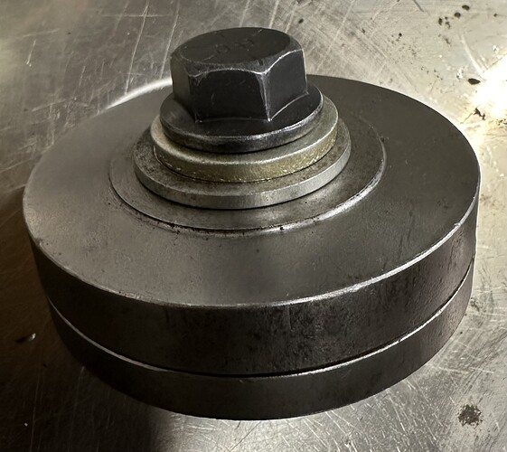

I was going to drill a hole in that tonadd to the washer stack. But decided to get the package tonthe post office and mailed out

I think the bolt was stretched, I didn’t trust it and the washers were pretty beat up I added a grade 8 flange bolt and HD washer, it seemed like a good upgrade. Lick, you might want to add some grease to the bolt and washers, I forgot.
If you are using the hole saw guide in the kit… use a 2” carbide tipped hole saw.

Has anyone tried this die on 14ga SS by chance?
I would like to be added to the list.
The die will not work on 14ga. There is not enough clearance between forming faces. At best it would damage the die, worst it would partially shear the pan.

Ill be sending the dies to grimjim42 monday. They worked perfectly. Impact gun 15/16 socket and wrench and oil everything well. I also used the harbor freight hydraulic knock out tool. I purchased the bar sink basket strainers from Lowes. Thank you and it was pretty interesting seeing all the notes that came with the dies.
