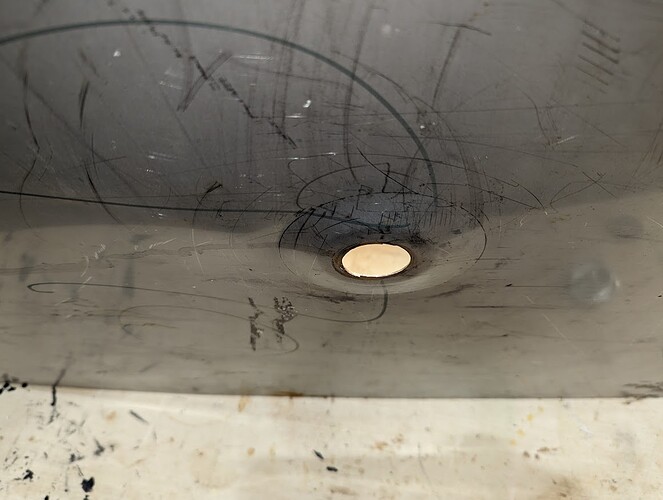

Bar sink drain dimple die
I recently set up my machine. I had an old bearing/seal puller for a washing machine in my tool box. I used it and a backer (a large socket would be perfect) to form the dimples. It worked like a charm. Below is an Amazon link to the $20 puller if anyone is interested.
