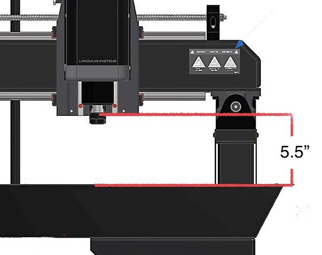

The problem I’m seeing with the rack style holders or any ATC designed to be fed from the rear of the machine, is they have to clear the carriage which is fixed at 5-1/2”.
A low profile ISO20 tool holder is 3-1/4” from collet to pull stud. A low pro ISO/BT30 holder is 4-3/4”. So the gantry needs to be raised significantly for the 30 tapers or your tool bit lengths when using an ATC will be limited to 3/4”.

I went and measured the machine and thought about this some more.
The real issue is the height of the lower Z axis, which is 5.5" above the table as @BrianS said. This is 3" deep front to back. The spindle itself can be installed to have the ER collet sit in exactly the same place as the stock MR-1 spindle.
It’s not ideal, but one solution is to run two racks of tools, one on each side of the machine. With slightly over 3" spacing each of these could hold at least 5 tools (probably 6) for a total of 10-12 tools. Obviously I’d be giving up X space, but the machine has ample X space so that isn’t a huge deal (at least for my needs). Keeping chips off of the taper will be a challenge on it’s own.
A one inch riser also gets maximum tool stickout to close to 2" using the shortest toolholders, which is totally reasonable.

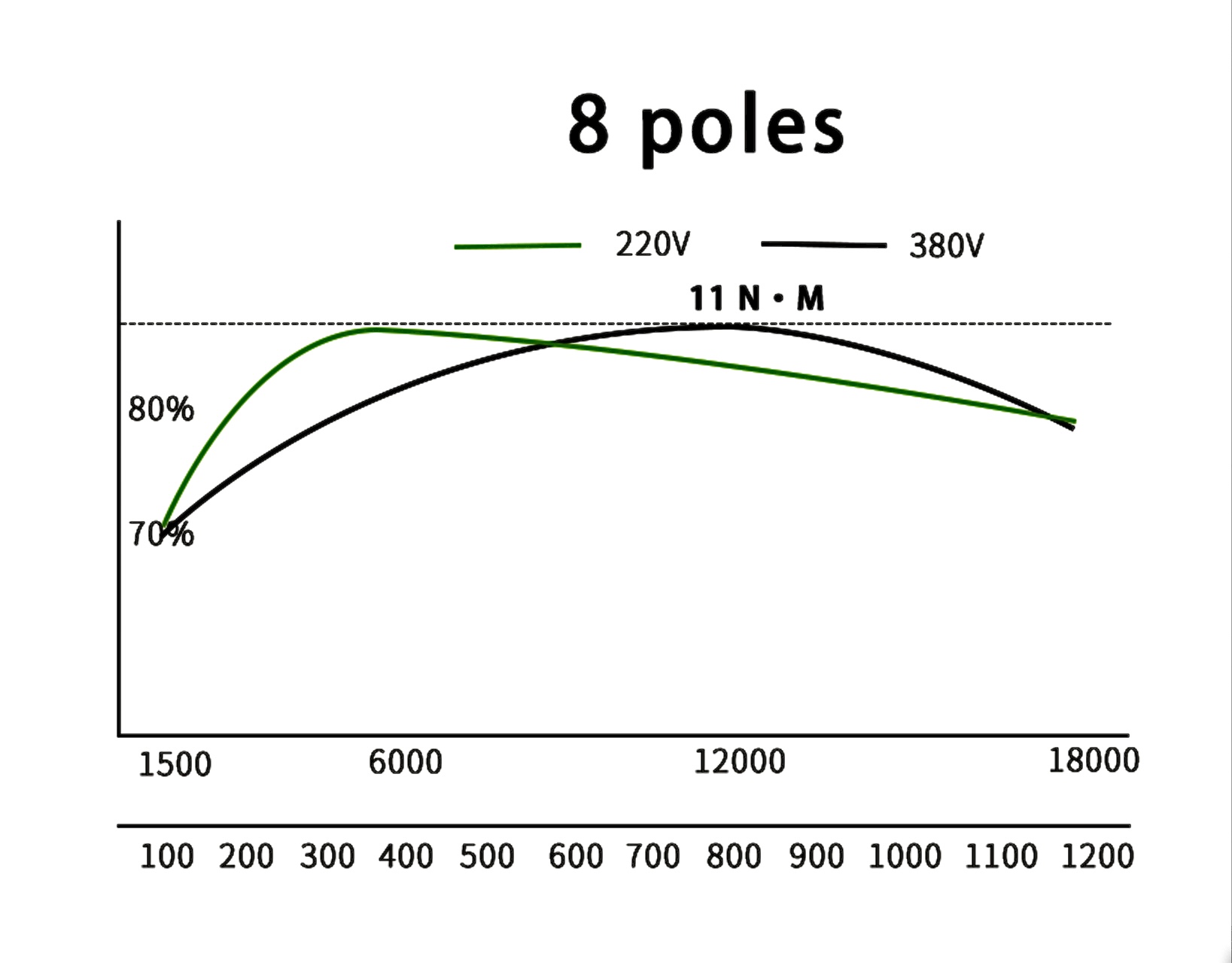

Torque on the mechatron ATC-8022-30-HSK25 is awfully low at under 1nm. Are you thinking of another model?

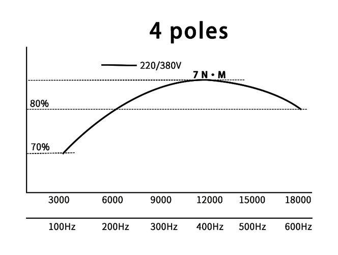

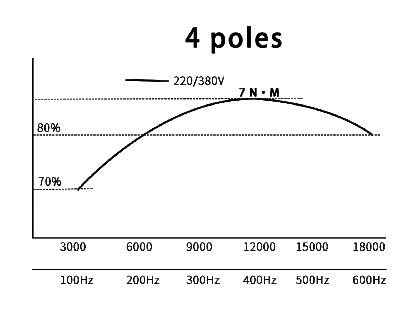

Spinogy X22 is the best HSK25 option that I’ve seen, but ends up at over $6k. They offer it with a 4 pole motor which gets about double the torque. You can also get a 3kw motor for even more power.

How about an imported 5.5Kw ATC for $1300?
Also comes in 4 pole but no 220V line drawn.
Saw a 3Kw version for about $800.

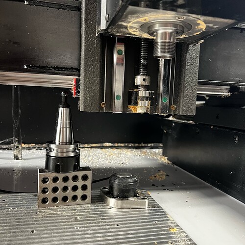

I got a couple of ISO30 tool holders to play with while I wait for my spindle. I’m standing them up on 1/2/3 blocks to show height with a 2 tool stickout. The 5.5" height clearance isn’t a big issue really, the height that matters is the distance under the gantry which is more like 7 inches. If I’m willing to give up 2 inches of Y I can put the tool rack along the back edge of the table along with the tool setter, and allow the gantry to pass this area over the tool setter. Here is a photo showing how that works:
This gives just under 16" across X for tools, which I think will allow me to have room for 6 of them.
Another option is to put them across the front of the machine, ahead of the table. I think that will allow for 7 or 8 tool holders to fit. Here is an example of that, and you can see that the tool rack would mostly be over the epoxy (losing minimal Y). The nice thing about this solution is that it would be easy to change tools, the downside is that it would reduce access to the vise because I’d have to reach over the tools.

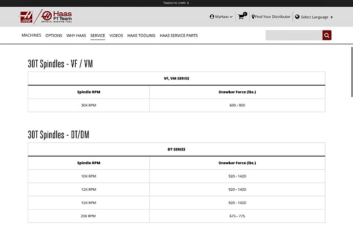

No clue as to how powerful of a motor it can handle. Deep groove bearings (not angular contact) of unknown material, tolerance, and size with 5K top speed. Taper runout stated 20-50 microns, so what did he expect? Pull force Q wasn’t answered but based on the spring stack it’s probably the same or less than the Samurai 120 which is #225 I think.
A 30 taper needs #920-1420.

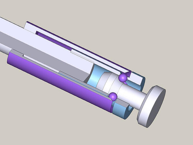

The problem with these much higher spring rates is you would destroy the spindle bearings using a pneumatic cylinder to compress them. You need something similar to a floating piston caliper used for car brake rotors to compress from both ends of the springs so you don’t transmit excessive loads to the shaft. Which is how Tormach does it and they use (16) 40mm dia. Belleville washers to get adequate drawbar force.

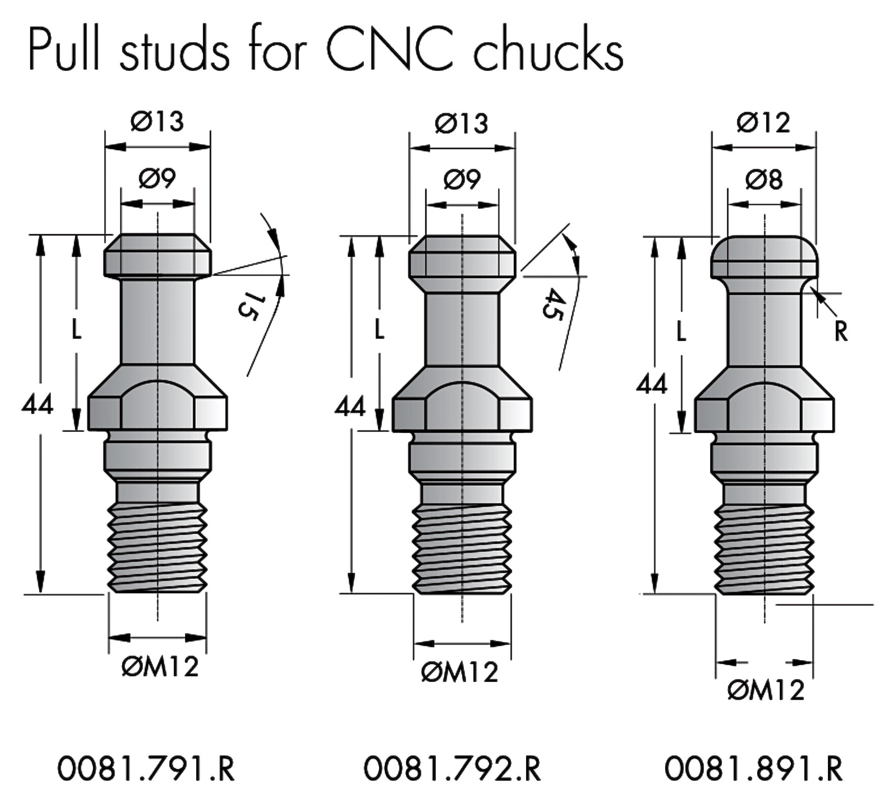

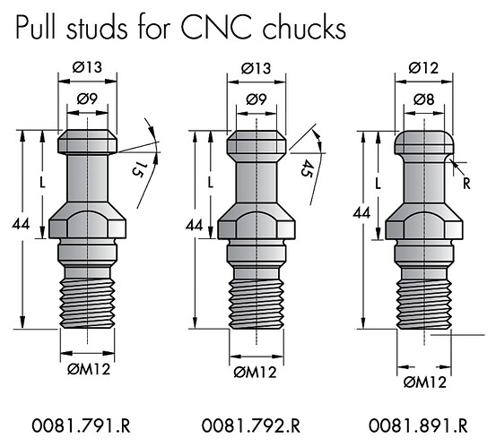

Also if the ISO tool holder is from Amazon like mine, it probably has the pull stud with a 3mm radius. They have to be compatible with the spindle’s stud puller whether it’s a 15/45/90 degree gripper or the ball type.

CNCDepot spindles use the concave radius style of pull stud, and that’s what my sample ones came with.

All the commercial spindles I’ve seen use the gripper style puller. If they make a gripper for the radius style stud I haven’t come across one yet. The ball stud pullers look a lot easier for a DIYer like myself to make.
