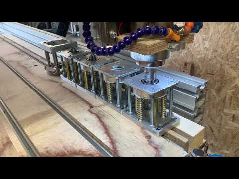

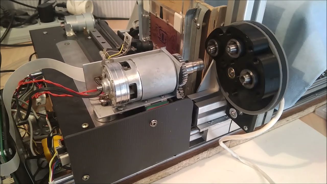

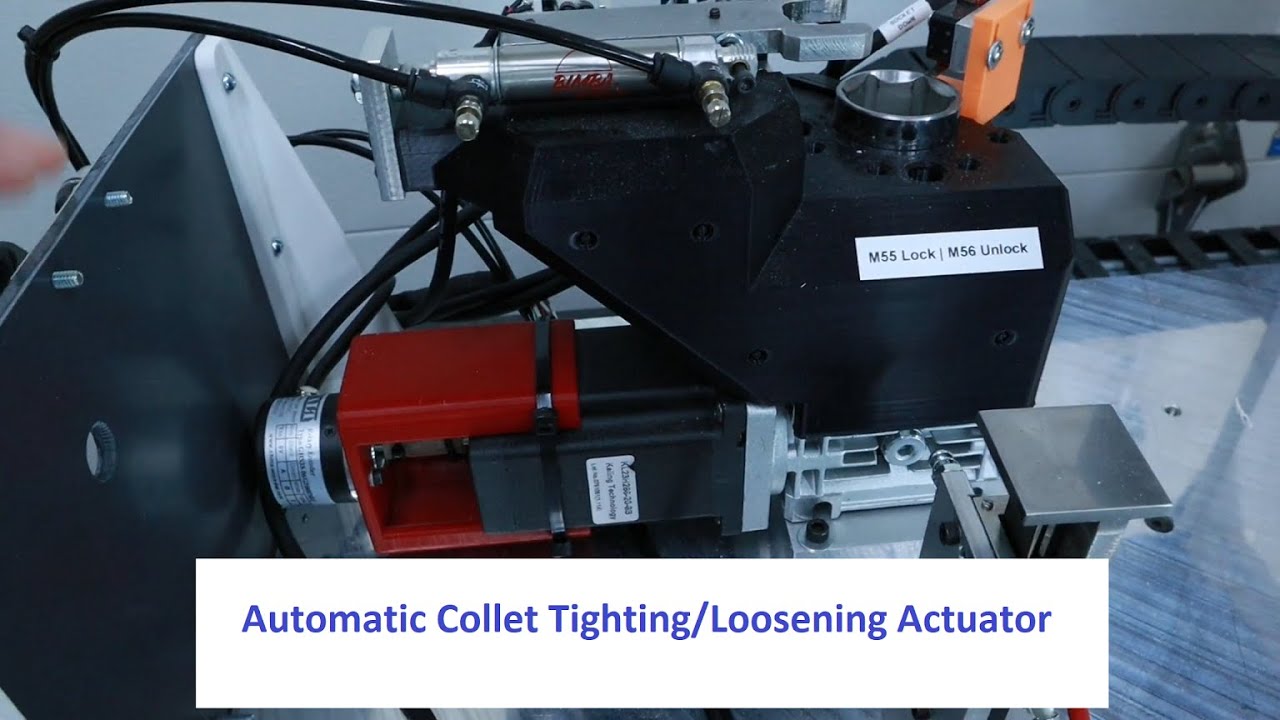

I’ve seen multiple versions of collet swappers on YouTube. Like the Rapidchange arrangement, the first 2 require a motor that turns both directions.
The next 2 don’t appear to need a reversible motor but the designs are far more elaborate.
