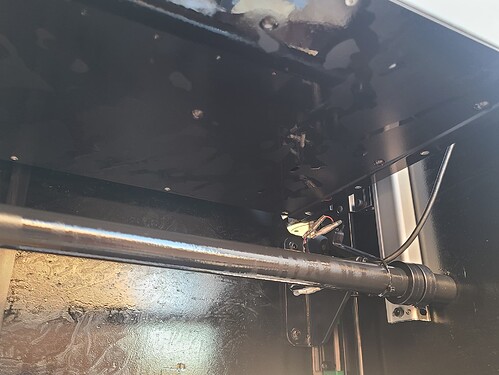

I just received my machine this past weekend and was less than impressed with some of the quality, fit and finish types of things I saw. Some were related to shipping issues (Something was stacked on on top of the machine at some point) but more disappointing were the things in Langmuir’s control. I will be mounting the back gauge system this week hopefully I have better luck there…
Missing Hardware to mount the machine to the pallet.
Leaked what appears to be a significant amount of hydraulic oil.
I bought the 110v to 220v optional transformer the box was soaked in oil. Luckily the transformer was packaged in a bag as well.
Had to disassemble the transformer to fish out the nut that had fell of at some point.
Only one cribbing block was still in the machine.
Seems like by now they would have that oil leaking taken care of. I would think they would send the oil in a jug and let the customer fill it.
They do seem to be struggling to get the problems resolved.
Hopefully the brake works as it should
Thanks for the feedback. If you have any photo evidence of something getting stacked on top of the machine, could you send it to me? It would help us process any possible claims with ABF.
The hydraulic fluid leaking during shipment is something we have solved but in cases like this where the shipping damage is significant I can see it popping up again. Those blocks are usually very aggressively hammered in there.
With how much leaked out, you should check your hydraulic fluid level. It should be at least 3/4" deep - we fill it to 2" so more likely than not you should still have enough. When replacing the expandable plug make sure to keep it relatively tight before you try re-inserting it - it is very easy to slip and lose in the tank if you keep the twist cap on it completely loose.
