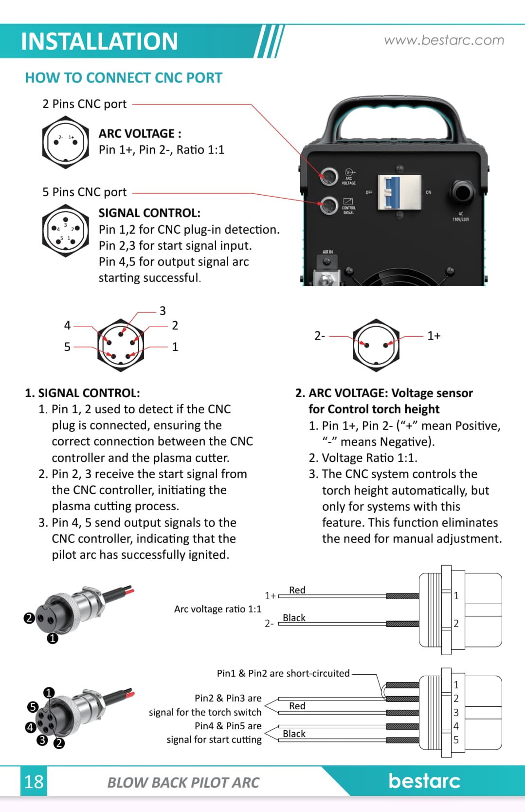

I was looking at the manual.
In the CPC port there are pins for “CNC plug-in detection” I’m wondering if these pins will remove that delay or enable the torch to fire during the delay? It doesn’t say it directly in the manual but I can see that being one reason to have the CNC detection pins.

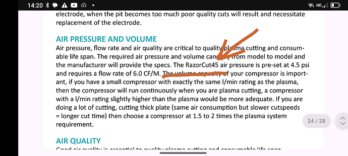

Also looking in the manual it appears that they might be copy and pasting some text out of other manufacturers manual and not proofreading before publishing. :joy: :joy:
Ha! Good catch. I looked at those connections but expected to see an input for those in the Firecontrol so it could read when the torch is ready.
