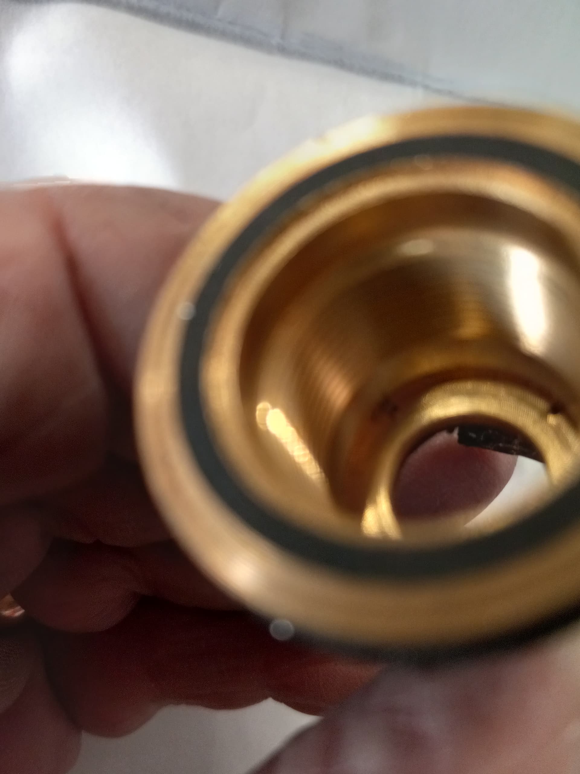

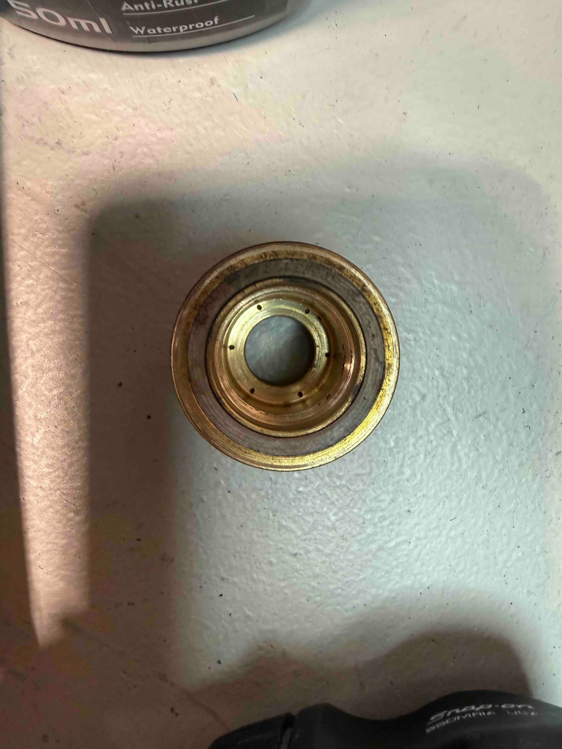

Sorry a little late to this thread. Did you ever change the retaining cup on the Bestarc? I was wondering if you have the wrong one on it. It will not re-fire until post flow stops. The retaining cup must have 6 air holes in it to disperse of the air, if it only has 4 holes as in the picture it will not re-fire. Just something I have seen in the past.

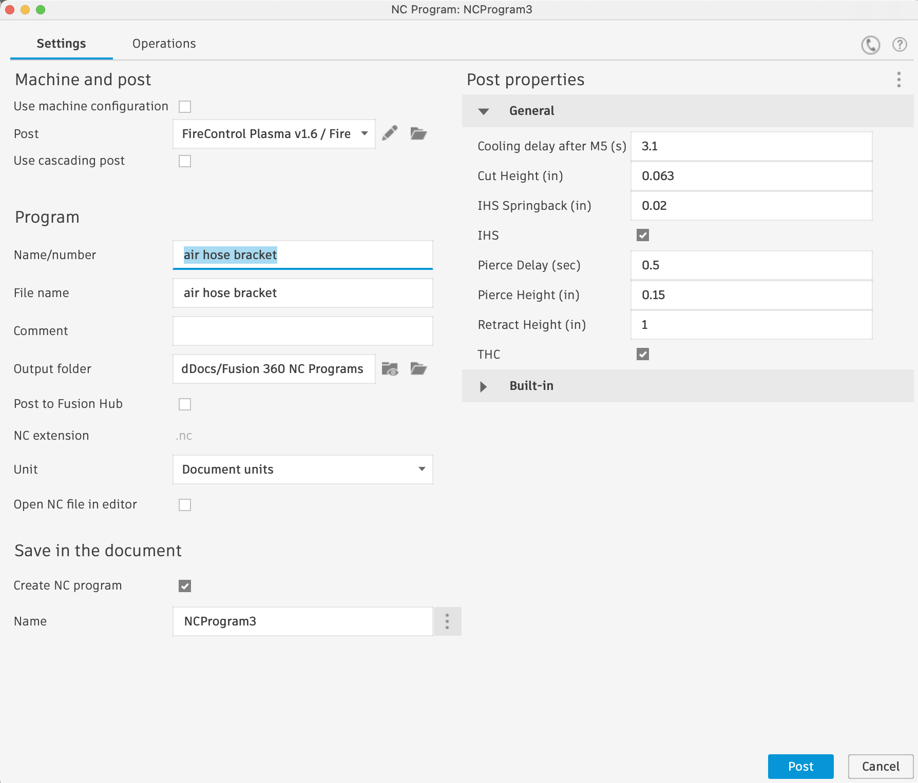

I found a way to add the delay to the post-processor file. It appears I cannot attach a .cps file. I’ll have to share another way? Here is an example of how it changes the post-processor screen. Also, I will find the link to a post where I shared how ChatGPT helped create this code.
Here is the other post. Bestarc BTC800XP and CrossFire Pro - #15 by Tobias .

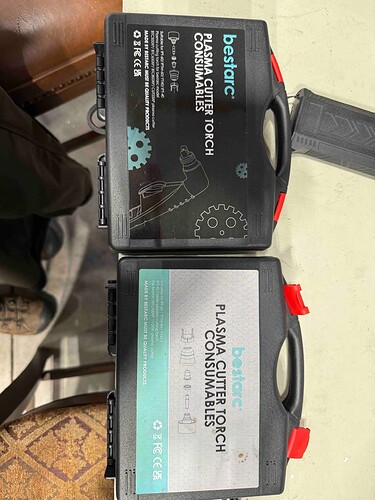

There are a few other things that most people don’t know about the Best Arc BTC800XP. First, the IPT60 style torch is only rated at 60 amps. Second, the consumables are not for a IPT60 torch they are S45 style and only rated at 40 amps. So you have a 80 amp plasma cutter with a copy 60 amp torch and 40 amp consumables. I bet support didn’t tell you that as well.
Explains why I go through consumables with this Bestarc kit like butter on good French bread (no holding back). So, looks like I have six holes in all my existing retaining caps. I have two consumable boxes. Contents are the same, but one says it supports the 800xp :wink:. Guess marketing fixed that.
Well at least you have a 6 hole cup. Now all you need it to get a 80 amp torch with good consumables to make it work right.
