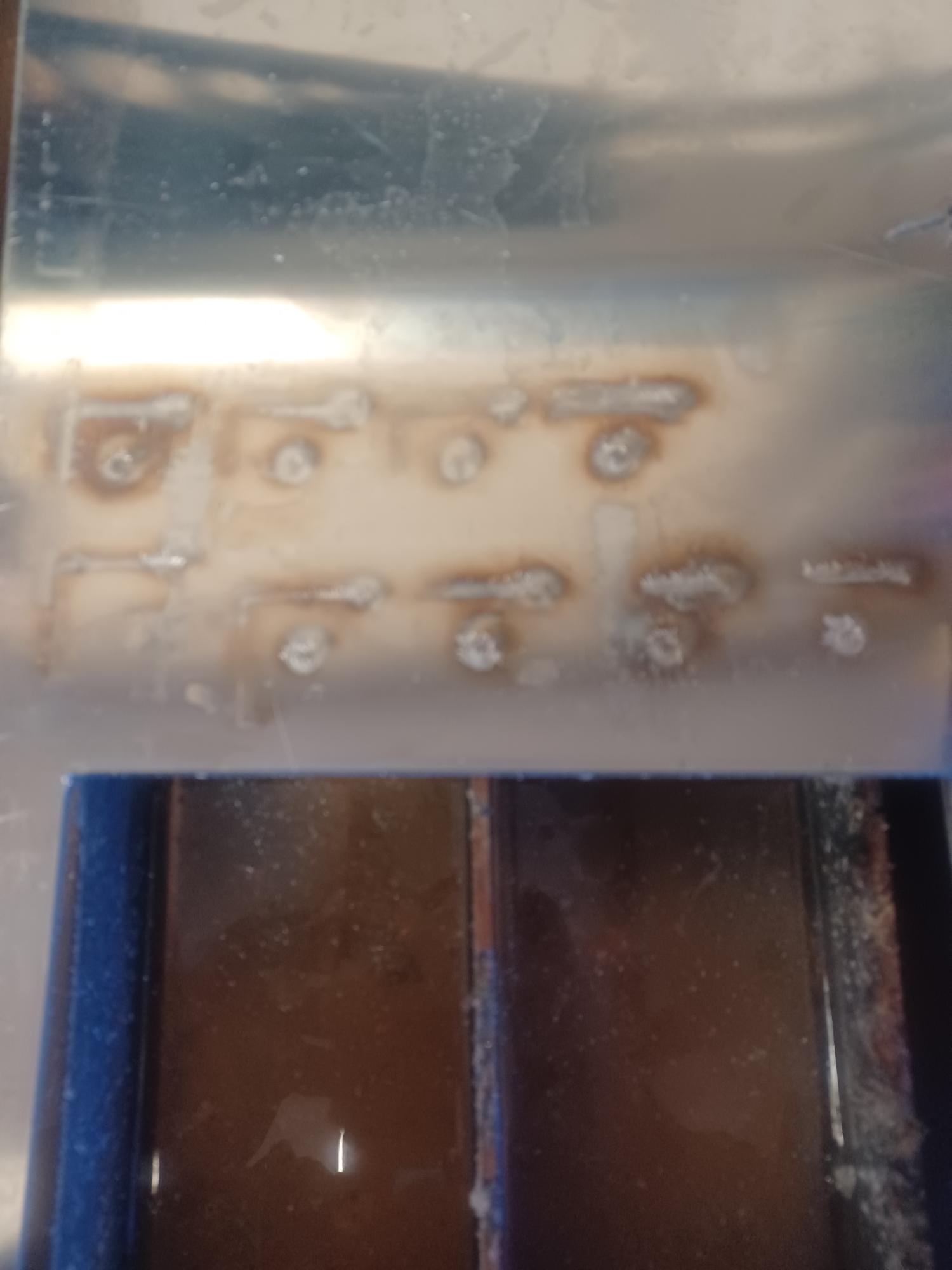

I’m having issue with cutting into 1/8" Aluminum with a Crossfire Pro. I use SheetCAM as my application. I am fully self taught, so I’m sure I made a few mistakes. Here is what my cuts are looking like.
I’m using a Razor Cut 45. Here is my settings below.
45Apms
65PSI
Here is my SheetCAM plasma settings that I use.
Kerf Width: 1.5mm
Feed Rate: 80ipm
Pierce Delay: 0.6s
Pierce Height: 3mm
Plunge Rate: 10ipm
Cut Height: 1.5mm
Pause at end of cut: 0.3s
I’ve successfully been able to cut 1/16" with the same settings except at 100ipm instead.
I would lengthen your pierce delay, start at 0.7 and go up till you get a good pierce.
Also, I think I would speed up the plunge rate to 50 ipm
Only adjust 1 parameter at a time so you know the results of each.
As @72Pony stated for your settings. Also up your air to 75PSI and turn off THC. If that works then you need to get the THC working properly.

Unfortunately increasing the plunge rate has only made the cut worse. I’ve also tried increasing the pierce delay but that doesn’t seem to be helping much. I’ve turned off the THC

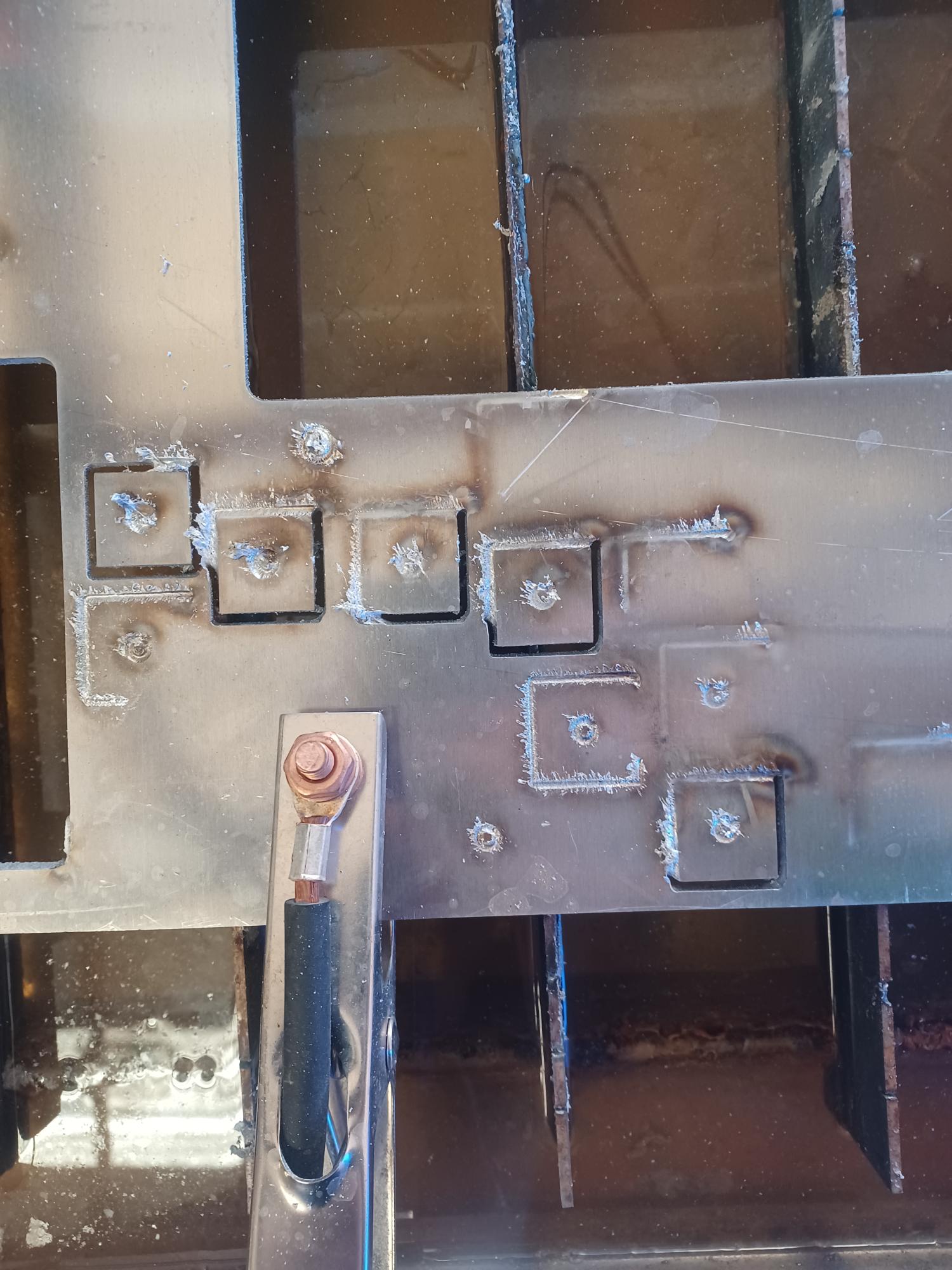

However my cuts are only getting worse

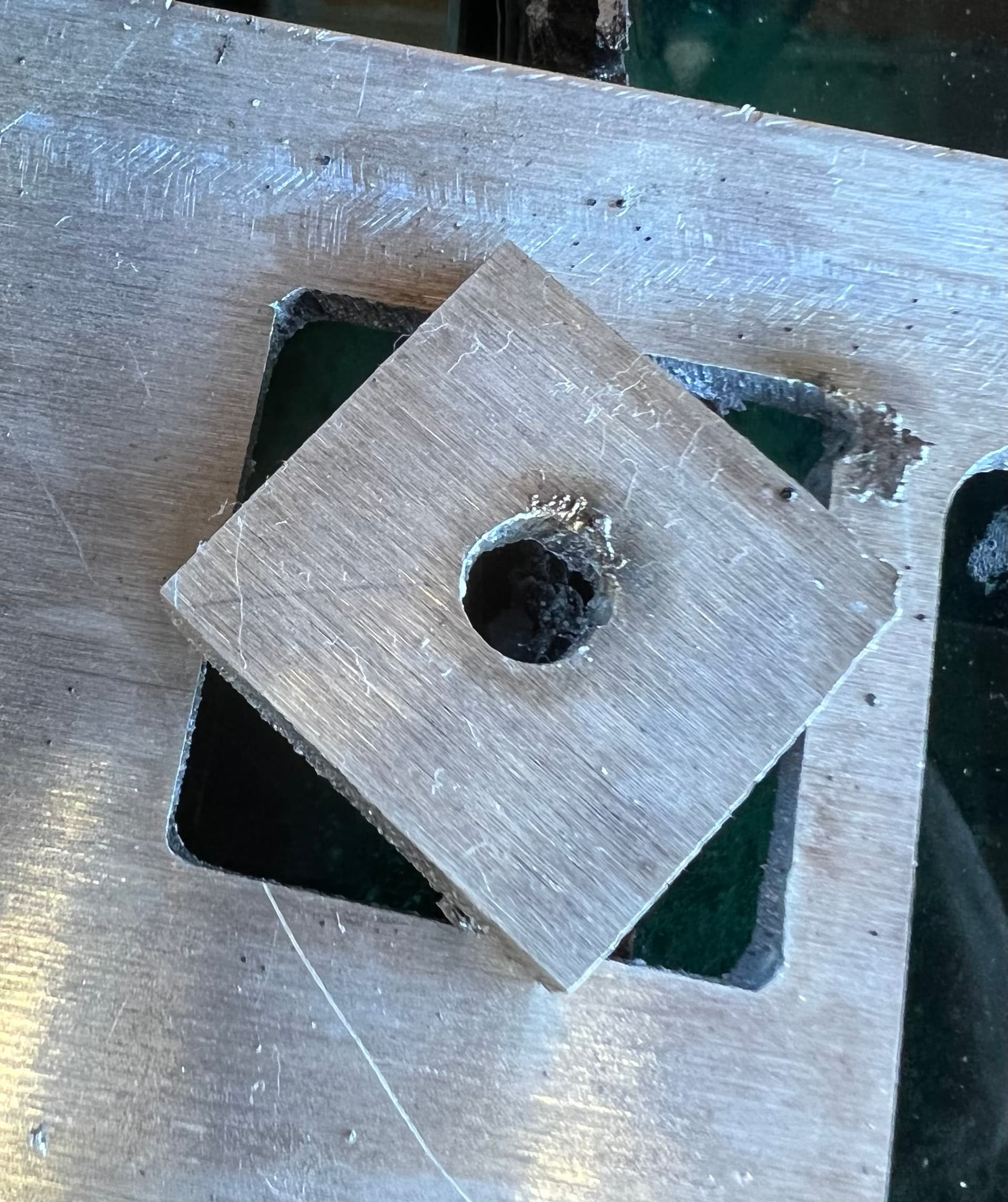

Ran your code (1st post) on my machine. 45 Amps with a PrimeWeld Cut60. Ran ok with exception of the pierce height that @ds690 already mentioned and there is no lead-in or lead-out which made gouges in hole and top right corner. These parts are tiny, surprised it did that well on the hole (≈0.23"/5.8mm)
You may need to look at your setup, air supply and consumables.

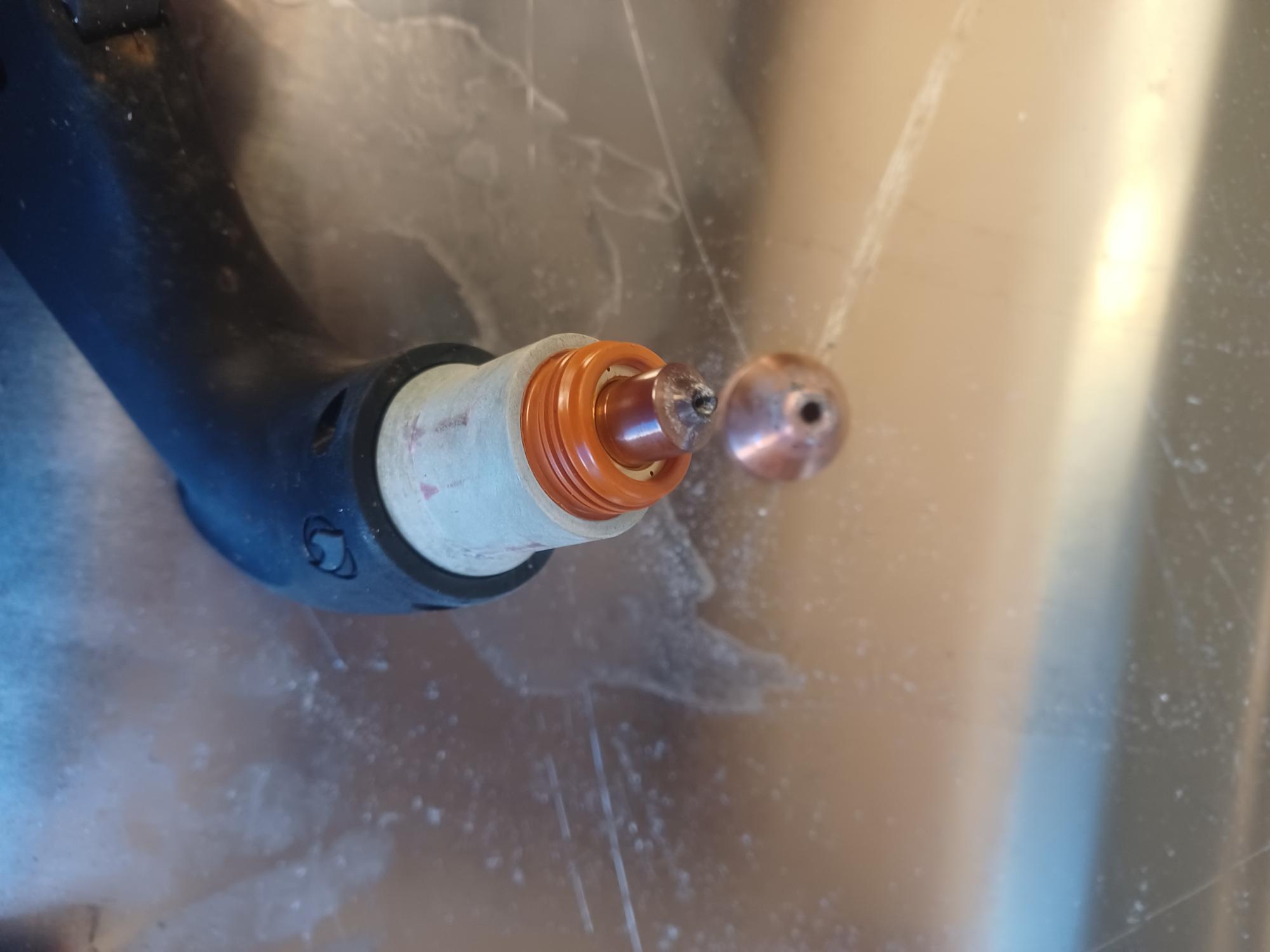

think it might be an issue with the nozzle?
What do your consumables look like? Does the arc look green? That’s an indication that the electrode is trashed.
it’s a little melted
The nozzle looks bad, but it’s hard to tell from that angle. The more important thing is the electrode that is under the nozzle.

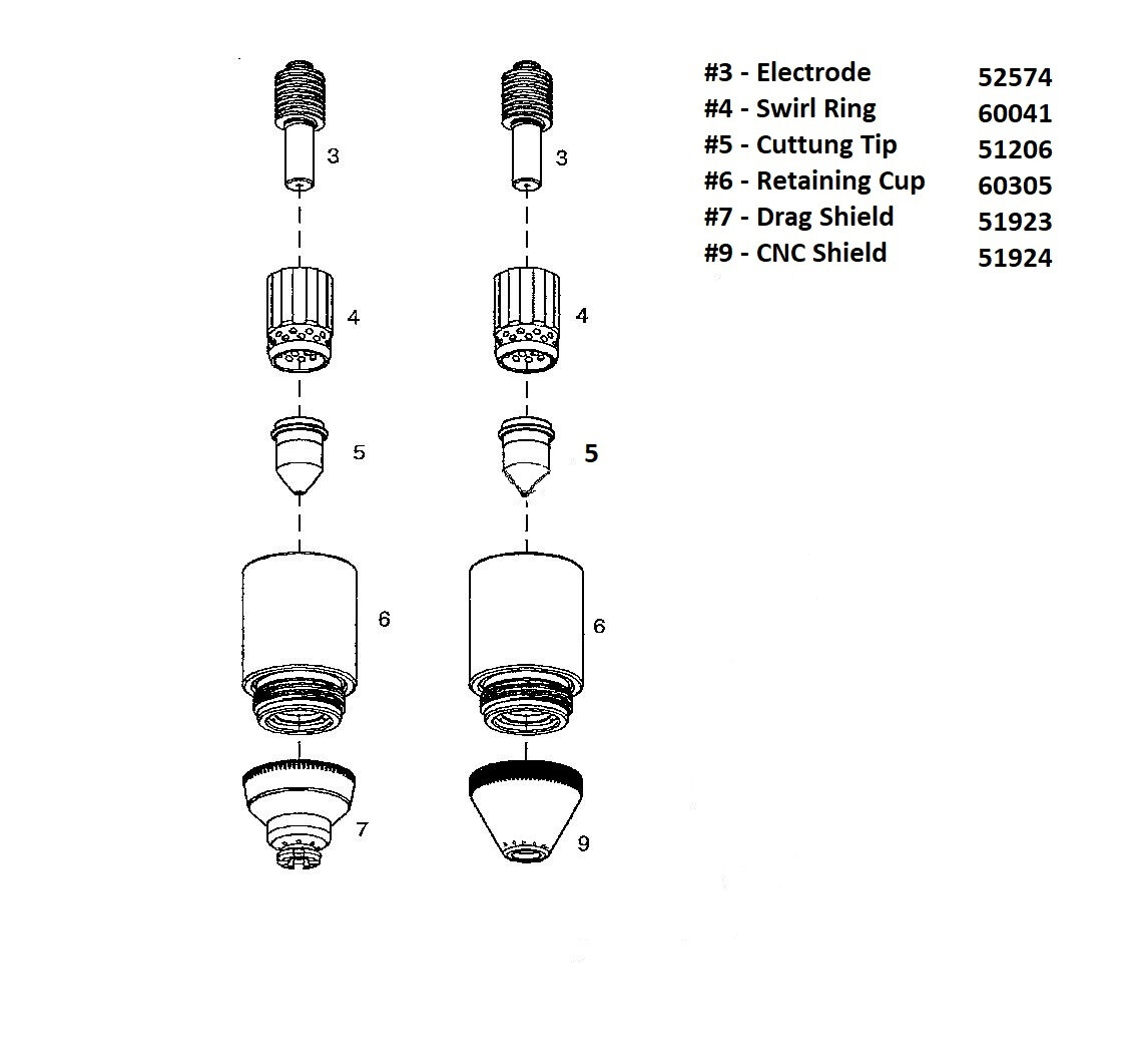

Here is a diagram of the consumables in your torch. Tips and electrodes need to be replaced the most often.
What amp rating does that nozzle have?Looks like your over amping it. 40 amp nozzle won’t last long at 50 amps and so on. Like 72pony said you must be at 75psi. 65 psi seems to low.
They are 45 amp tips and the one in the picture is totally wasted. So my guess is the electrode is bad also.
