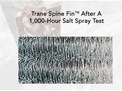

You haven’t seen my setup. Lol. I was going to do a write-up on it one day . But I took a 3-ton American standard trane air conditioner with the splinefin coil and converted it into an air cooler.
Is that a flat or round coil?
basically a bunch of hollow pipe cleaners
I’ll post a build someday I did take a bunch of pictures when i made the conversion. these pictures above are just off the internet
