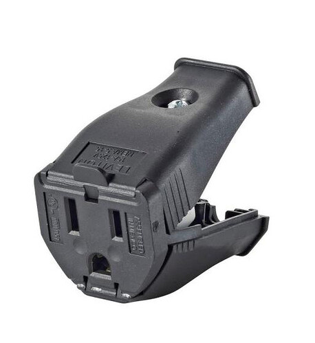

i wired in one of these to the compressor switch so i wouldn’t have to cut the male end.
Thanks for all the help, worked out great wiring directly to the pressure switch.
Just remember that if you tie into one leg of 220V circuit that you’re not going to trip the breaker if you get a short in the 120V adapter. This could cause a fire or electrocution. May also void or limit the $$$ your insurer will pay out if there’s an accident.
Safest way is to wire in the adapter to use both legs of the 220V circuit. (might be what you did… Just wanted to clarify for anyone else that was following along)

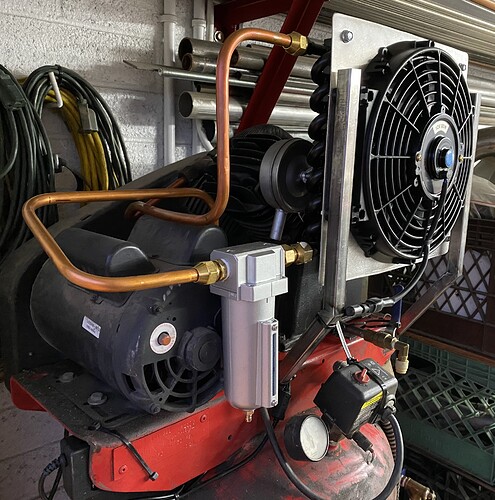

Here’s my solution based off the info on this thread! This isn’t exactly what I had planned, but fittings were difficult to procure, so I did some adaptation. I have not hooked up the fan yet but it already does an amazing job of cooling the air in between the input and output (250+ down to 85 degrees). I’m interested to see what that is once the fan is running!
I chopped off the AN fittings on the after cooler and ran some compression fittings directly on the pipe. I had a heck of a time finding AN to pipe conversions.
Looks clean, great job. I like the braided cable. I swear I tried to have EVCO fab something for me but I was told the only tubing that would handle 300 degrees was cost prohibitive. I have a feeling the guy didn’t really want to help me….
Were you not able to use the AN fittings I posted?
No but I should have used those fittings. I read somewhere that JIC fitting were compatible with AN, but that was not the case. After waiting for my JIC order to show up, which didn’t work, I was so impatient I just cut off the AN fittings and put on compressions fittings directly on the copper pipe of the Aftercooler, since I could get them at Home Depot.
