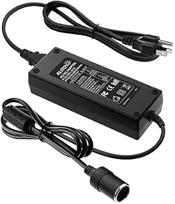

Can you share the information on the dc converter that you used?
Yep, a link to the amazon listing is in the top post.
Here is the one i used.
